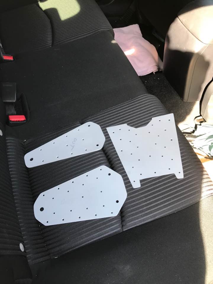

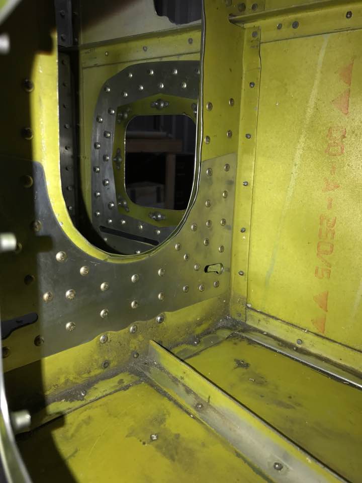

File comment: Found some cracks in the upper and lower flared flange. None went beyond the flange itself, but I'm betting they were caused by the lack of a bolster. I stopped drilled them and installed doublers.

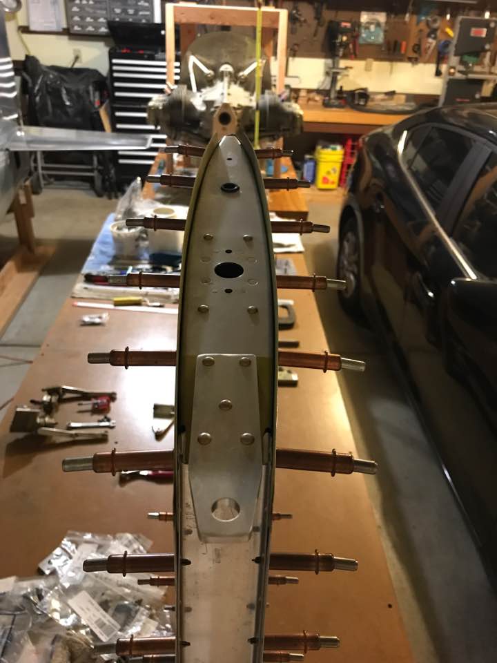

File comment: Test fit on the air frame.

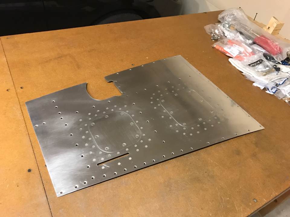

File comment: Made a new skin with access panels.

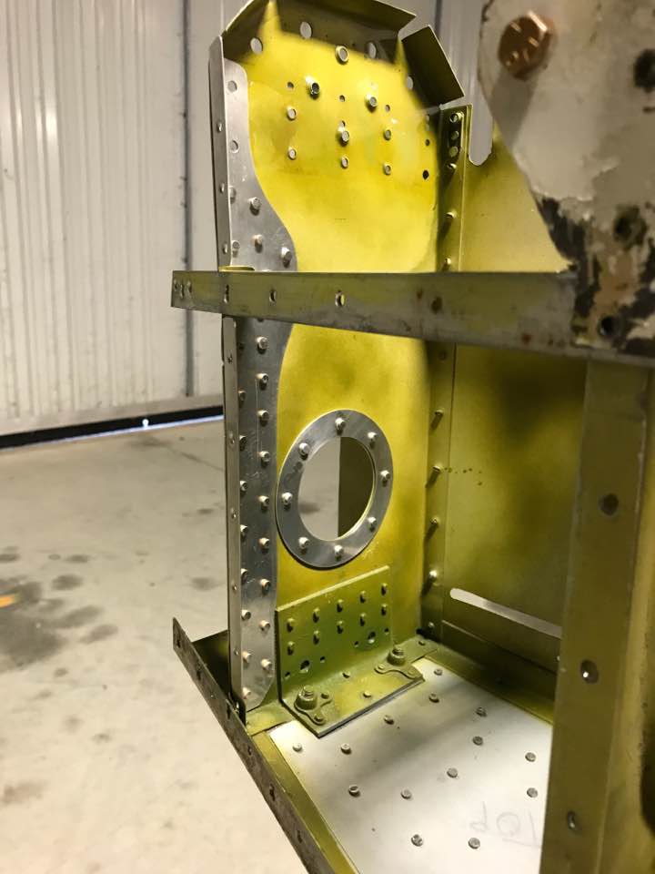

File comment: I cut the flange off and made repairs.

File comment: Customized the bolster support. The stock part would not fit, and I wanted to distribute the load a little more evenly between the BHs.
