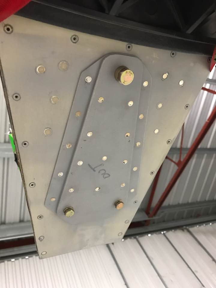

File comment: Found some cracks in the upper and lower flared flange. None went beyond the flange itself, but I'm betting they were caused by the lack of a bolster. I stopped drilled them and installed doublers.

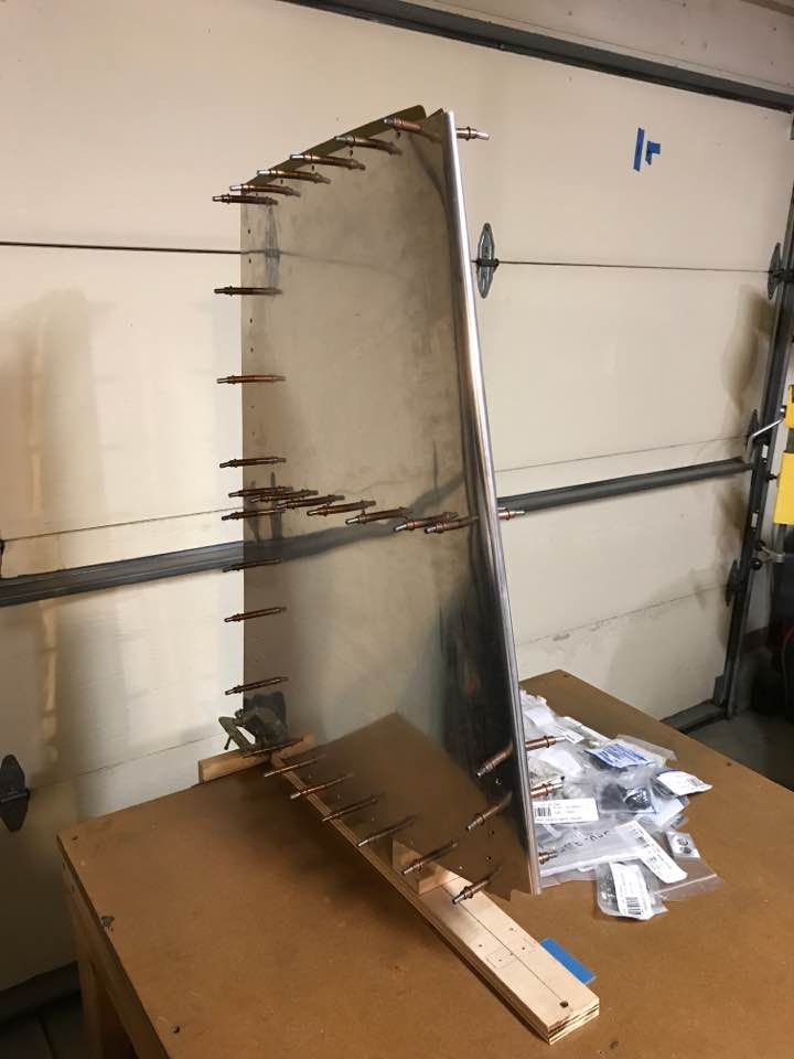

File comment: Made a new vertical fin with a fitting for a NAV antenna.

File comment: Customized the bolster support. The stock part would not fit, and I wanted to distribute the load a little more evenly between the BHs.

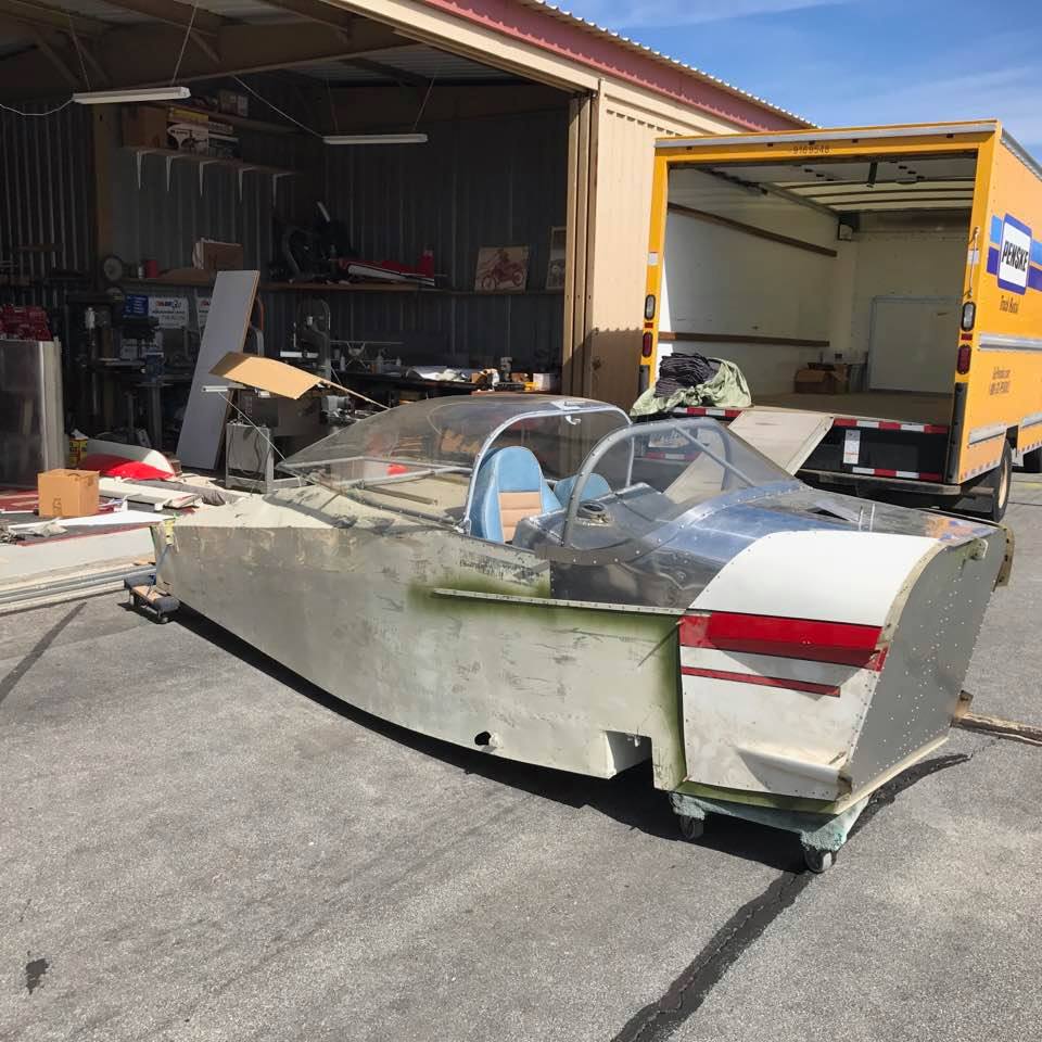

File comment: Back in Ohio

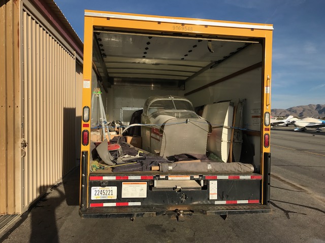

File comment: Loading up the truck
