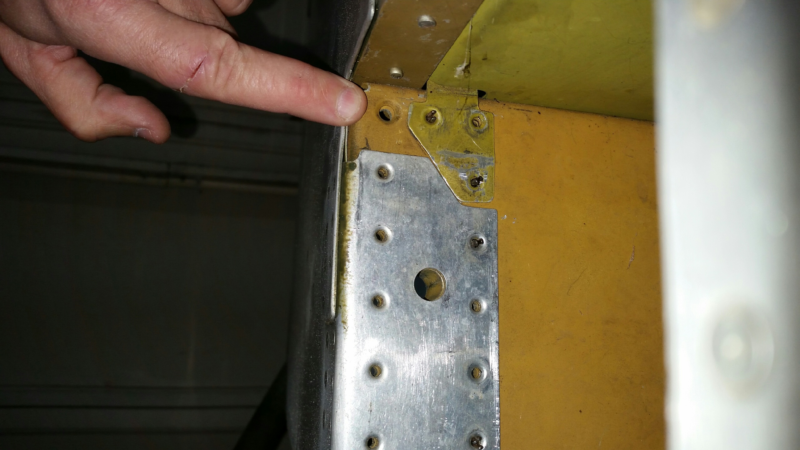

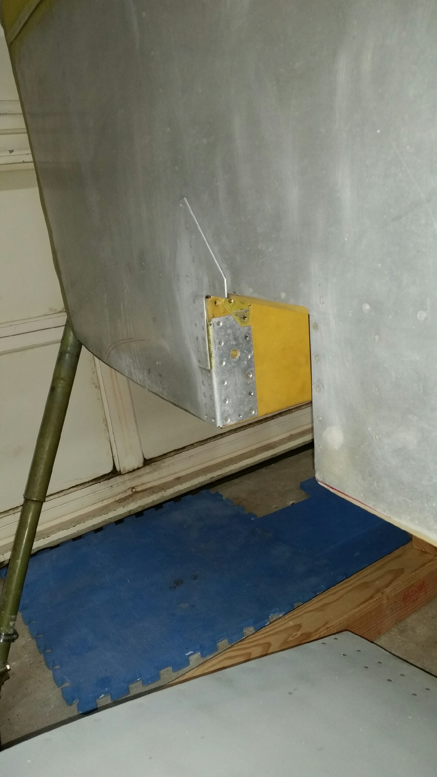

I am trying to install the 602 Fittings that attaches to the fuselage at the 601 bulkhead (where the front main wings attach to the fuselage). The plans call for a NAS 177-6-5 Hi-Shear Rivet with a NAS 179-6 Collar to be installed in the top corner. Is there a suitable substitute everyone has been using here in place of the hi-shear rivet and collar? I have attached some pictures to (hopefully) make it clear what area I am discussing. In the second photo I am pointing to the rivet in question.
