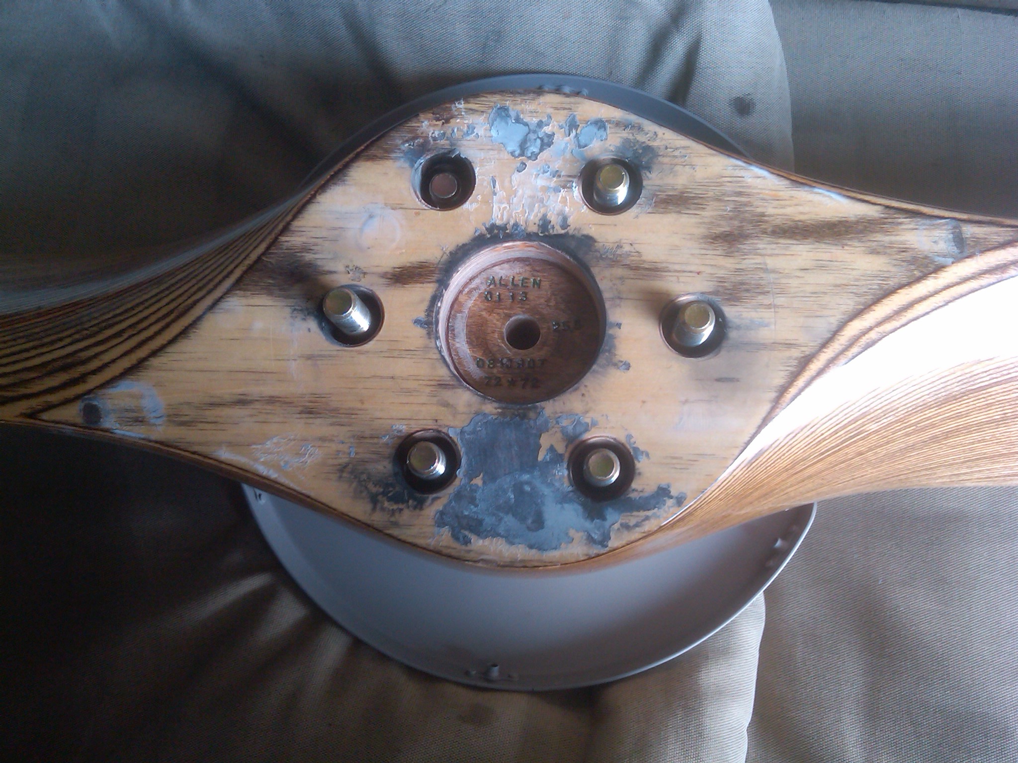

I have about 20 hours on my new engine/prop combo, including a new spinner with screws attaching both the rear and front spinner bulkheads. After my flight today, all the screws were missing from the front (smaller diameter) bulkhead/spinner. There was nothing different about this flight. I felt no new/different vibrations, and I used the same rpm/mixture setting. The flight consisted of a few touch and go's, a few stalls and then about an hour and a half of straight and level.
I am concerned because ALL the screws from the front bulkhead were gone. I would feel better if only one or two screws were missing after the flight, but not all of them. I plan to remove the spinner and recheck prop torque.
Do you guys have any idea what would have caused all the screws to back out of the spinner?

yes, I cant imagine all the screws backing out of those nutplates, but they sure did. There was no play in the spinner and it was a good tight fit. I have an 0-360 with a wood prop from Performance Propellers. I believe Dan has one of these props with the same length and pitch as me. I'll take a few pics and get them posted.

well, it appears the nutplates are my culprit. They all still have good threads in them, but they never grip the screw like a nutplate should. I can screw them all the way down with my fingers. The screws are correct for the nutplate. I called Frank at Performance Propellers, who advised he had not run a tap through them and was surprised by my information. Closer inspection revealed the nutplates on the larger spinner bulkhead were also the same way. I don't know why none of those screws hadn't loosened or come out.
Frank suggested I try and ever so slightly squeeze the nutplates to make them properly grip the screws. Would you guys agree with that course of action?

Rich, you are right, it is hard to believe. I have a bag of 10-32 and 8-32 screws from ACS. The 10 is too big and the 8 fits just right. Its just that the nut plates don't snug them down like they should. I think I'll buy some new nut plates, drill out the existing ones and replace them.
Dan, that's a good thought. I hadn't considered that. I Just better buy some new nut plates I guess. Its weird that all are this way, but I don't have any other explanation. Its either the screws or the nut plates.
