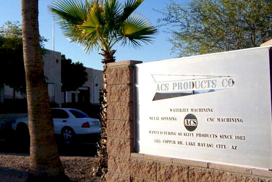

John: Is this the outfit ? (ACS)
??? They make an assortment of aviation products including the BN-1 spinner .

Yep... note that the president of the company is John Irwin. Does that last name ring a bell?

Yep I have talk with John Irwin once or twice on the phone at Corona . I did not notice his name at the Lake Havasu facility ? ???
