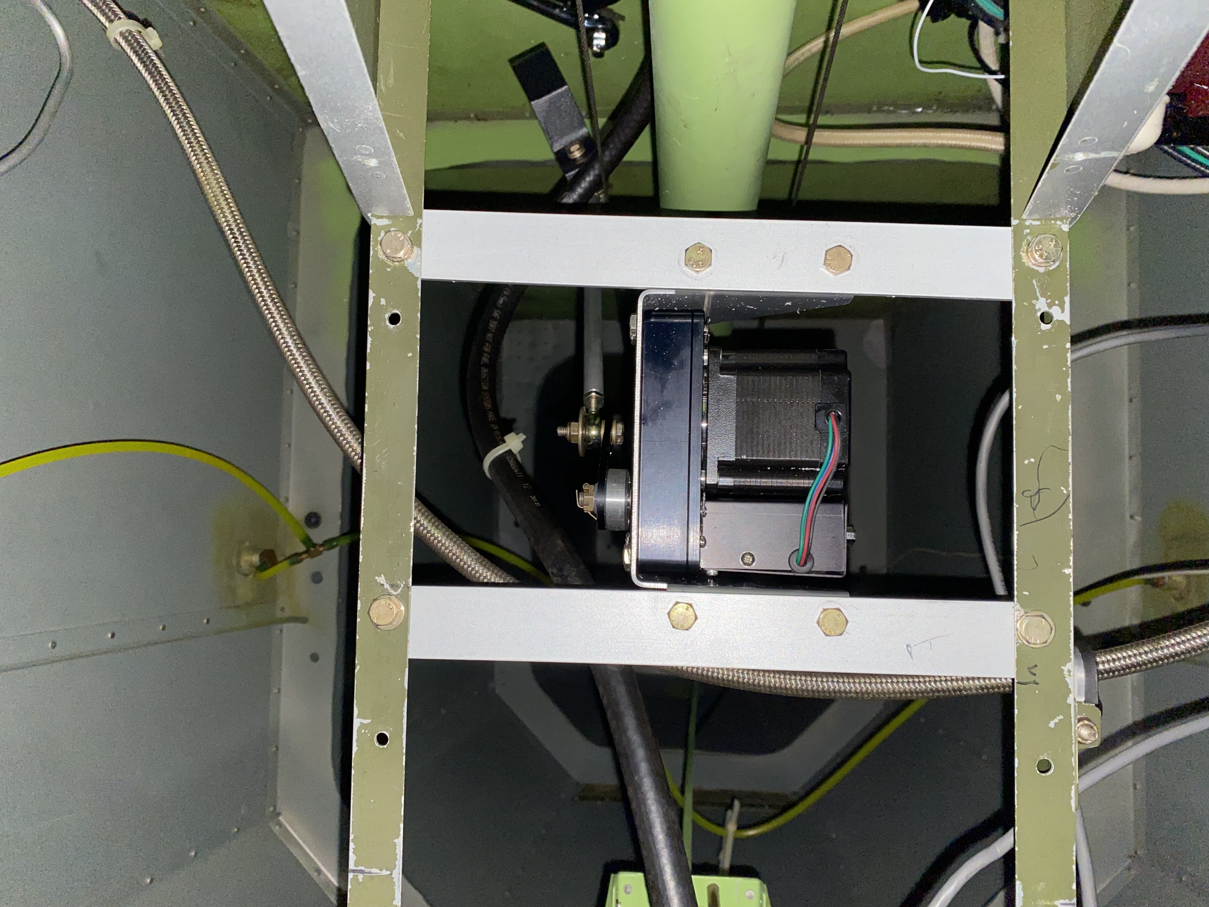

I took this pic for something else but it shows how I mounted my MGL avionics servo. That is a smoke oil pump beside it.
