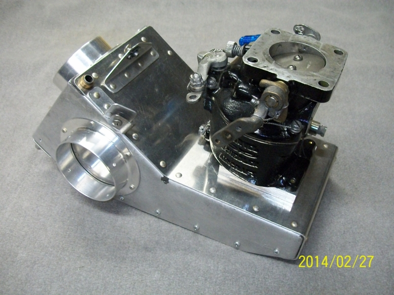

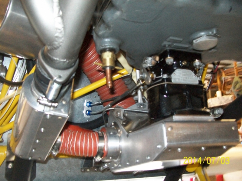

Those of you that have air intake from your rear baffle, could you post some photos of your setup. I would really like to pursue this installation. I assume you need a horizontal induction sump.
Also, are there any drawings regarding the cowling installation? I didn't find any in my set.
PostPosted: Tue Dec 29, 2020 10:26 am
Ryan, I did induction off the rear baffle with an updraft carb and large scat. Take a look in photo albums... Les
PostPosted: Tue Dec 29, 2020 12:45 pm
Looking in from the right side. Connects to the air filter with 3" scat.

That's what I needed, thank you both. Les, I'm posting your photos from your album here in this thread so I can come back and easily find yours and Bob's photos when its time.

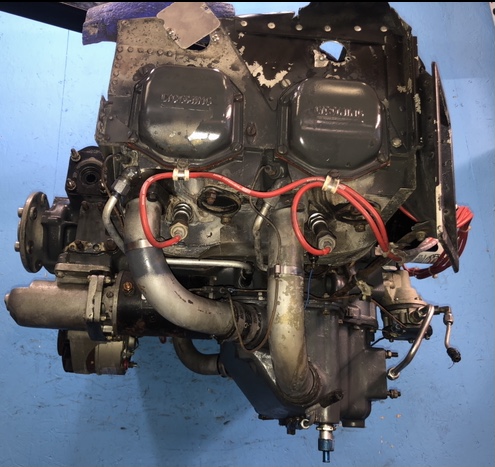

I have come across a Lycoming 0-361-F1A6 out of a Cessna 172RG that looks interesting for my T18. Does anyone know of a reason why this engine would not be a good fit inside a Thorp cowl? Any other issues with running this engine on a T18? I attached a pic of the sump. Thats the only area I could foresee interference with the bottom cowl.

You should be ok on the sump clearance as this is a horizontally inducted motor (so you can spare some clearance where the carb would be. Which brings up your biggest hurdle .. you'll need to alter the engine mount to accommodate the aft facing carb, which has been done but it is something that comes into play.
PostPosted: Thu Feb 18, 2021 5:04 pm
Posts: 1173
dang, I don't want to mess with that. Thank you very much for pointing that out.
PostPosted: Thu Feb 18, 2021 6:55 pm
The motor mount mod is not so daunting. You cut the bottom "X" out, then rebuild the "X" with a dip in it and gusset all joints.

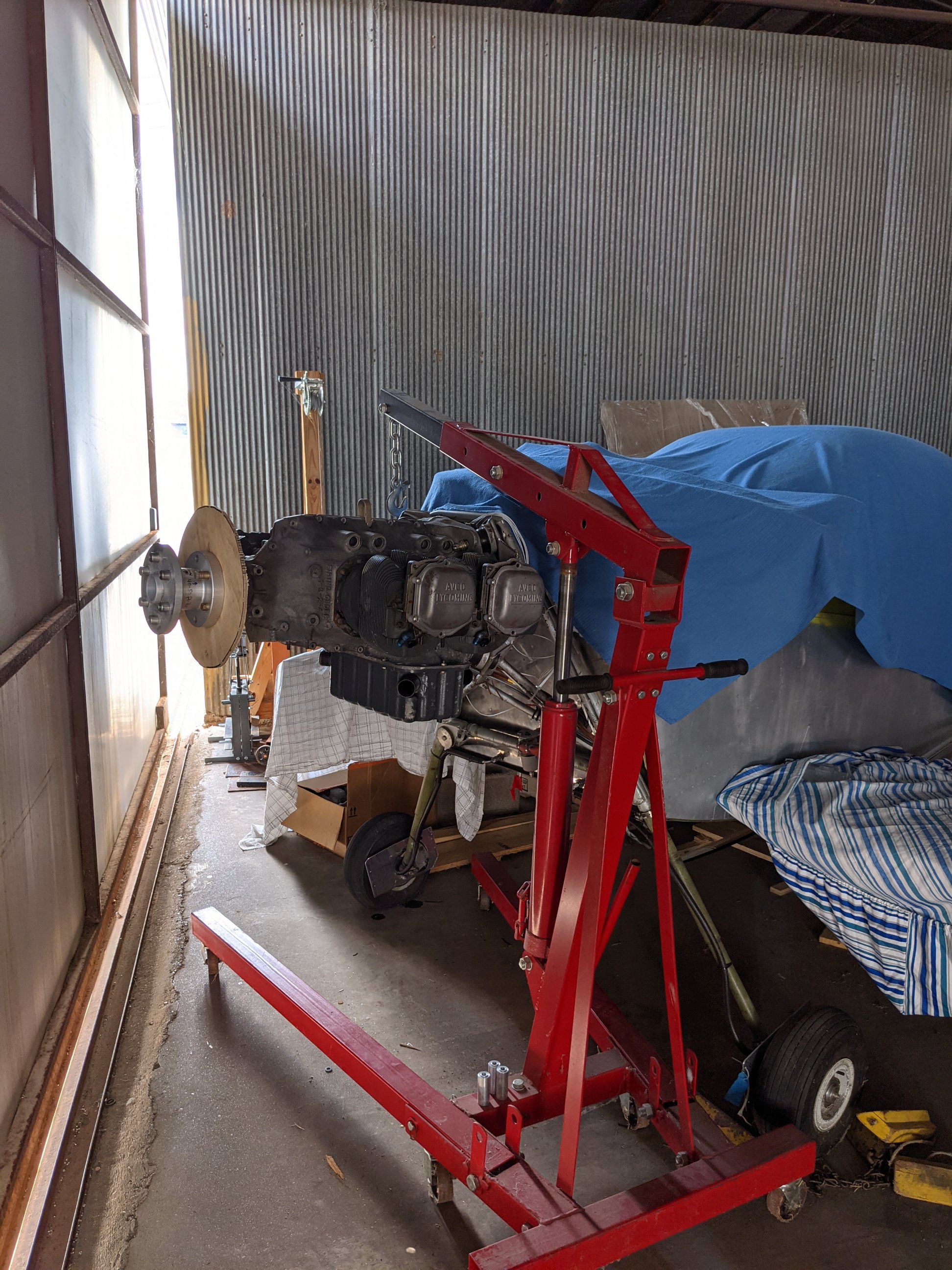

While I plan to buy an 0-360 for my project, I came across an 0-320 case that I plan to use in order to fit my cowling to the airframe. Can anyone confirm this case will work for fitting my cowl and spinner spacing? Also, does anyone have any old engine mounts they want to get rid of? I would buy them so I can hang this case and fit my cowl. Any input/insight about my plan would be appreciated.
PostPosted: Sat Oct 23, 2021 2:27 pm
Posts: 1173
Well, I finally got my junk engine hung today. It took me longer than I expected, but its done.....and man, are those engine mounts expensive or what! Now on to fitting the cowl.
