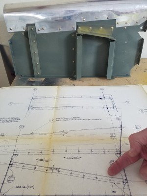

I am confused. Please look at the photo of the tunnel and tunnel plans. The plans show an angle where my finger is pointing. My tunnel does not have this angle (in the background of the photo). I cant find the drawing that shows the "seat supports" on my tunnel. I am beginning to believe the 505 tunnel drawing you see in my photo has been superseded with a newer edition. You comments are appreciated.

I believe the seat installation was revised at some point. My aircraft has the angle in question but not the drawings. I don't have the standard Thorp seat installation. My drawing -505 has some indications that the angle was removed, drawing -855, seat installation, has the rivet locations indicated but not the angle. The drawings that you need are -855 installation, 852, 853, 854, 856 and 857.
My installation has a T section supporting a Cessna seat rail for a 150 seat.
Not the best photos but I think you get the idea.

Dang Bruce, I love those seat rails. I often wondered if anyone had used those. Thanks for the tips.

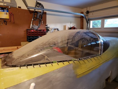

Thanks for the guidance on the rivnuts. I drilled my canopy last night. I haven't drilled the canopy to oversized holes yet, but everything went great last night. I was worried about cracking the canopy the whole time. Its my biggest mental hurdle of this whole project.
File comment: Canopy
PostPosted: Wed Jul 03, 2019 2:38 pm
Well Done!
