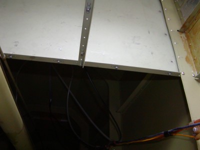

Here's a photo of my rear baggage bulkhead, the floor of the baggage compartment is level with the top of the tunnel. The rear bulkhead is mounted to an extra flange that is attached to the back side of the frame. Also note on the left side the support for the trim tube, it is a nylon "adel" clamp, there are similar ones on the right supporting the wiring and static system tubing.
Wish I had a better photo but this will have to do. :)
File comment: Camera position behind pilots seat low looking up toward the rear.
