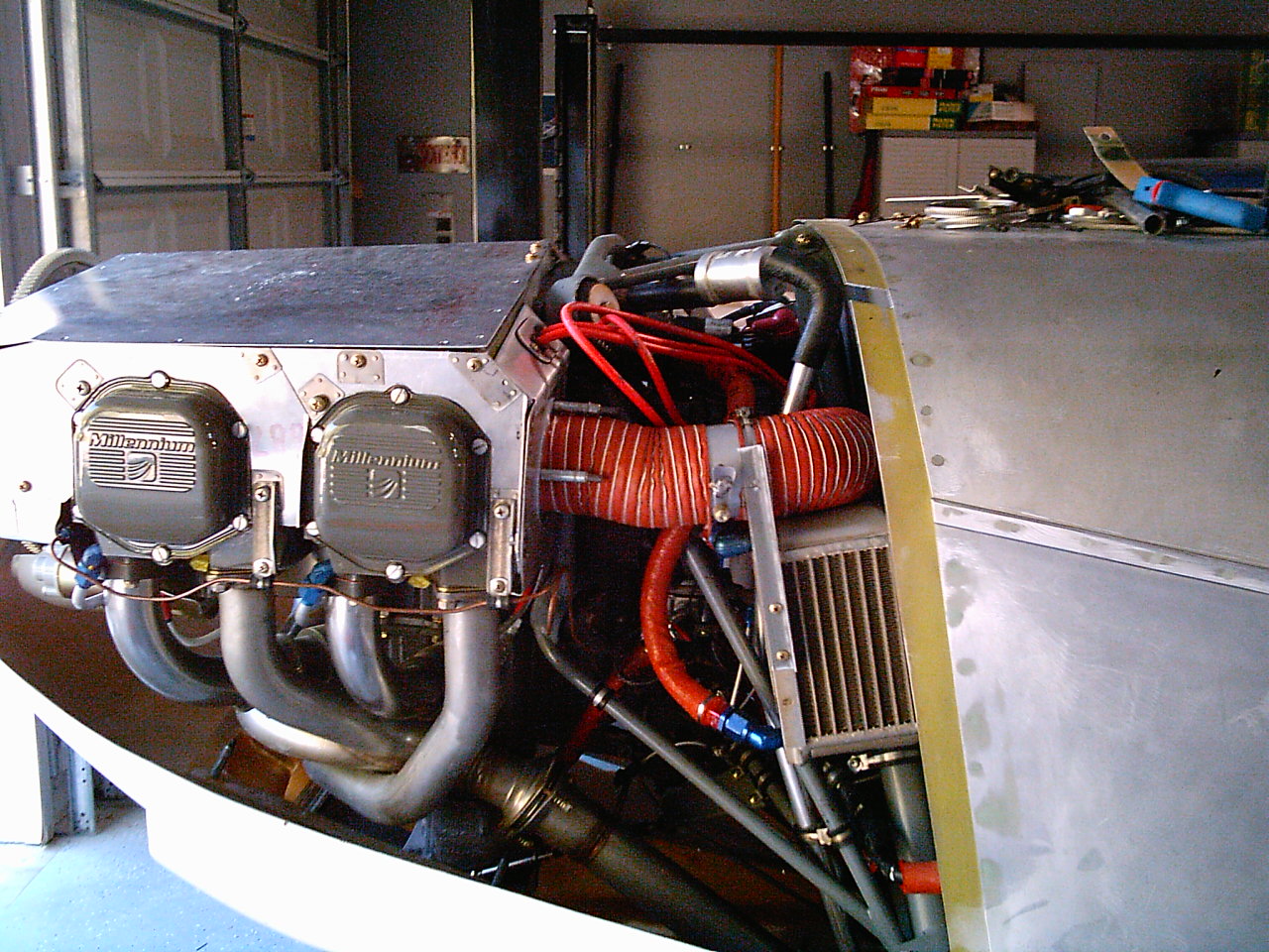

S18%20engine%20plenum%20and%20hinged%20cowl%20cheek%20005.jpg [ 355.34 KiB | Viewed 34616 times ]
I did something a little different...go figure ? Ran SCATT tube thru a shut off valve that allows me to control the air flow to the oil cooler from the cockpit via a push/pull control . No duct tape or removing/replacing gizmos . ::) I think I got the idea from a Vans site ? Instead of paying $75.00 for the valve made one from left overs for about $5.00 . Smoother than a new jar of Skippy...ZAZAM !
