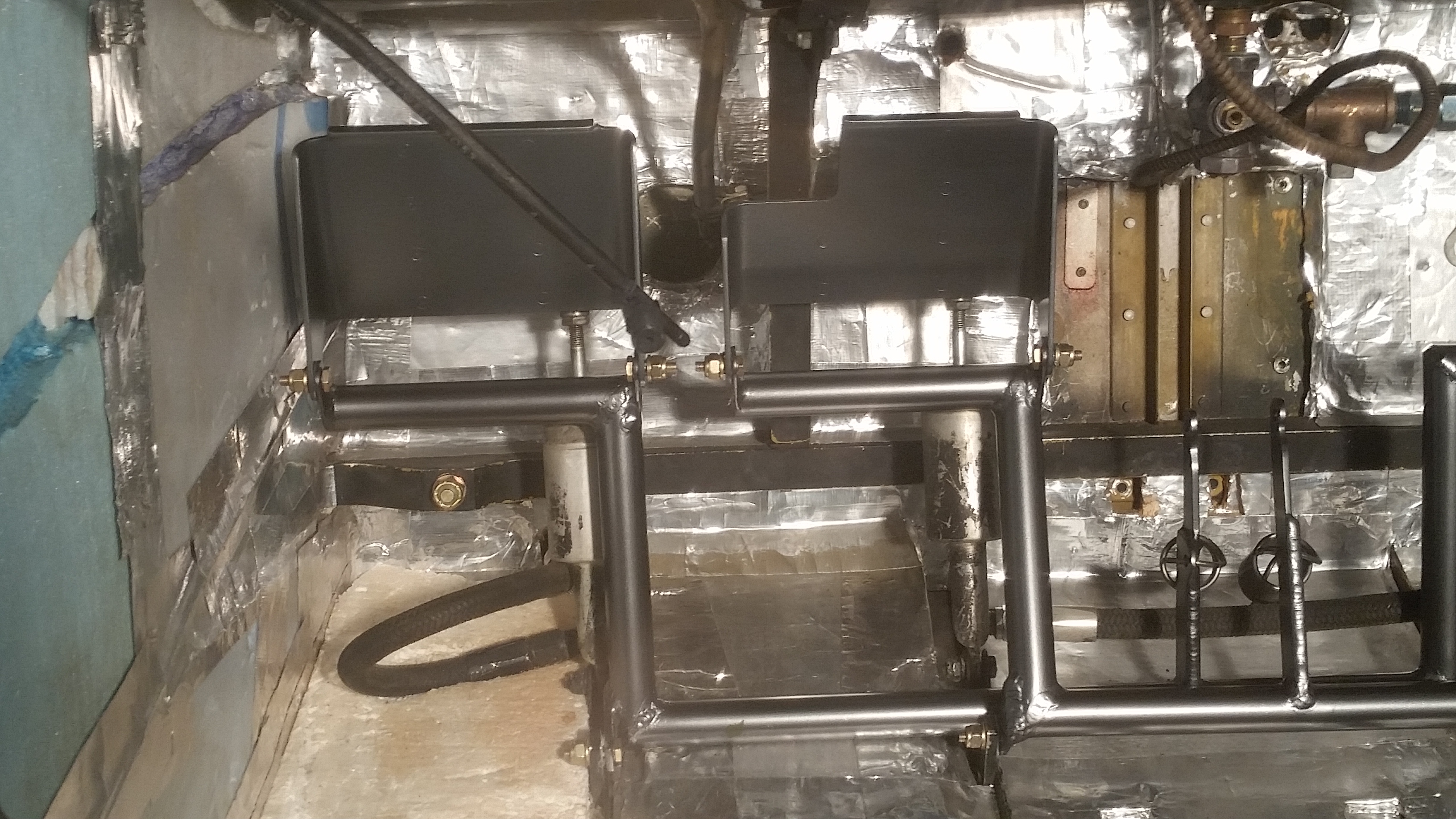

Hello all, I've been steadily working on N12055 and have a question. Does this tailwheel need replaced? See how it's narrower on one side?

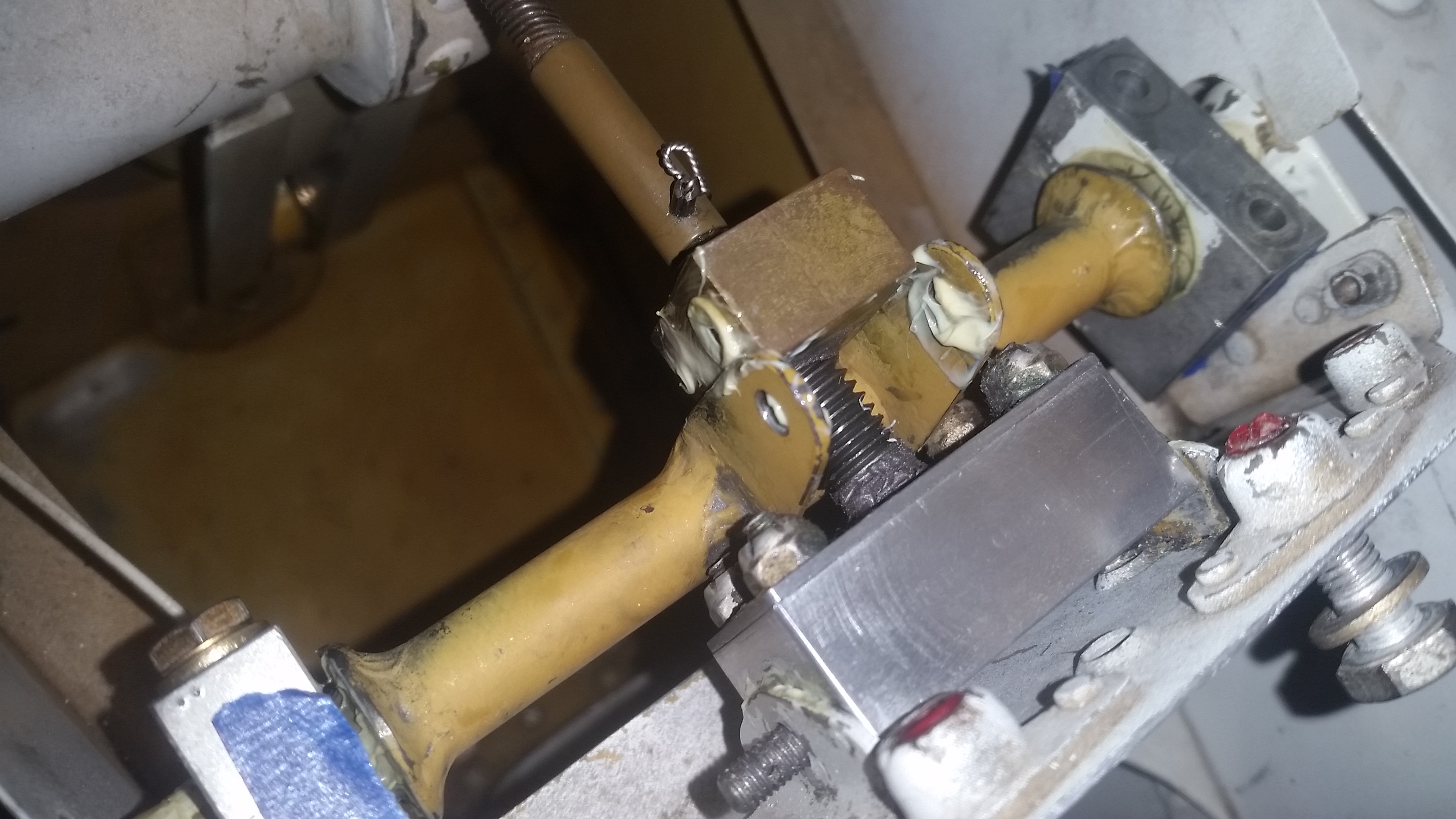

Here are some other pictures of putting the trim block back in now that the horizontal stabilizer is reinstalled. I have other pictures for the rudder pulleys inside the tunnel right behind the seats. Also, the newly painted rudder pedals are in.

File comment: Pulleys behind the seats (dirt not cleaned up yet)
File comment: All lubed up. Note that I had to remove the right aluminum mounting to get the center bearing block (the silver block with the gears attached) in there (nut not on bolt yet)

File comment: Rudder Pedals
PostPosted: Sun Nov 05, 2017 7:39 pm
I wouldn't worry about the tail wheel yet. Keep an eye on it. However, it shows uneven wear. That could very well mean that it is not bolted on vertical. Take a good look at that. I'd worry more about that than the condition of the wheel.
The trim block is non-standard. I've never seen one like that before. Not that it won't work. Just make sure it is secure. Also, once the nut is installed, make sure you can turn the jackscrew 5 1/2 turns stop to stop. Once everything is installed, get out the 521 drawing and align your trim system that way.
PostPosted: Mon Nov 06, 2017 6:07 am
Maule tailwheels do that. As Cubes said, keep an eye on it. The trim block looks like one I have. Ditto on 5 1/2 turns stop to stop and check travel per the drawing.

I apologize for not posting more, but I HAVE been busy on the plane, working every Saturday from 9am-6pm and Mondays from 6pm-2am. As I'm sure everyone will agree, it seems that as I make progress the road ahead stretches ever further. For those who are thinking of buying an older Thorp or any other older plane, I'll post here what I have learned so that I can help others a little for things to watch out for. (By the way - I absolutely love this airplane and am enjoying the epic journey).
FAA AC 43.13 states that if the outer clear coat of aviation wiring cracks when bent it needs replaced. Guess what - my wires in the engine compartment cracked when bent (the clear coat, not the outer insulation, ). So I've changed all of them to be in compliance.
Behind the instrument panel, one of the wires for nav lights came out of the non-aviation ring terminal attached to the switch with just a few ounces of tugging (by accident) - so now I'm replacing all wires and terminals too. None of the terminals back there are modern aviation terminals that grip the insulation as well as the conductor.
The electric trim would intermittently only work in one direction and I traced the problem to a loose solder joint on a pin of the trim switch. Could have been from me moving the center console to which it's mounted. But, that needs repaired and rewired now.
I charged the battery while it was connected to the aircraft's electrical system. Should not have been a problem because several of my buddies have their charger cables permanently mounted on the batteries with a plug at the other end to plug the charger into. After charging though, none of my nav or strobe lights worked and it took about 15 minutes of head scratching, a multi-meter, and a good friend to figure out why. Guess what - several circuit breakers had tripped but are so old THEY DIDN"T POP OUT! Everything worked fine when I manually reset them. Now I'm replacing all those old circuit breakers.
Another example was two weeks ago when I got to the point of opening the bulkhead behind the baggage compartment so me and some EAA buddies could see what was back there. (In case someone doesn't know, I bought this beautiful T-18 from a nice man at our EAA Chapter 45 airport.) In any event, when we looked back there we saw little black things on the bottom skin that we thought looked like rat crap. So, we did what any Thorp builder in his right mind would do - we sent a younger kid back there with a camera and a vacuum to see what these things were. After he extricated himself and we looked at the pictures and went through the vacuum bag, we found out that the rat crap was actually pieces of several grommets. What we surmised had happened was that probably somewhere in the '80s the aircraft underwent modification to change from manual flaps and trim to electric flaps and trim. Whoever was hired to do the work was a little too "expedient" and decided to "fit" the new trim and tail light wires into existing holes - and to do that they took out a section of each grommet to fit these wires. The wires themselves look awfully thin to me - maybe to make them easier to wiggle into the hole. As a result, the wires are against the metal of each hole. See the picture.
