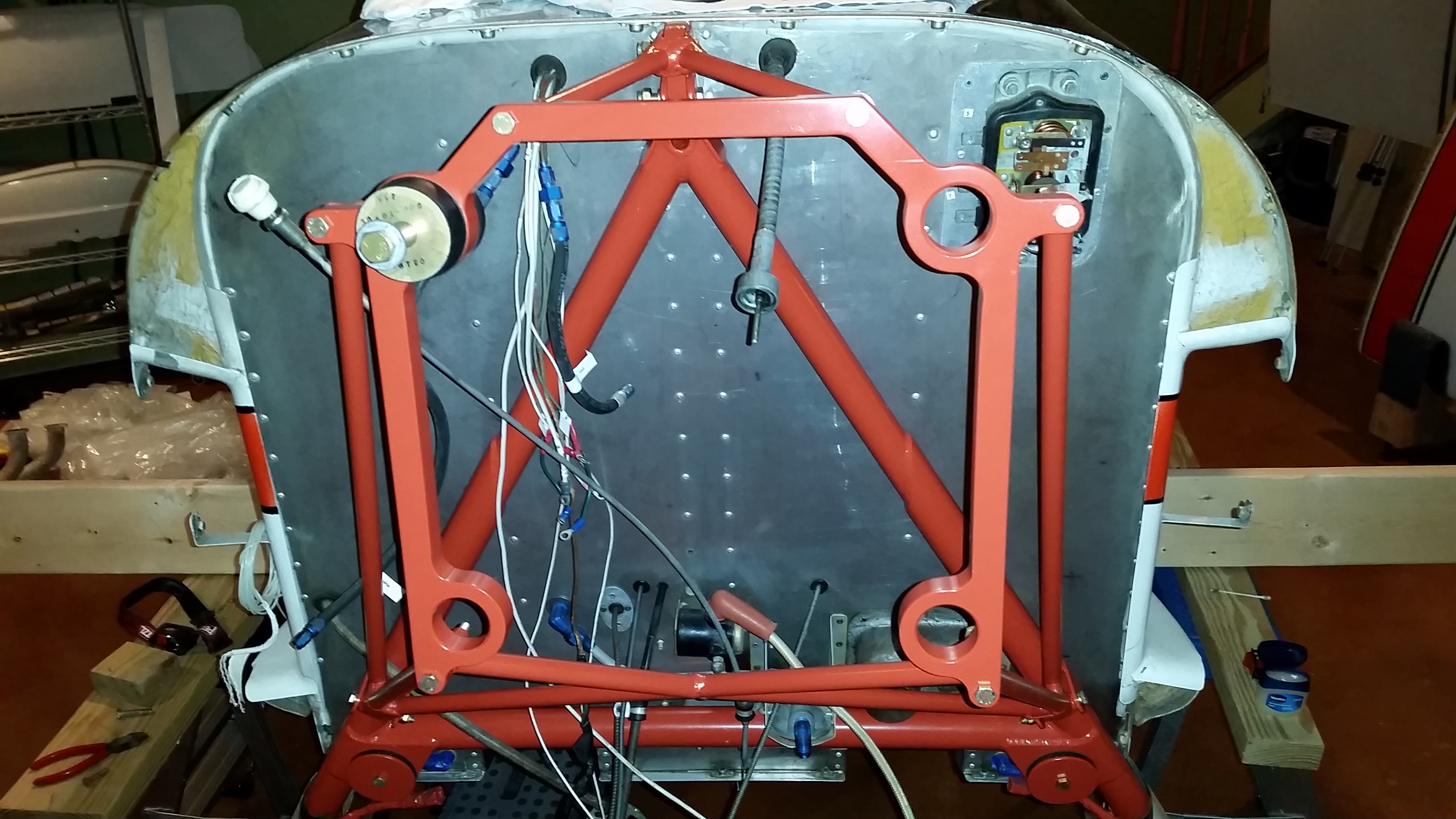

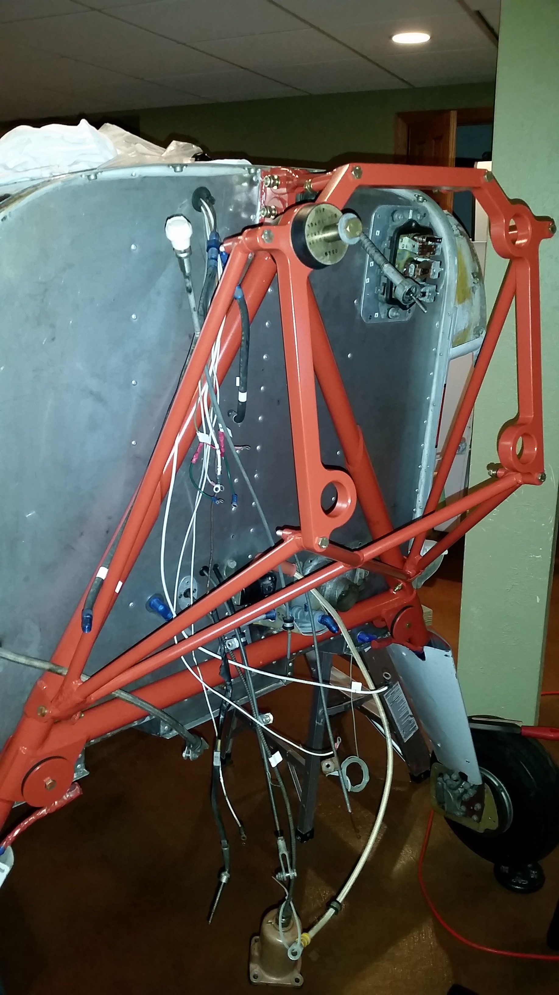

Had a great vacation in Anchorage with my son and his family - and our new granddaughter! Back home now and started to make some progress. Put the main gear back on today and added the engine mount after.

I've never hung a conical mounted engine, but on a dynafocal, it is much easier to hang the mount on the engine, then hang it on the gear. Might want to try that.
PostPosted: Wed Jul 19, 2017 8:53 am
I might try that, Cubes, if I run into trouble. My current plan is to put the ring mount on the engine first. I have to do that so that I don't have to loosen or remove either magneto. I found out when I took the engine off that the ring mount JUST clears the magnetos with a little trial and error. Hopefully the same is true putting it back on. Then, I'll mount the engine mount tubes on the fuselage. Finally, I'll mate the ring mount to the tubes with the 6 AN 4 bolts.

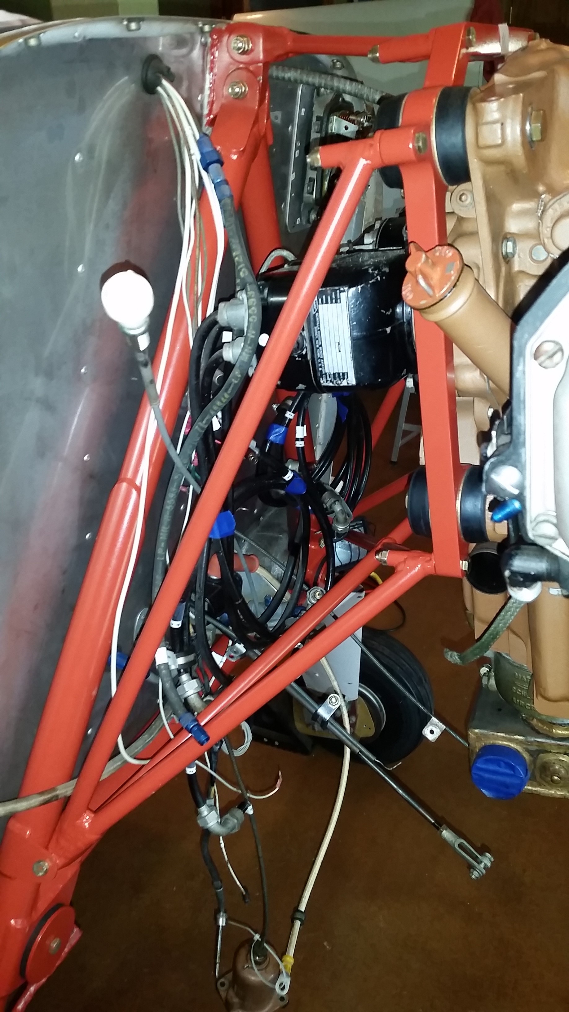

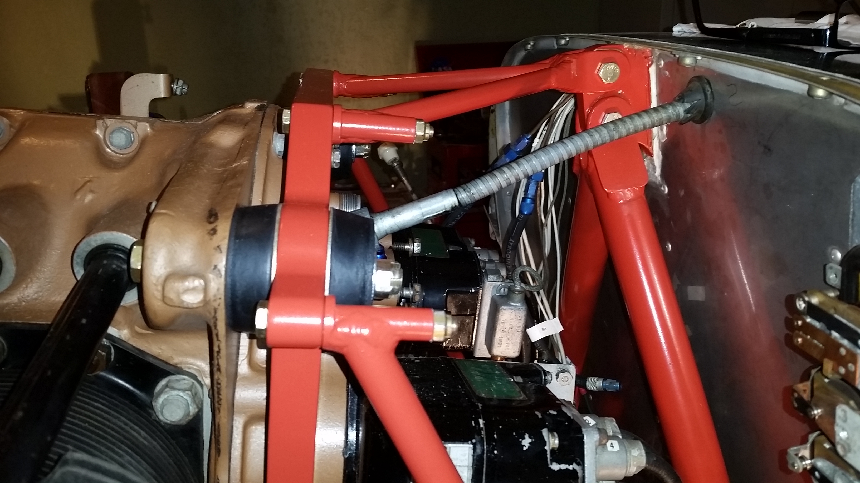

Got the engine hung yesterday and tried the cowling on for size. I have never seen N12055 with the cowling on. Pretty :P . Cubes - I listened to you and put the engine mount onto the engine first and then mounted the whole thing to the aircraft and it worked out very well without horsing around. Thanks! It was very good to see everyone at Oshkosh. Congrats, Les, for your award for a fine job!
