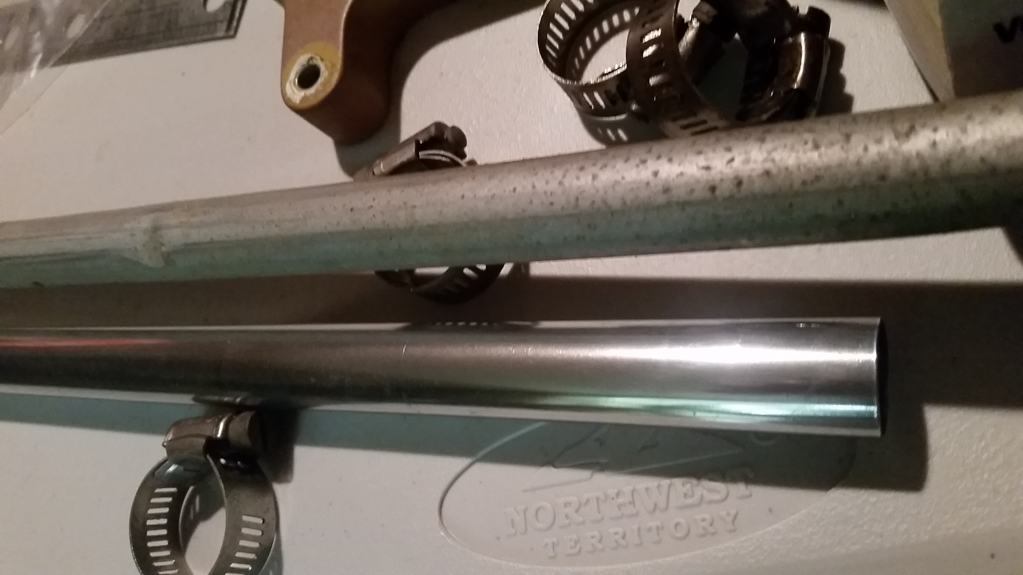

Some of the work done the week:

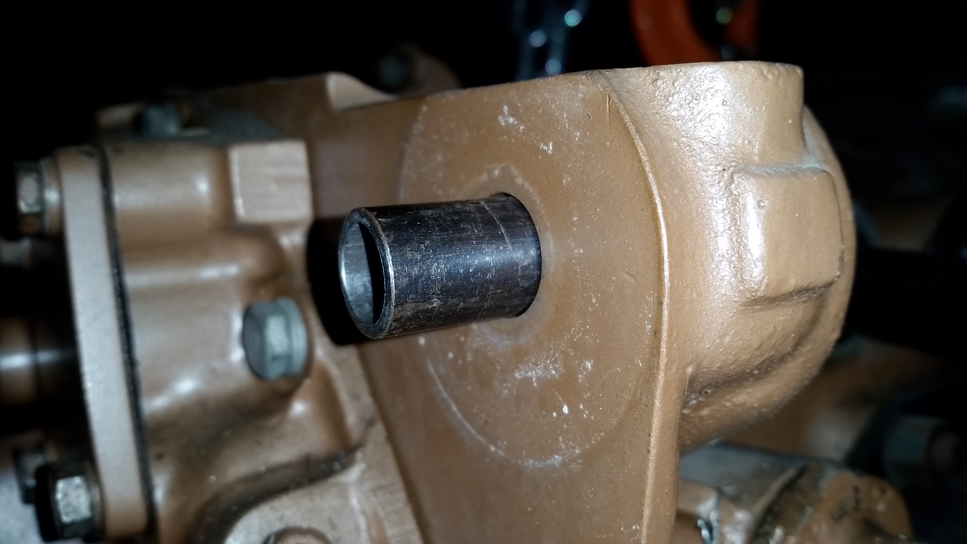

* Checked the condition of the steel inserts inside the O-290G (converted to an O-290D or D2) engine mounts and found zero rust on this 43-year old aircraft.

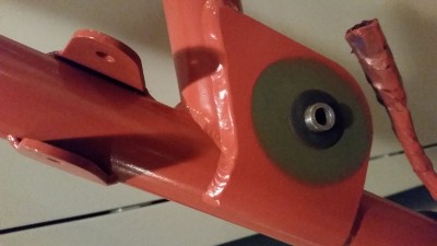

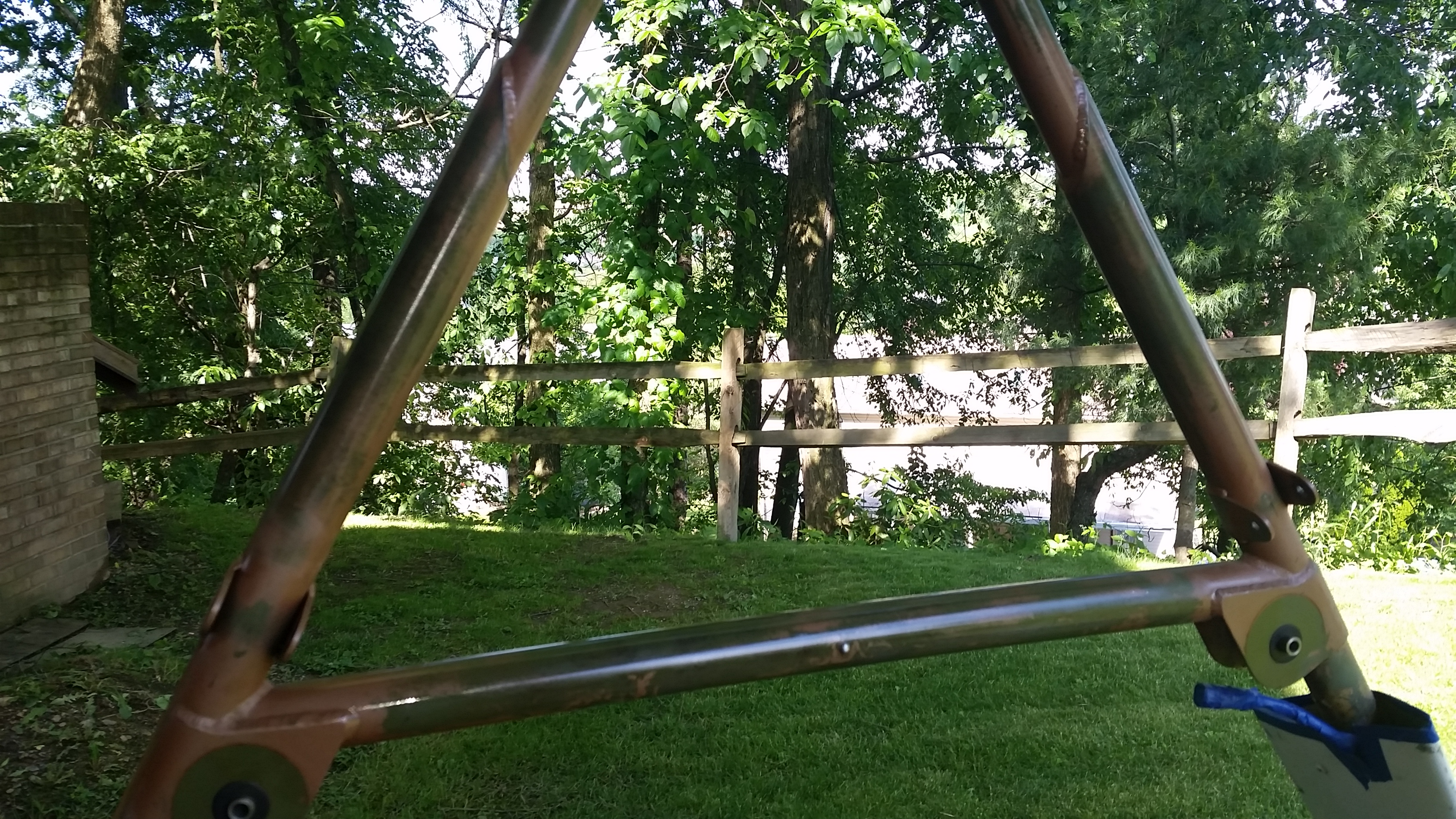

* On the main gear A-frame, I sanded the old brown paint off until I got down to primer

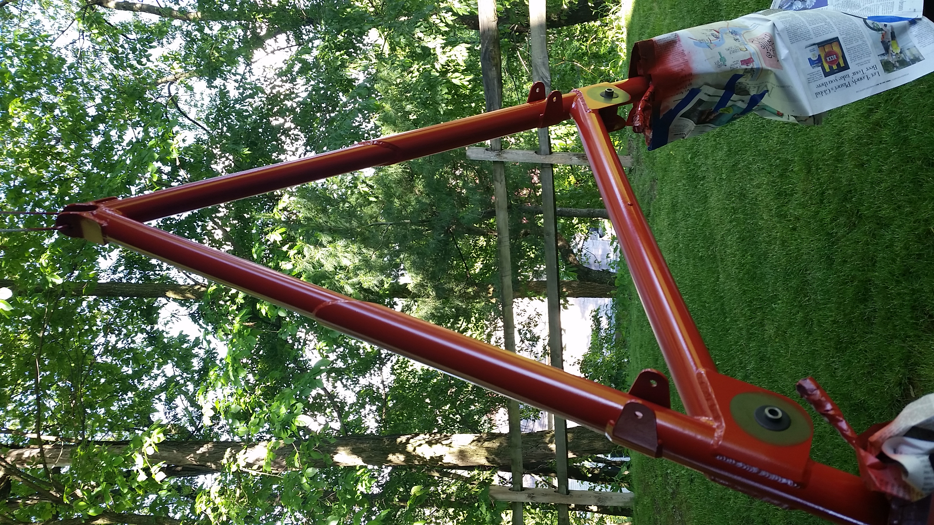

* I painted the A-frame orange/red to try to match N12055's color

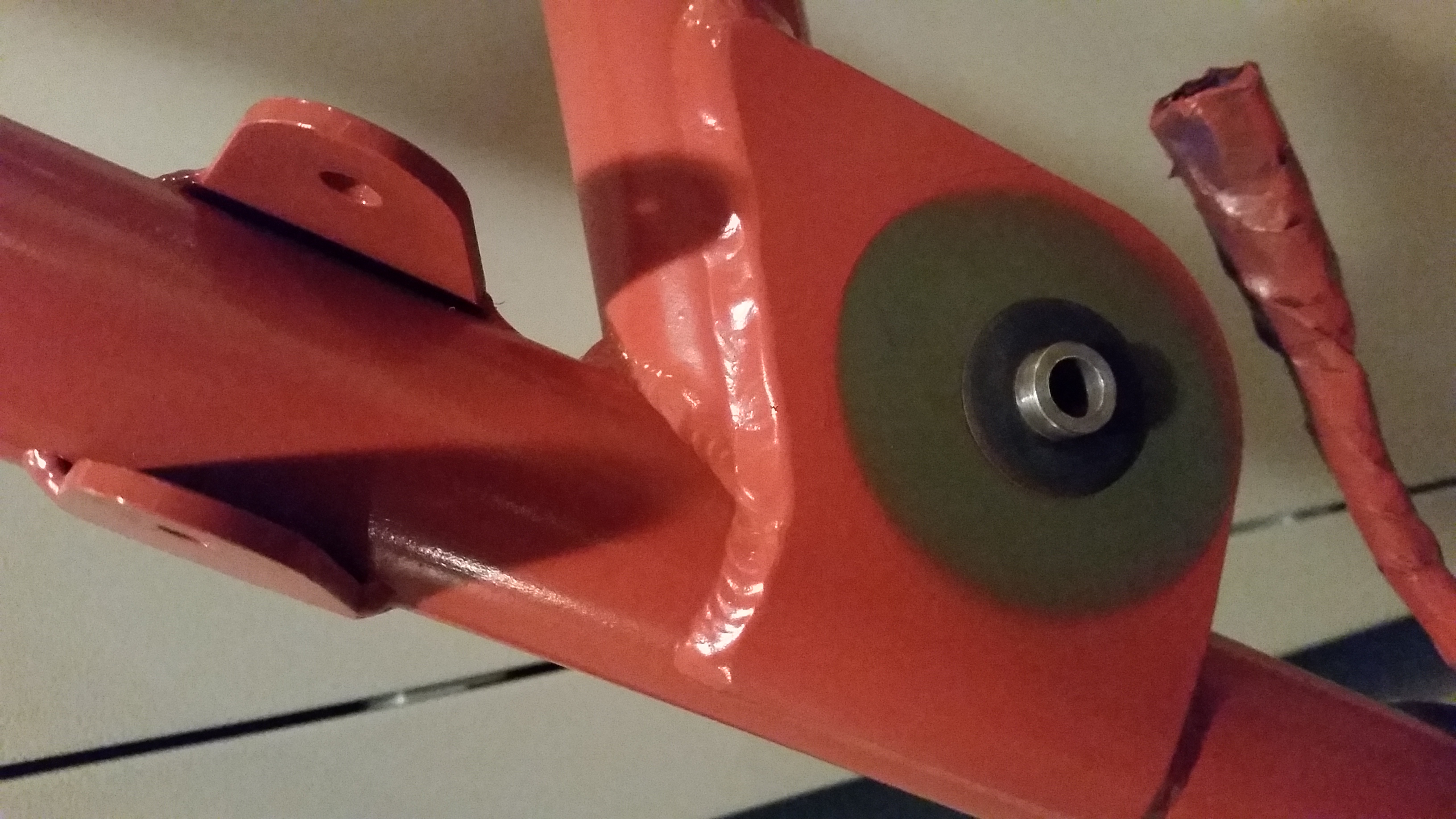

* I found zero rust on the A-frame's steel inserts at the lower gear attach points

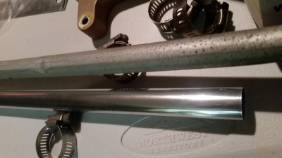

* I polished the oil breather tubes with Rolite aluminum polish with Amazing results.
File comment: Zero rust in O-290G steel inserts.
File comment: Sanding good enough to start painting
File comment: The painted A-frame
File comment: Zero rust in the main gear steel inserts - nice!
File comment: The finished tube looked just like the non-polished tube before I started.

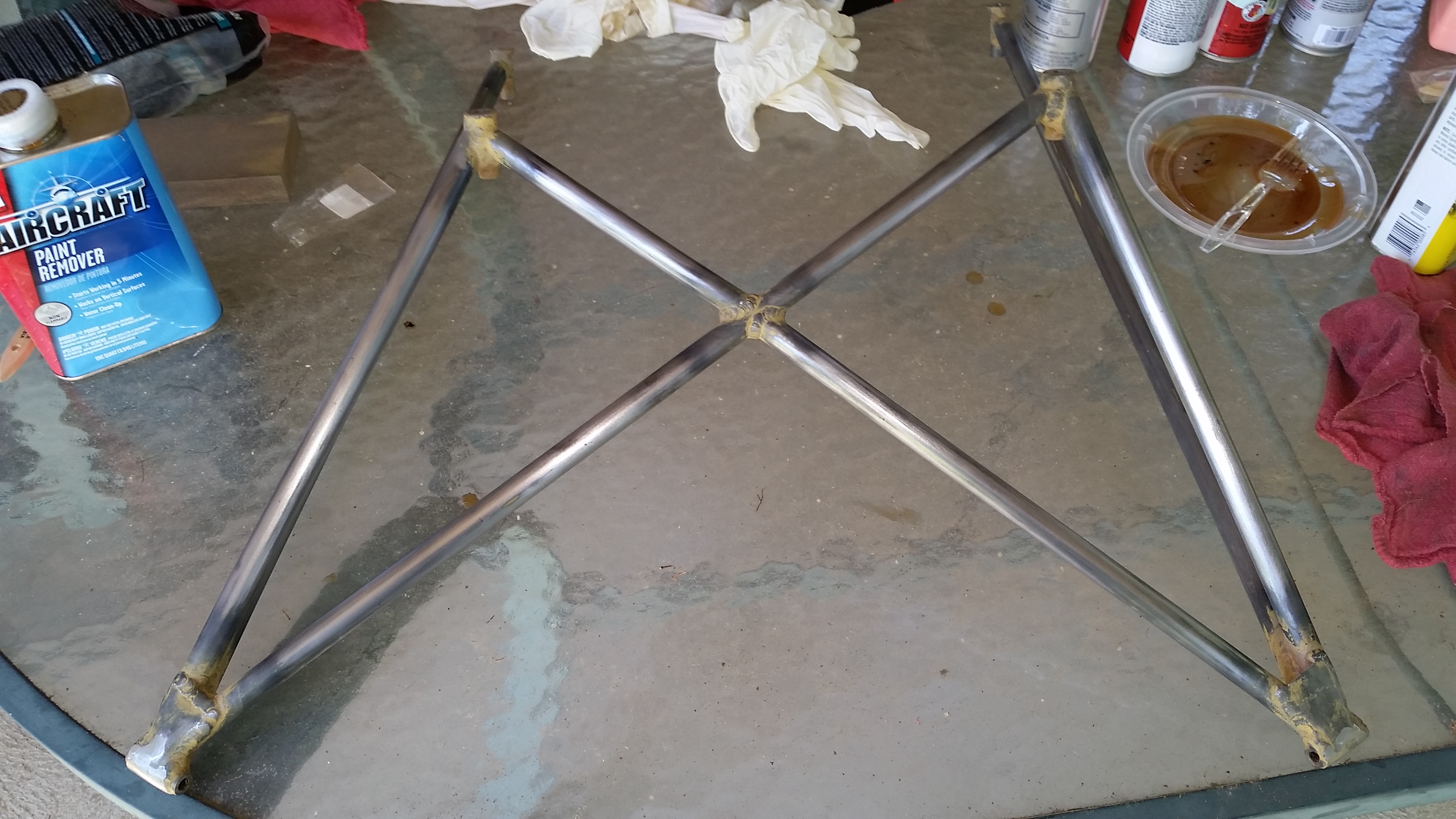

* Stripped, primed, and painted the engine mount tubes and ring

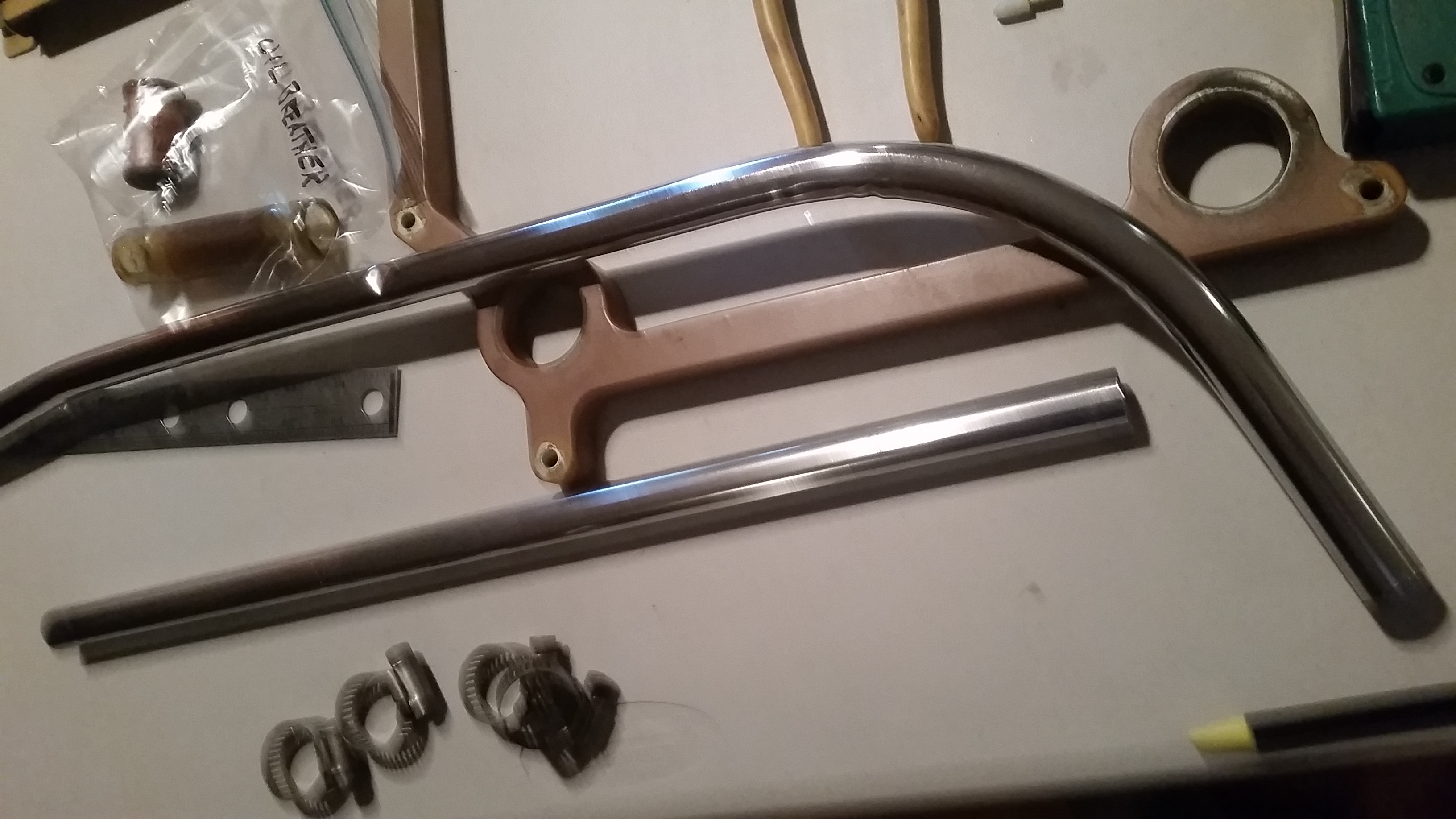

* Polished the other oil breather line with Rolite

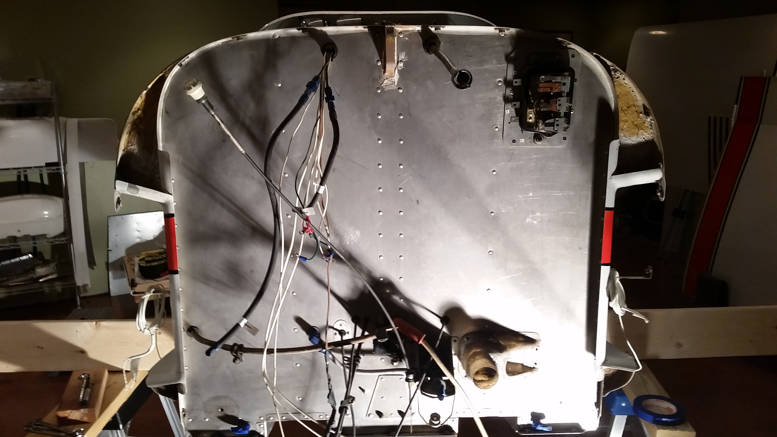

* Cleaned old paint overspray from the firewall and around the landing gear A-frame attachment points

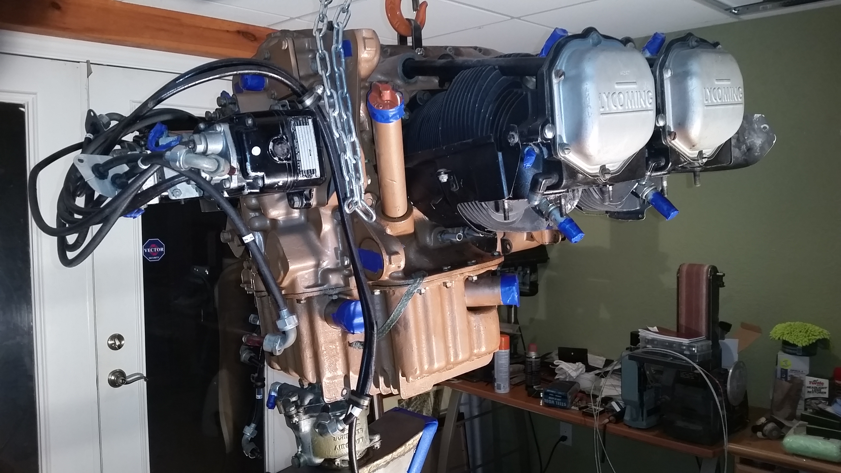

* Taped the engine in preparation for cleaning
Tomorrow (Sat), I'll be cleaning the engine. What started out as a small project to remove the engine to change the shock isolation mounts, of course became a larger project to remove and replace oil drain line rubber tubes and intake pipe rubber tubes, clamps, etc.
I'm starting to see some light in this tunnel. Got some great advice this week from forum members about torque values for engine mount and A-frame bolts. (Shock mount bolts are not torqued-just snugged as I was reminded). I have a big list still, but I think I can get N12055 out to the airport right after Oshkosh and have it ready for its condition inspection.
File comment: The second oil breather tube amazingly restored with Rolite polish
File comment: Stripped the engine mount parts and checked their welds visually

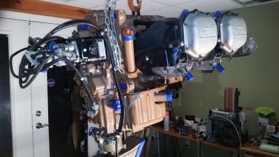

File comment: Engine and painted parts are hanging from the ceiling
File comment: The firewall needed just a little cleaning to look great after 43 years.
File comment: Engine almost ready for cleaning tomorrow
