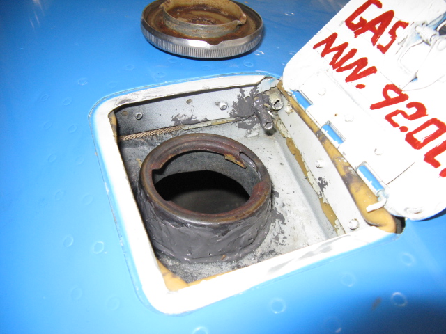

I replaced my PA-23 cap on the fuselage tank with a filler neck flange and cap salvaged from an old Jeep gas tank. It took a little reshaping but I was able to slide the flange over the existing filler neck. I was browsing http://www.tanksinc.com/index.cfm/page/ ... cat166.htm because none of the options on Aircraft Spruce appealed to me. They either didn't seem to fit without major surgery or were no different in practice than the one I was replacing. I think it took me about 30 minutes to "adjust" and install... took about an hour to get the flange off the old tank though (sweat soldered and spot welded).
 Post subject: Re: Fuel Tank Cap
PostPosted: Sat Feb 25, 2017 11:53 am
Here is a picture of the installed flange. I used a screw along with sealant inside and out to secure it in place.
