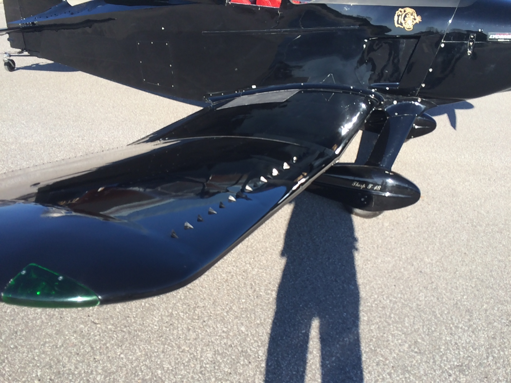

PostPosted: Mon May 02, 2016 7:59 pm
Here are better pictures of the VG's.

Thanks Jim, also your ship looks great. I'm going to try the VG on my tail.
