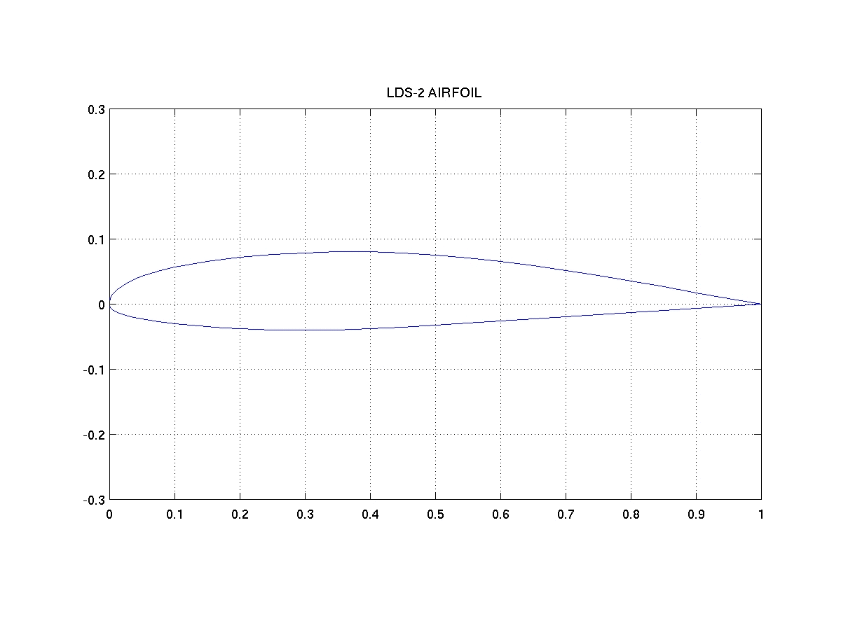

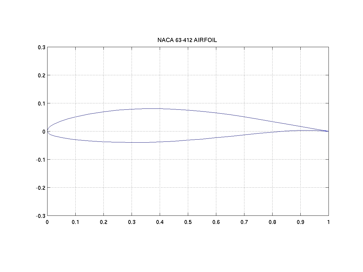

Hmm...the T-18L designation is not my invention but from the T18.net site. My understanding is that the T-18L is a stock T-18 wing but built from scratch using the slightly more rounded Sunderland LDS-2 airfoil profile instead of the stock NACA-63-412, already tweaked by Thorp to eliminate the cusp in the rear section. It sounds like you are talking about adapting the S-18 wing to the T-18 fuselage. which is something different. Here are images of the two airfoils. If someone has an image of the actual T-18 airfoil as modified by Thorp, that would be helpful.

Matthew, to get the T-18 airfoil, just take the drawing of the NACA 63-412 and draw a line starting at the trailing edge, going forward to a tangent to the NACA profile's lower surface, which comes at about 46% of chord. That's what Thorp did (drawing 547).
If you're using Xfoil, just take the NACA coordinates and delete the lower surface ones from 50% aft to the trailing edge; Xfoil's spline will fill in the details close enough. You'll find the profile is the same as the LDS-2 aft of the spar. Here are the coordinates:

You can plot these using AirfoilTools.com, where you will also find the LDS-2 coordinates already copied from the UIUC database, ready to plot there.
Xfoil shows the LDS airfoil to be an improvement to the original, and it should give a somewhat higher maximum lift coefficient. The larger leading edge radius should also be (slightly) more tolerant of flaws, less likely to trip to turbulent as soon.
