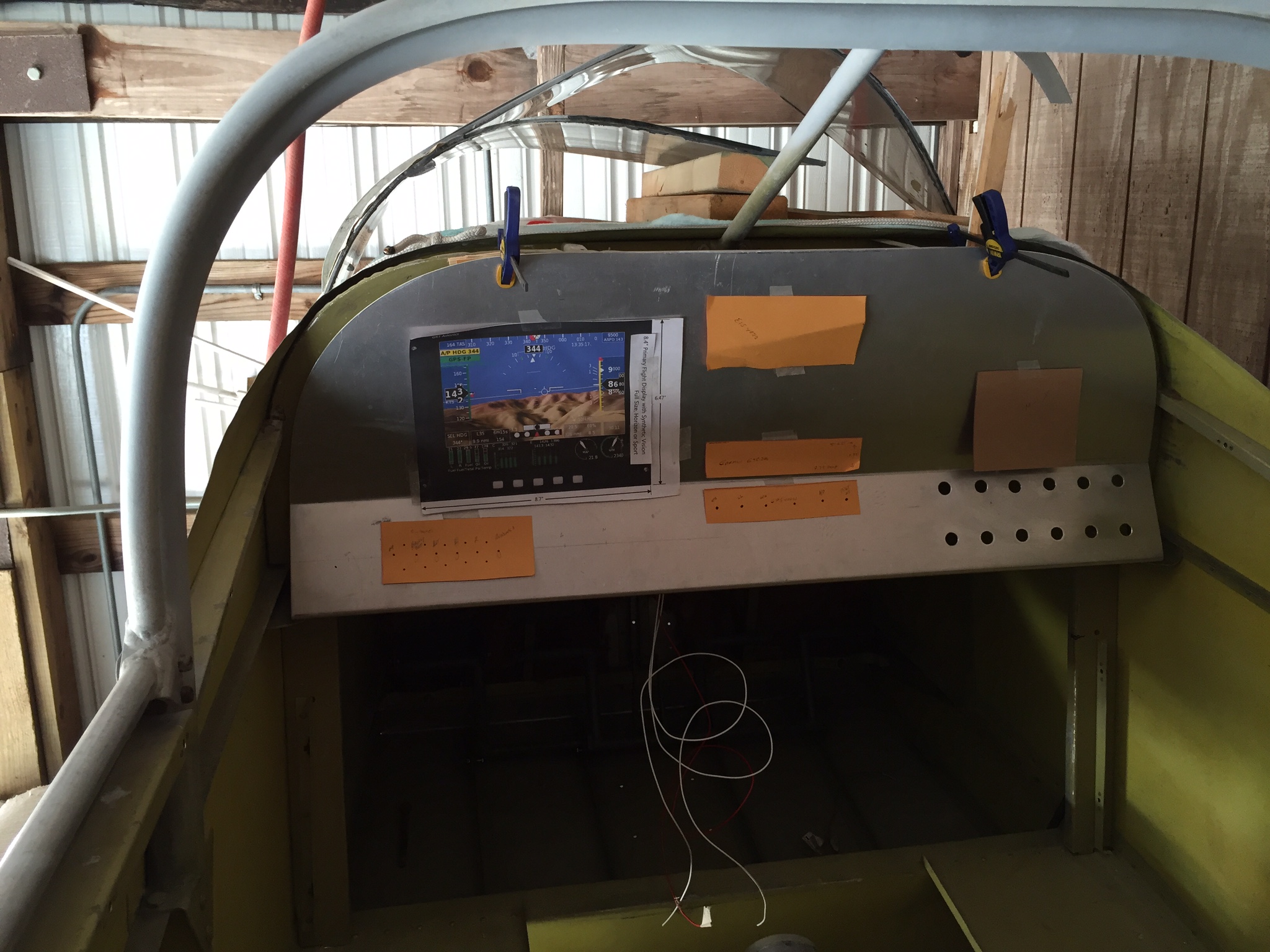

Today was spent on panel switch layout while making sure the throttle quadrant will remain clear

PostPosted: Wed Jan 06, 2016 10:27 pm
Remember, key goes in the middle with side quadrant.
PostPosted: Wed Jan 06, 2016 10:38 pm
Keys? Real Pilots don't need Keys....they just forget to take them out their pockets until they have strapped in. I'm going with individual switches for Master, L Mag, R Mag, Alt. etc...will have a push button for the starter. Maybe I'll placard it "ejection seat"....just for laughs.
