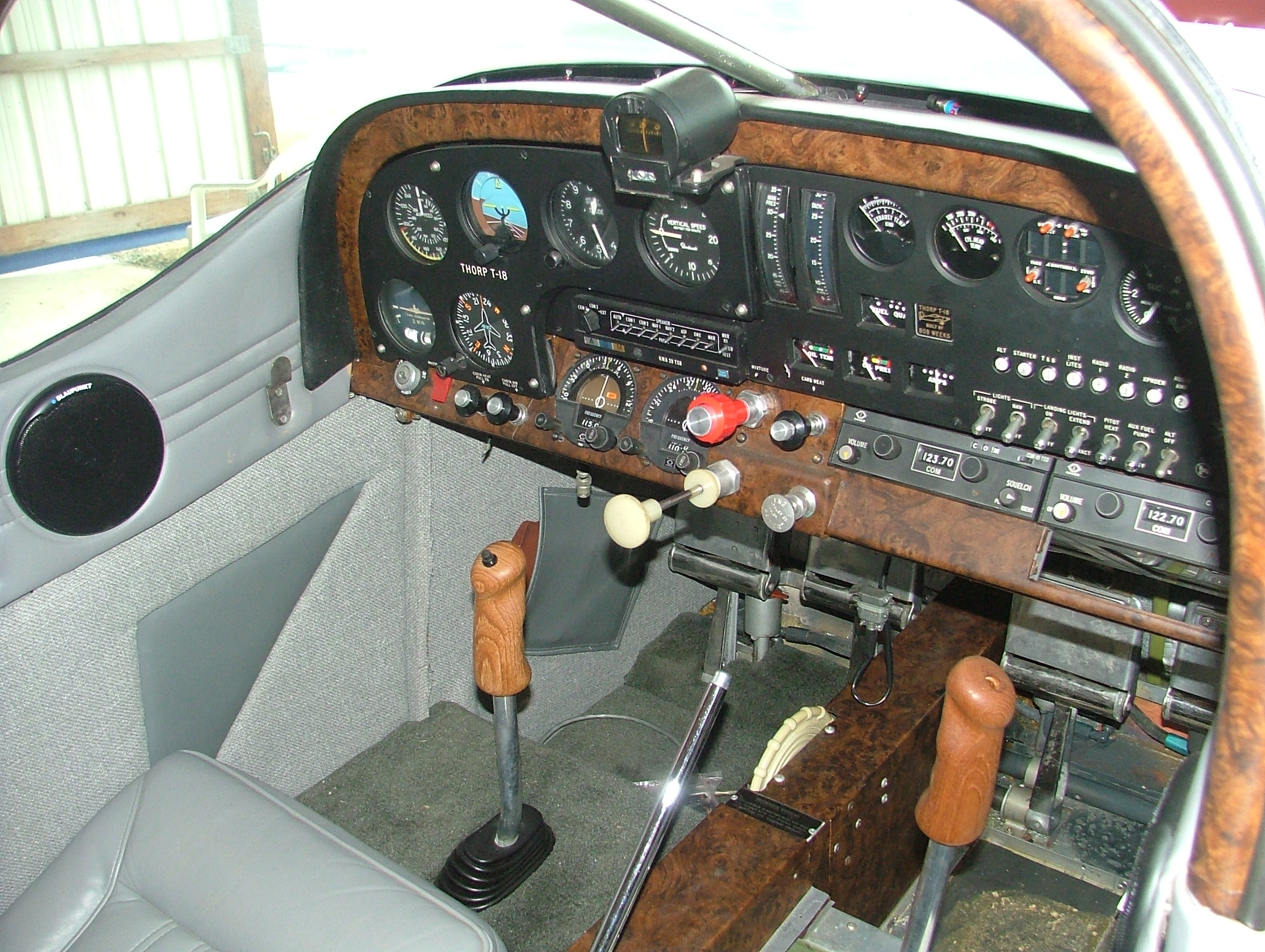

This is fun. My guess is 850#. I had an unpainted T-18 with an 0-290 with wood prop and a panel full of steam gauges and old heavy radios, Kentwood speakers, etc, etc. I also had a full interior with fabric covered side panels and a beautifully crafted panel. That plane weighed in at about 950#. Maybe with a bare interior and other attention to detail, my guess of 850# is feasible. I also have wing tanks. Not sure how much weight that adds to my plane....
Here is a pic of the old panel.
