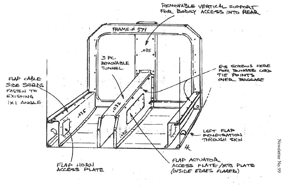

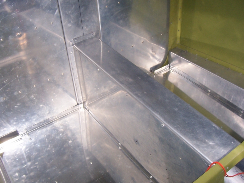

Here's a version of baggage compartment I posted in NL#99 (1996). Actually added a floor about 2" off of the fuselage bottom with short ribs between bulkheads for strength. The intention was for max volume for "baggy" things, although it does handle weight easily.
Les Krumel,
Albuquerque
File comment: Two floor supports for baggage each side, plus side guard over flap cable and center tunnel.
