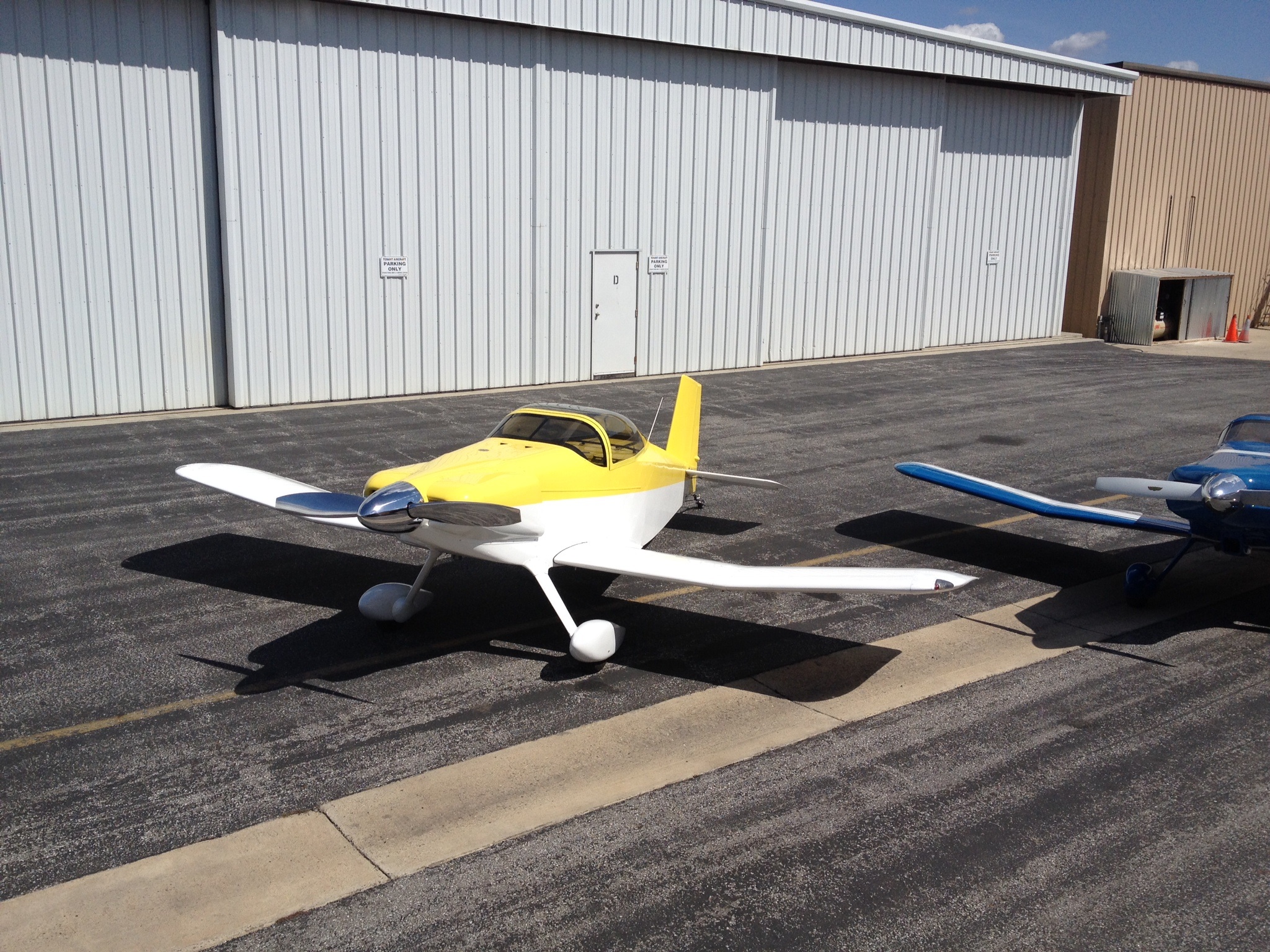

Our new bird has NACA inlet vents, two of them, just forward of the windshield. One goes to eyeball vent for pilot and one for the co-pilot. We were suspect about them, but in 100+ degree weather the cockpit get a nice airflow from them in flight. Not sure I well they would do if we were flying through a bit of rain. Probably need to make some stoppers for the them on cross country flights.

Here is the best pictures I got. Try to zoom in and look at the cowling just 5 or 6 inches away from the front windshield. I will try to take some up close pictures and post them later.

I like the NACA ducts since they make the airplane look like its going 10 kts faster... It would be a bear to install without removing the fuel tank though...I think...
