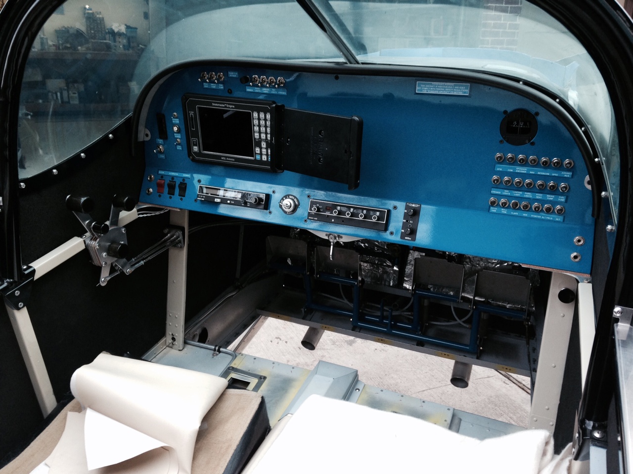

Fair nuff Willie, perhaps we need to narrow down our definition of "radius" ... Rich was asking about the 1" radius per the plans. You have a rounded edge that I would assume is the ~.25" (or so) radius which is do to the bend radius of the .063 material. But certainly not 1"
All I'm trying to say is that very few Thorps have the 1" radius called for in the drawings. and again very few airplane designs - period have a radius-ed panel .. I honestly cannot think of one. Once again not saying it's wrong, just justifing my failure to incorporate that in my panel.

Lee: Did you "curve" the bottom of the panel like in the plans ? I suppose that is to keep from cutting off your legs at the knees ! I found a HYVAC shop with a HUGE hydraulic press that put the "curve" on the bottom of my panel . When the young man found out the panel was for an aircraft, he didn't even charge me ! O0
Hey guys, 25 years ago that might have been me! My first introduction to a Thorp was a fella by the name of Popejoy. I think he was using a Blanton V6 conversion. He asked me to put that bend in his instrument panel. We had a hydraulic press at a shop where I was the young man in charge. Gladly told him the same thing when I found out it was for an airplane: "no charge". That's how I first heard you could build your own airplane. Happily, this is where I am now.
BTW, instead of the bend, my panel has the 3/4" angle at bottom too.

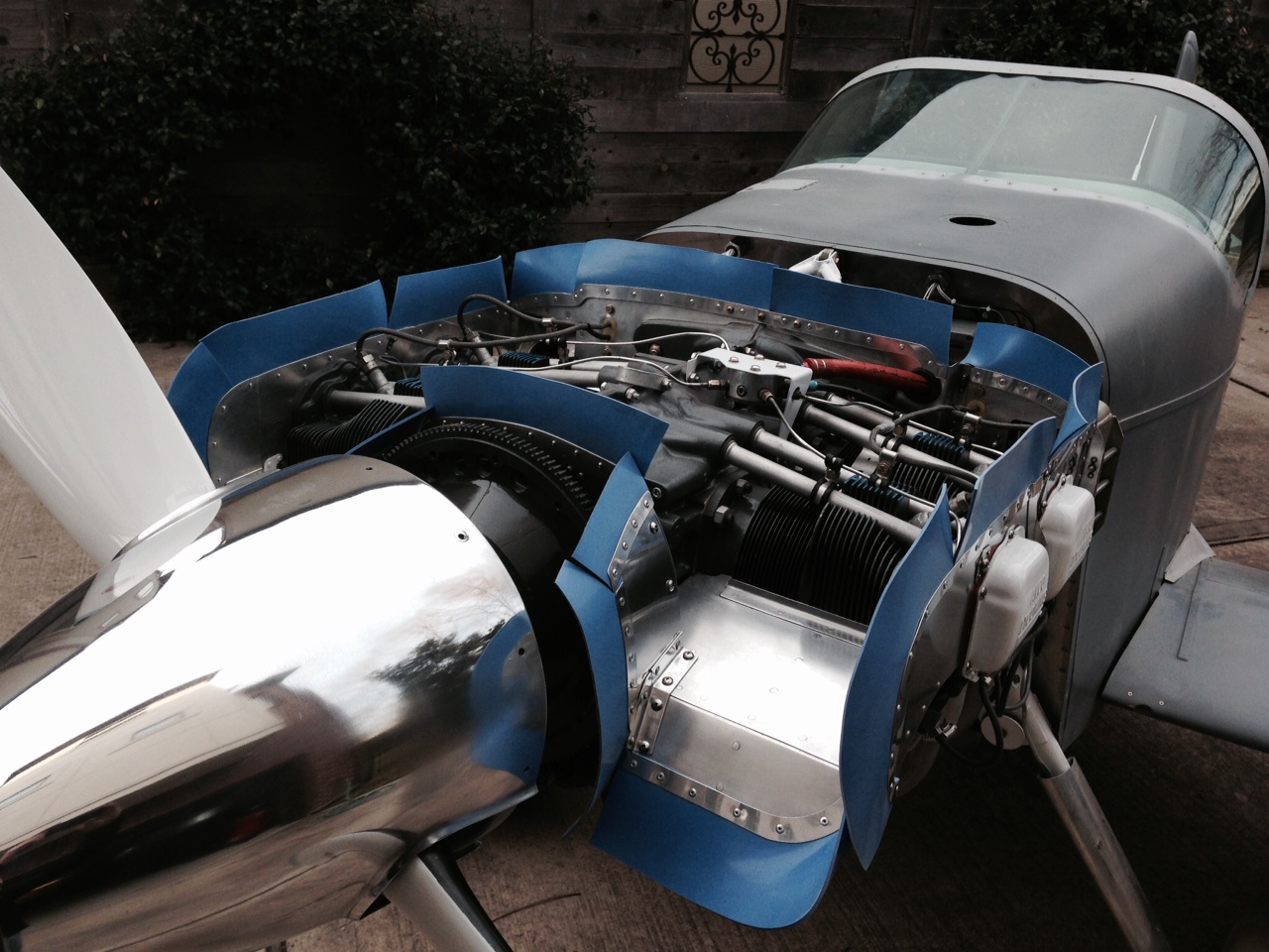

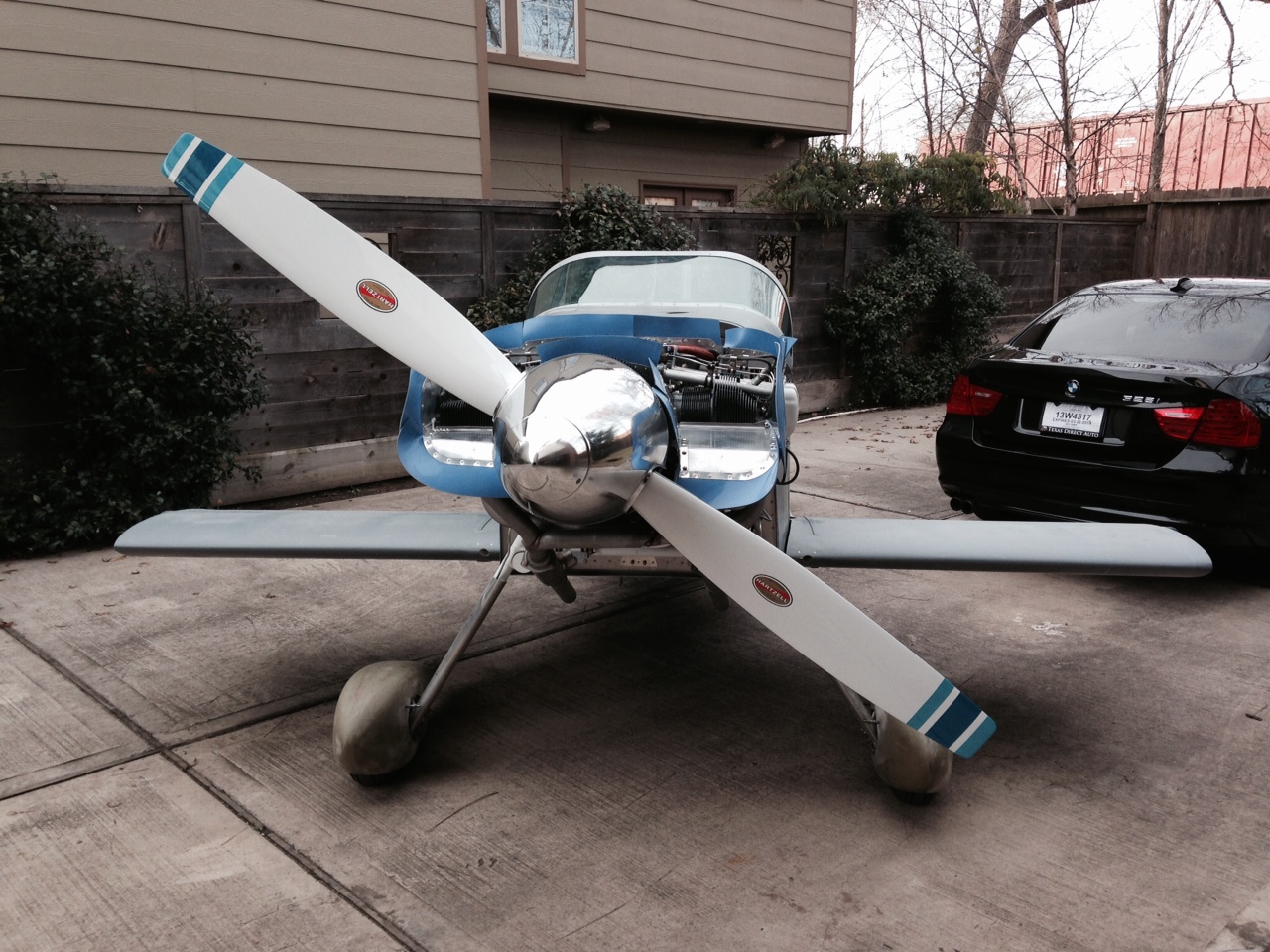

PostPosted: Thu Jan 30, 2014 3:35 pm

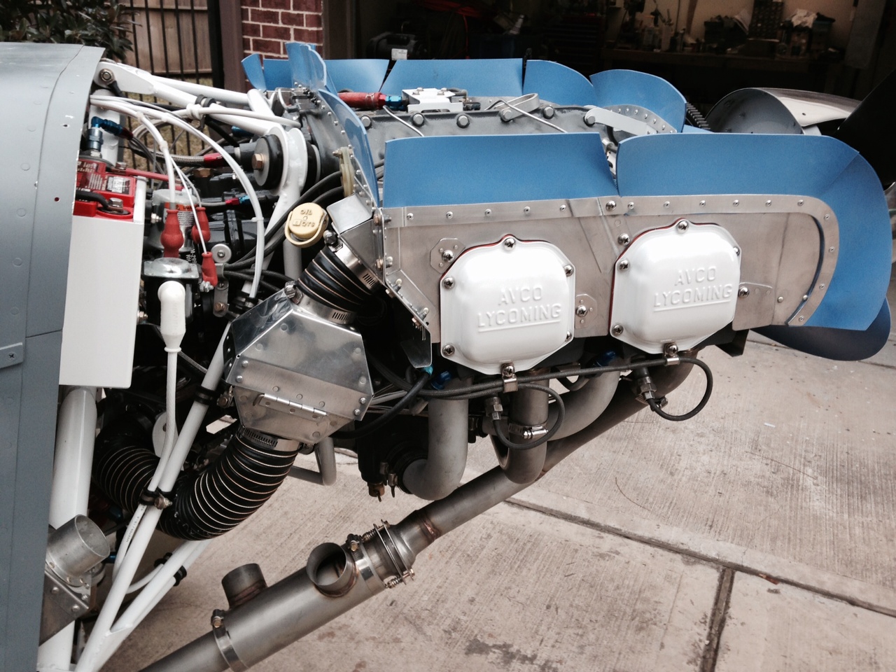

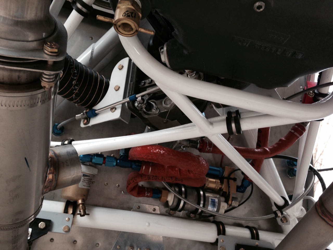

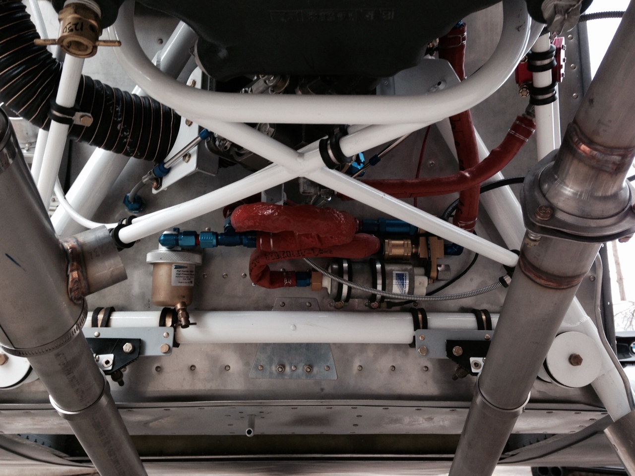

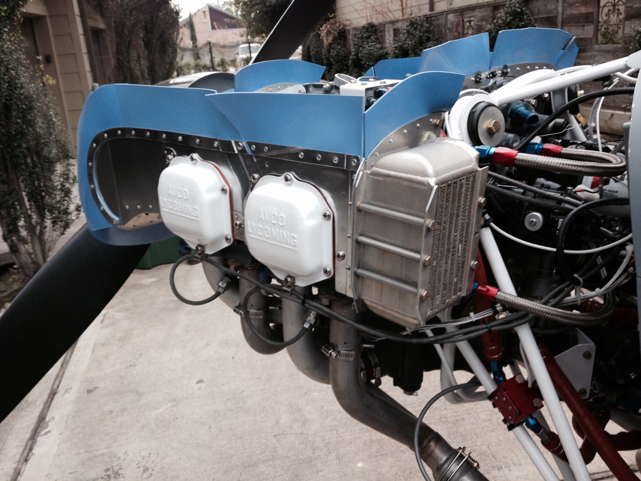

A few updated pics for you fellas ... per Mr. Wolff's request ....

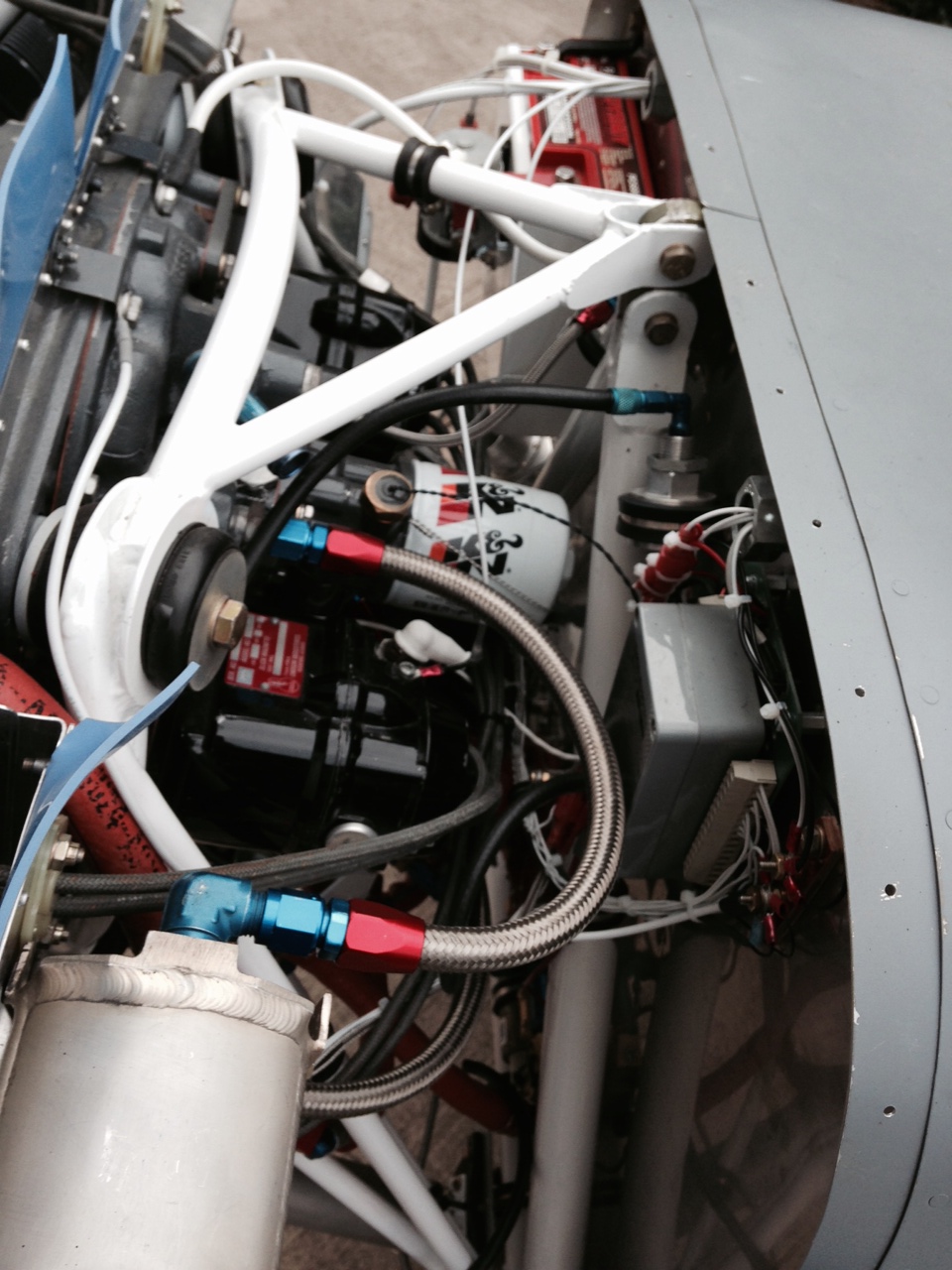

Lee,
Your Thorp looks fantastic. I'm interested in your oil filter set up. Who makes it? How is the clearance to the landing gear? Looks close but
assume everything clears OK.
Jim Borg
N180RG
PostPosted: Fri Jan 31, 2014 11:25 am
Thanks Jim,
That's a standard Lycoming Oil Filter adapter PN:77852 no mods or changes necessary. You do have to use a shorter oil filter though, a standard Champion will not clear the A-Frame.
Lee
PostPosted: Fri Jan 31, 2014 12:51 pm
K&N HP-1009 oil filter works.
Very nice work, Lee.

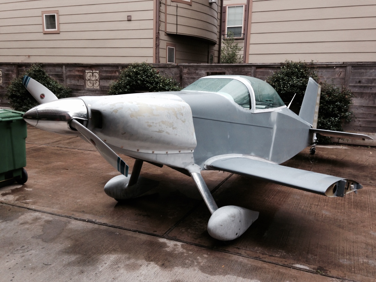

Made my last official airplane part the other day .. time to pull it all apart and start prepping for paint. Didn't quite make Sun n Fun but June looks promising.
