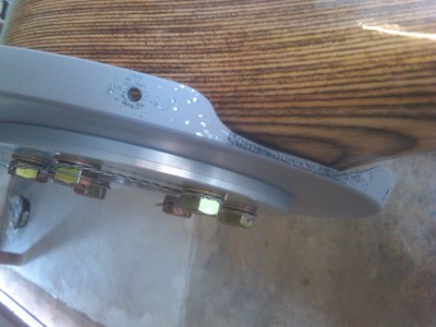

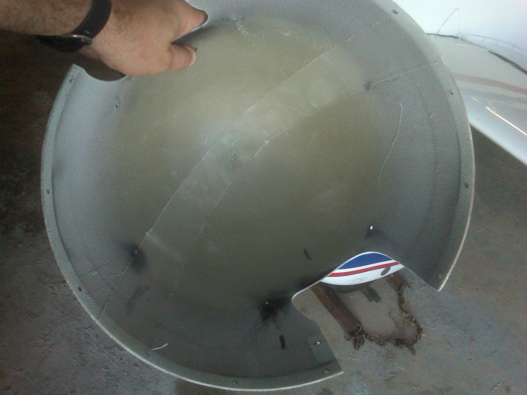

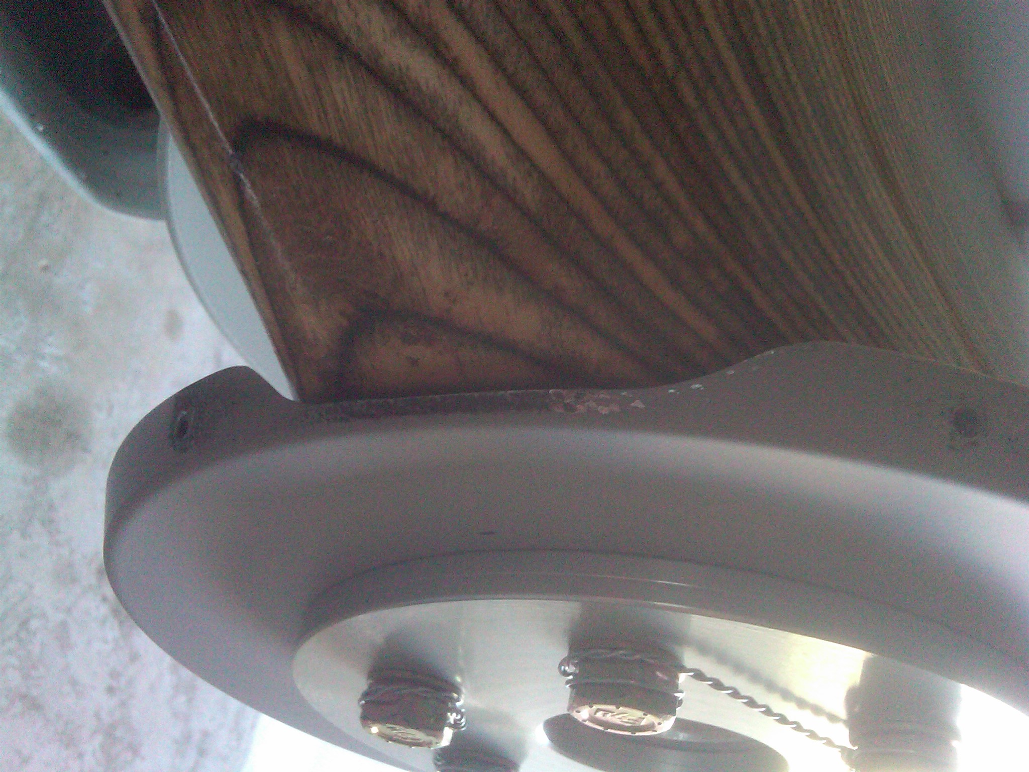

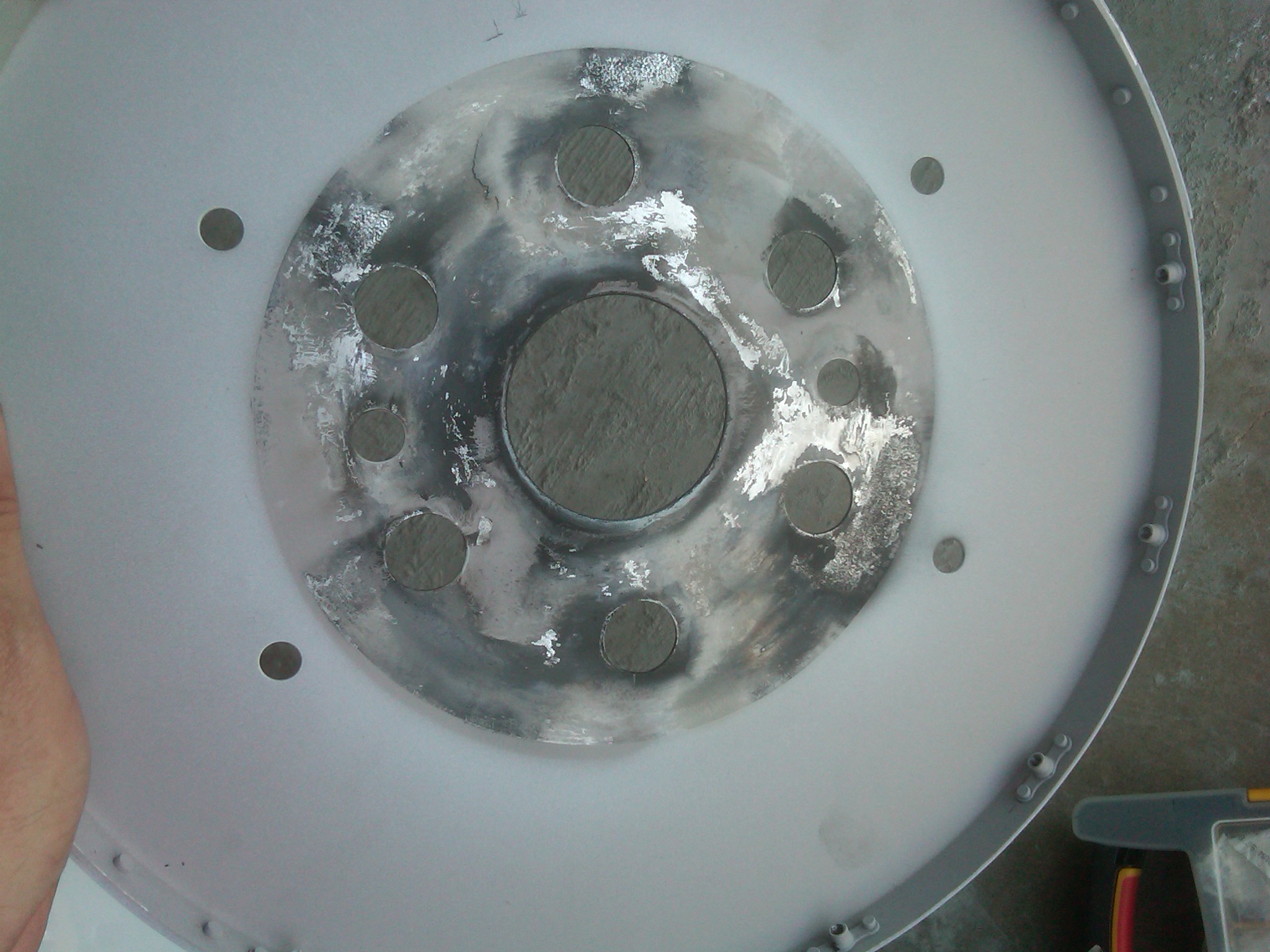

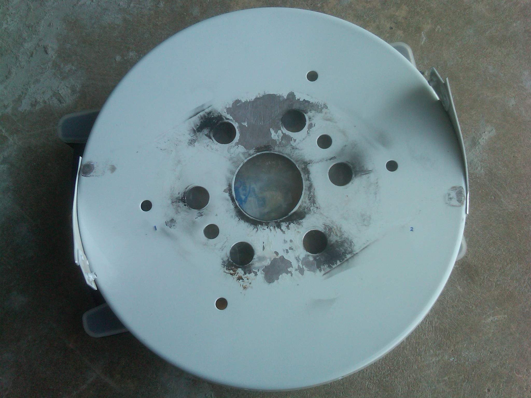

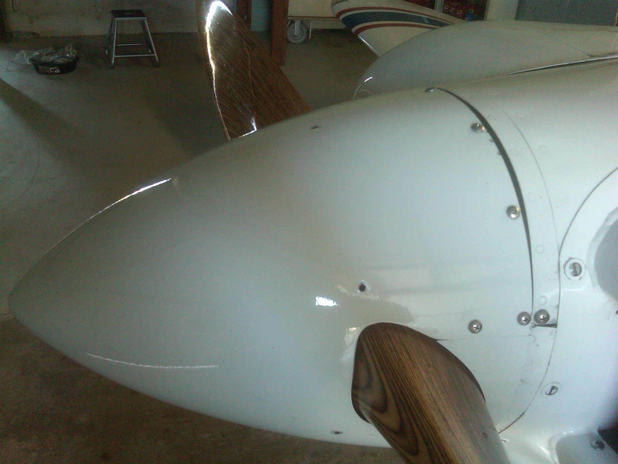

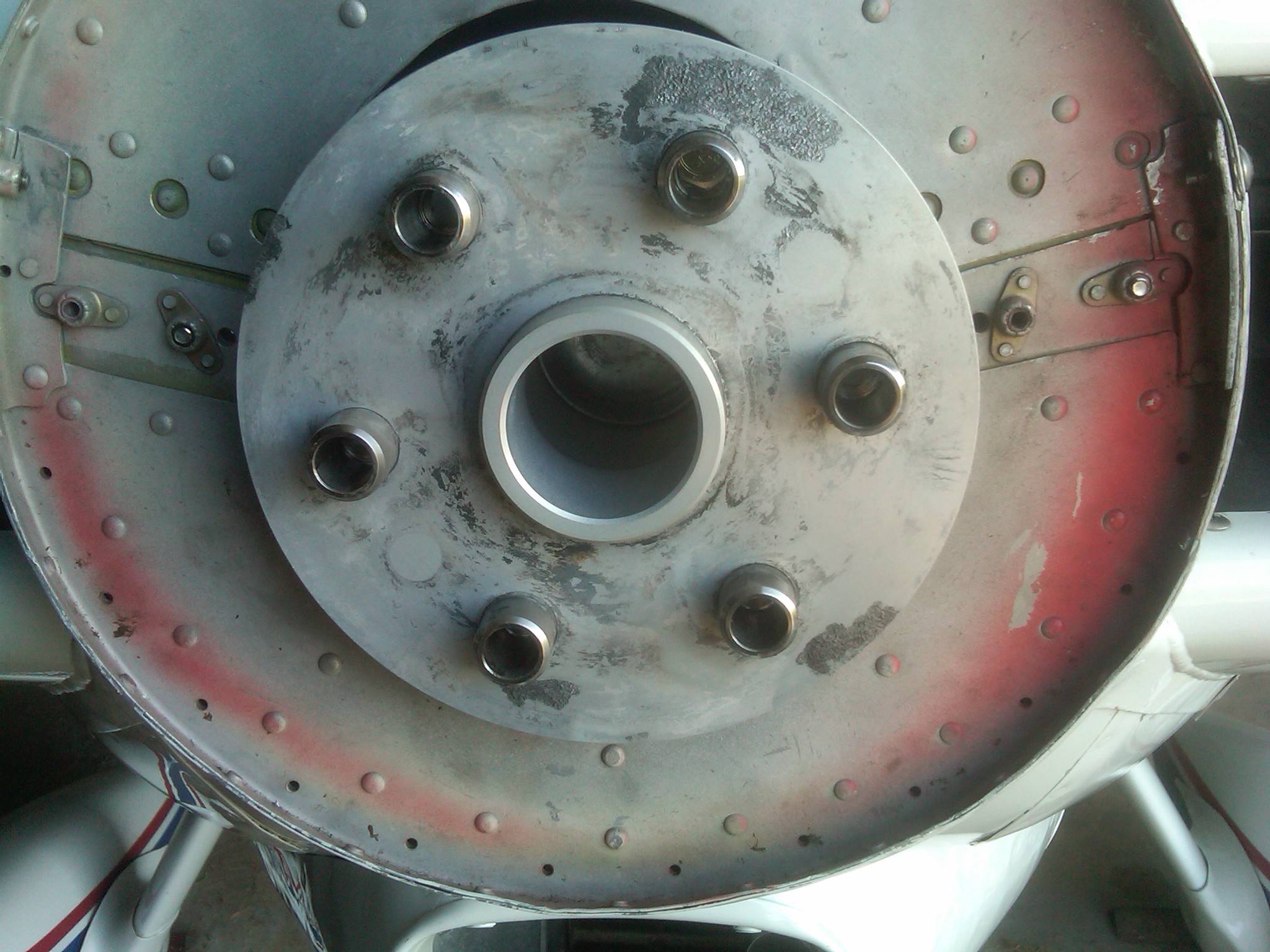

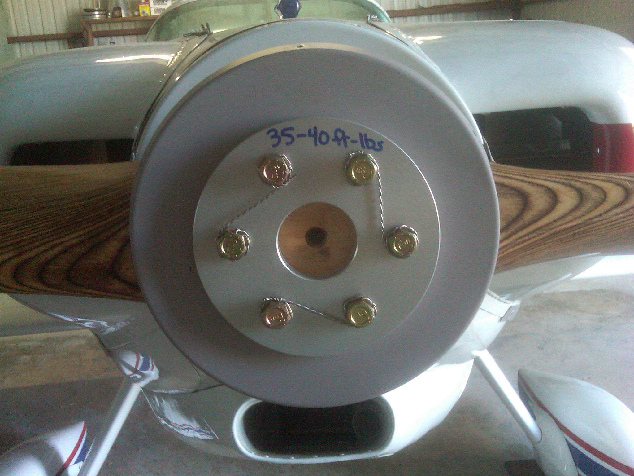

PostPosted: Mon Sep 09, 2013 2:53 pm
Posts: 1169
well, it appears the nutplates are my culprit. They all still have good threads in them, but they never grip the screw like a nutplate should. I can screw them all the way down with my fingers. The screws are correct for the nutplate. I called Frank at Performance Propellers, who advised he had not run a tap through them and was surprised by my information. Closer inspection revealed the nutplates on the larger spinner bulkhead were also the same way. I don't know why none of those screws hadn't loosened or come out.
Frank suggested I try and ever so slightly squeeze the nutplates to make them properly grip the screws. Would you guys agree with that course of action?

Rich, you are right, it is hard to believe. I have a bag of 10-32 and 8-32 screws from ACS. The 10 is too big and the 8 fits just right. Its just that the nut plates don't snug them down like they should. I think I'll buy some new nut plates, drill out the existing ones and replace them.
Dan, that's a good thought. I hadn't considered that. I Just better buy some new nut plates I guess. Its weird that all are this way, but I don't have any other explanation. Its either the screws or the nut plates.
