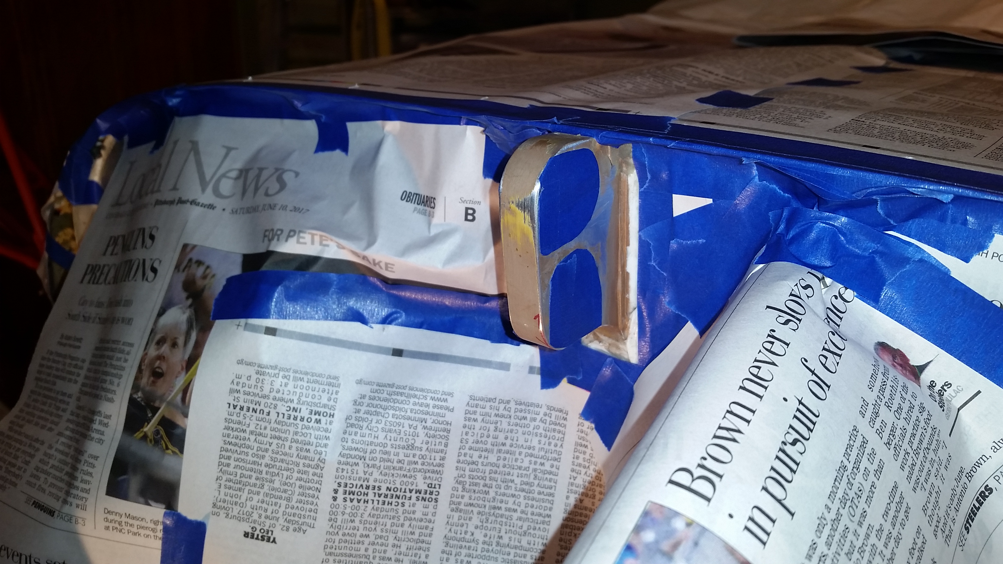

* Painted the A-frame attachment point at top of firewall

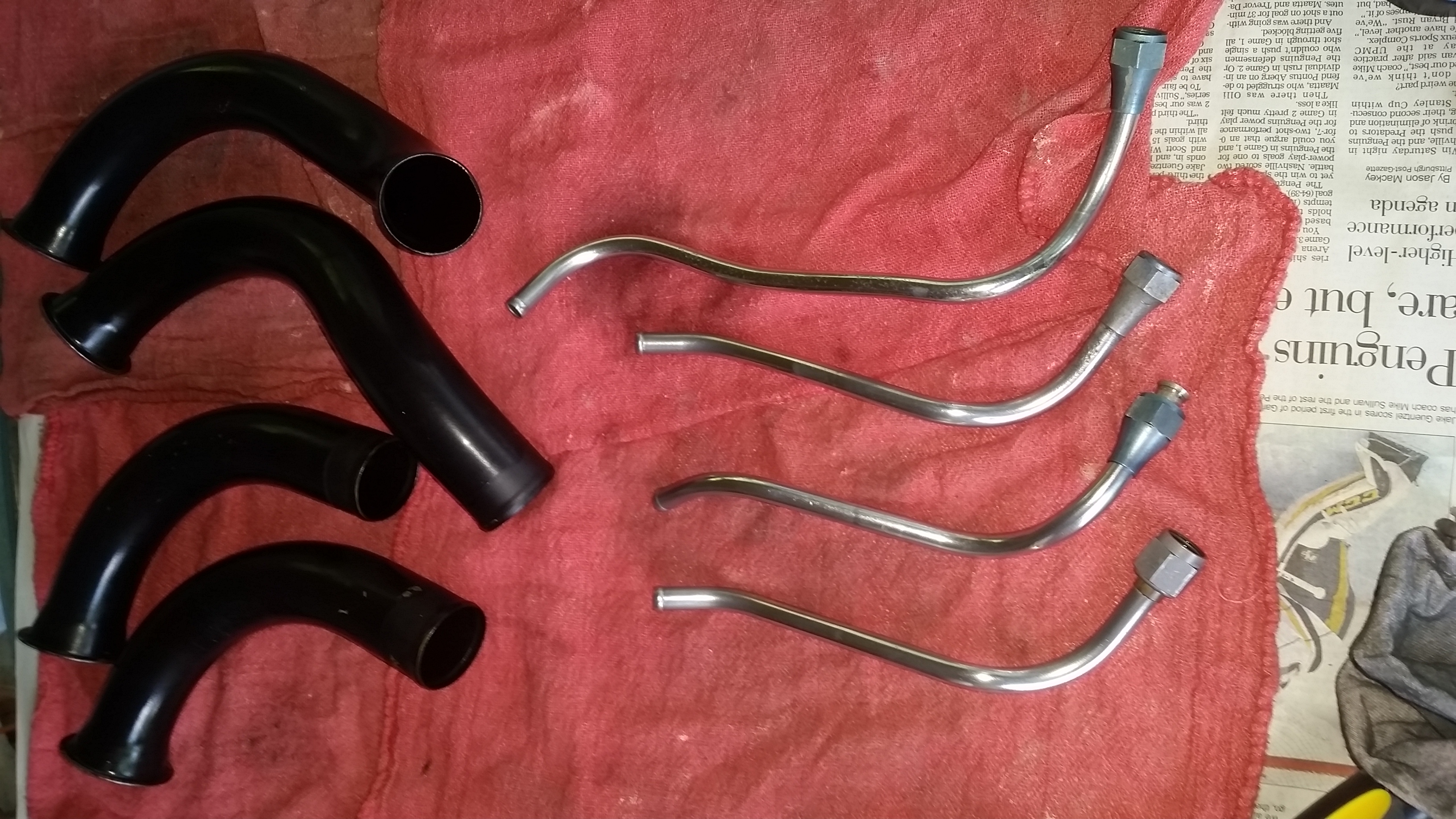

* Cleaned intake pipes and oil return lines

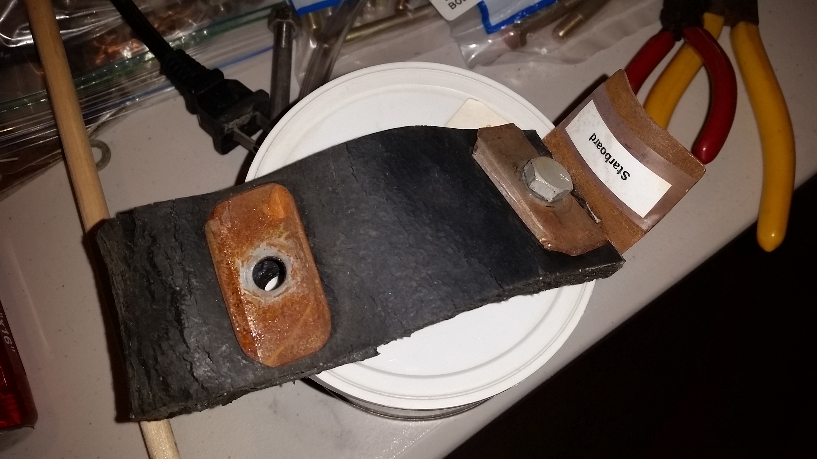

* Disassembled exhaust pipe hanger to replace rubber - Cubes - do you sell 8" long x 2" wide x 9/32" thick rubber strips or a better substitute?

File comment: Painted the upper longeron at top of A-frame
File comment: Cleaned intake pipes and aluminum oil return lines using Rolite
File comment: Exhaust support hanger with old rubber
PostPosted: Wed Jun 14, 2017 7:35 pm
Sorry John, I do not.
PostPosted: Wed Jun 14, 2017 7:39 pm
I went to a hose supply house and they had conveyor belt material . ??? Must be 6 ply/layer and very heavy duty . No need to double over . They sold me a strip for $1.00 . Enough for probably 4-6 hangars . :P It was stuff just sitting around taking up space . :o
PostPosted: Thu Jun 15, 2017 12:12 am
OK, no problem Cubes - it's one of those firewall-forward things anyways. Rich, thanks for the info about the 6 ply rubber. There are a ton of hose shops around here that have grown along with all the Marcellus Shale gas activities the past 10 years. I'll check with them but I don't think I'll get that kind of deal!
PostPosted: Thu Jun 15, 2017 1:51 am
Ask to look in their scrap pile. That's where I got mine.
PostPosted: Thu Jun 15, 2017 10:20 am
Don't hold me to the 6 ply comment . I was shooting blank twinkies when I said that . ??? It is a multi ply material that holds up very well . Number of plies will probably be based upon the type of belt material you find . I was using a material similar to what you have now and it didn't last long . The conveyor belt material has been in for several years and shows no sign of giving up . :P
PostPosted: Thu Jun 15, 2017 3:48 pm
Auto stores sells flex straps for exhaust, ever try cutting the sidewall out of an old tire?
PostPosted: Thu Jun 15, 2017 4:11 pm
I've tried the "flex straps" for exhaust from the local Autozone . Cheap Commie Crap made in China . :P Did not last long at all ! If I could fit a tire on a band saw to cut it up that might work . Much easier to get a squared up conveyor strip and then cut it to the size you need using a band saw . ;)
PostPosted: Fri Jun 16, 2017 6:56 am
Go talk to a farmer who has the equipment to make the big round hay bails. He will probably have some old straps from the bailer laying around. It would be a lot like the conveyor material Rich mentioned but likely easier to find close to Rostraver.
