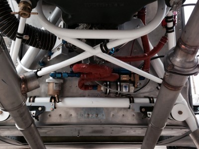

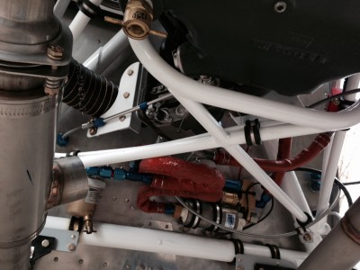

PostPosted: Thu Jan 30, 2014 3:35 pm

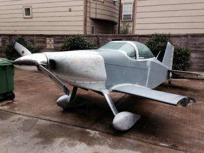

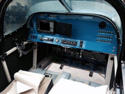

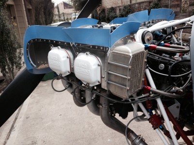

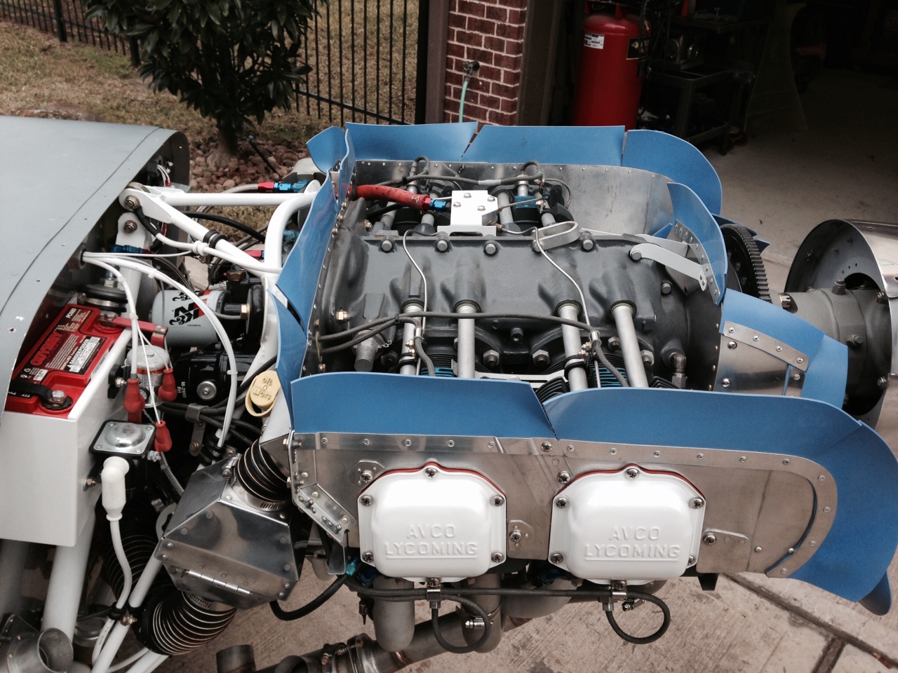

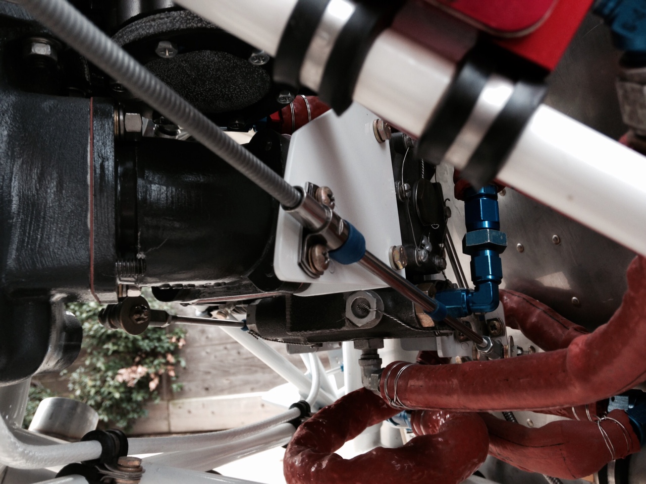

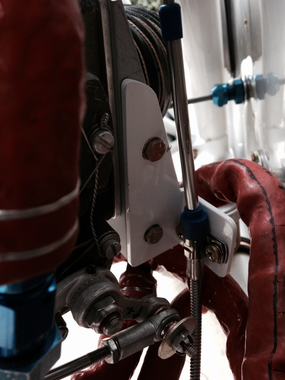

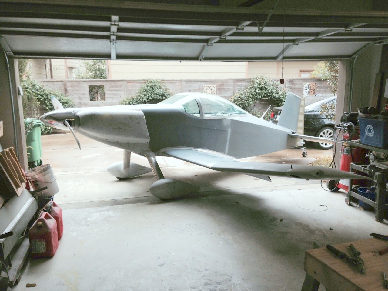

A few updated pics for you fellas ... per Mr. Wolff's request ....

PostPosted: Thu Jan 30, 2014 7:16 pm
Yup, that's a keeper, Fine work, Good job just keep going..........Dan
N89BJ
PostPosted: Fri Jan 31, 2014 1:23 am
Very clean and inspiring! Thanks for sharing the pictures.
jim borg

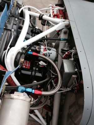

Lee,
Your Thorp looks fantastic. I'm interested in your oil filter set up. Who makes it? How is the clearance to the landing gear? Looks close but
assume everything clears OK.
Jim Borg
N180RG
PostPosted: Fri Jan 31, 2014 11:25 am
Thanks Jim,
That's a standard Lycoming Oil Filter adapter PN:77852 no mods or changes necessary. You do have to use a shorter oil filter though, a standard Champion will not clear the A-Frame.
Lee
PostPosted: Fri Jan 31, 2014 12:51 pm
K&N HP-1009 oil filter works.
Very nice work, Lee.

I like this kind of pictures! Clean work and fine detail....
Do you have a approximative date for the flight test?

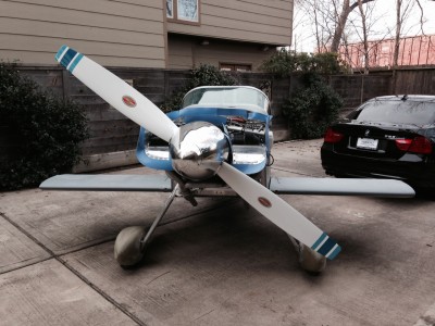

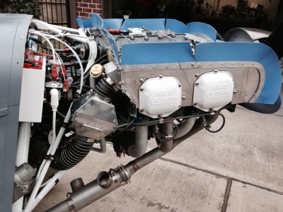

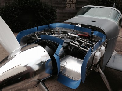

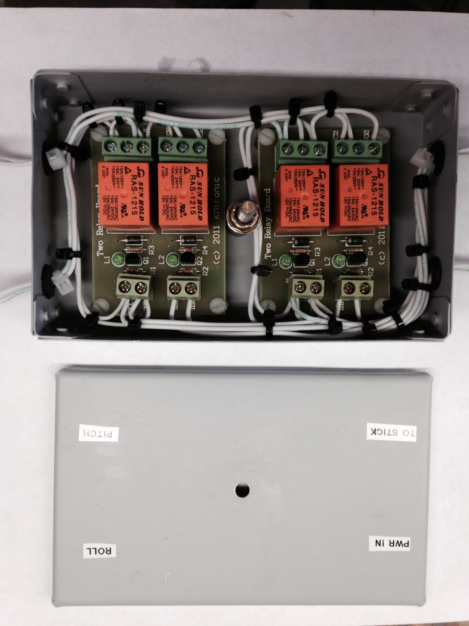

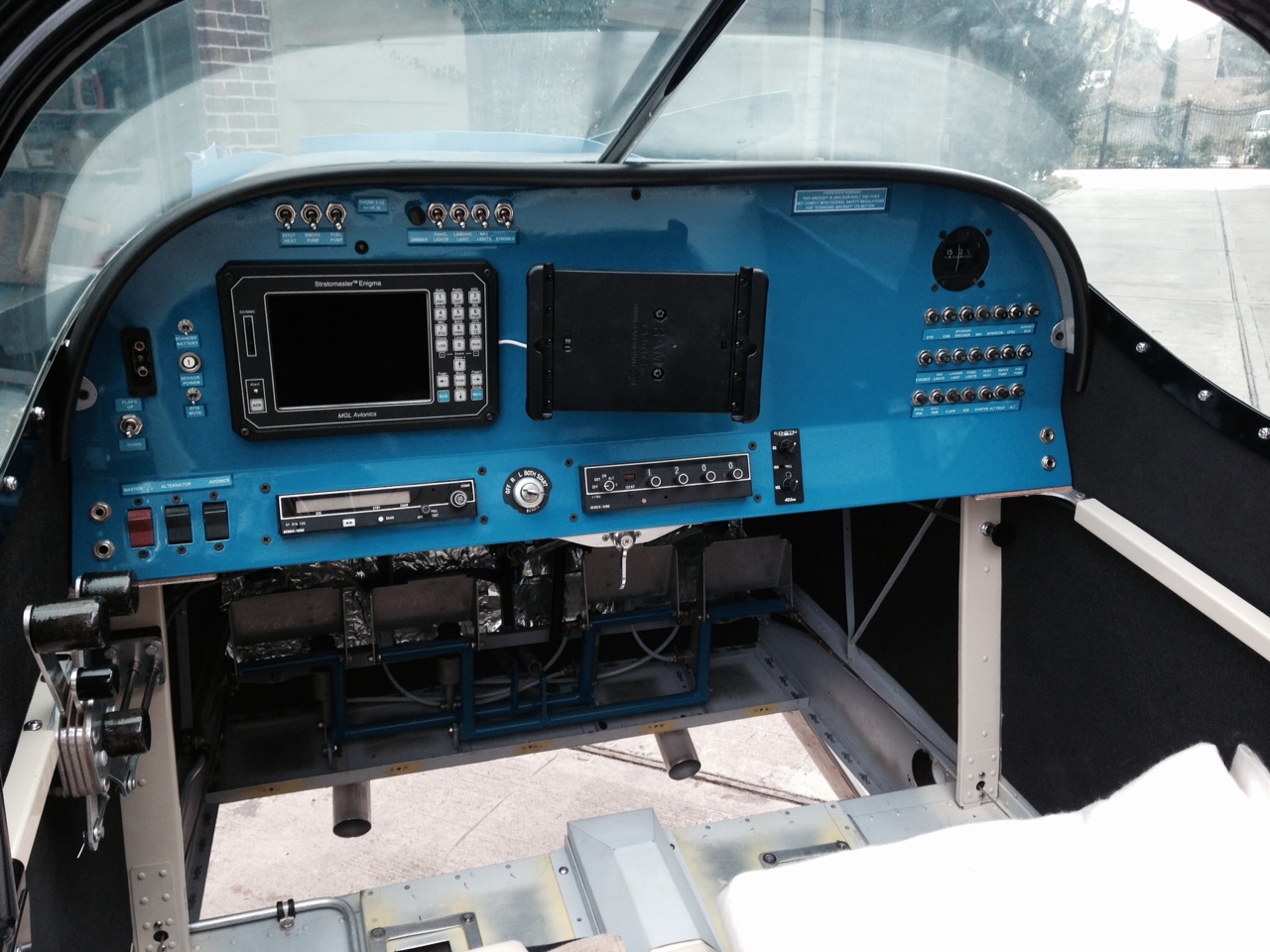

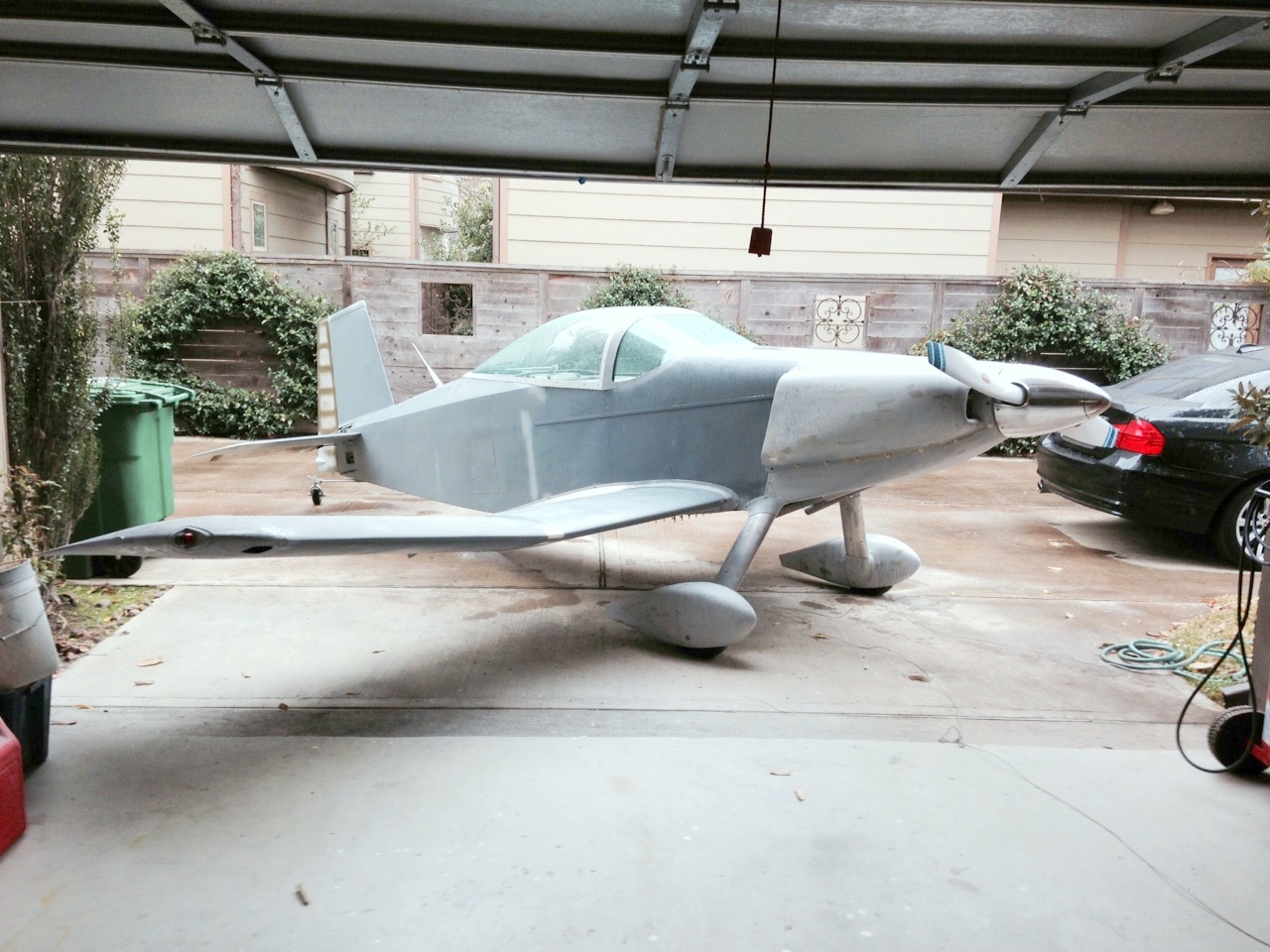

PostPosted: Mon Mar 17, 2014 10:52 am

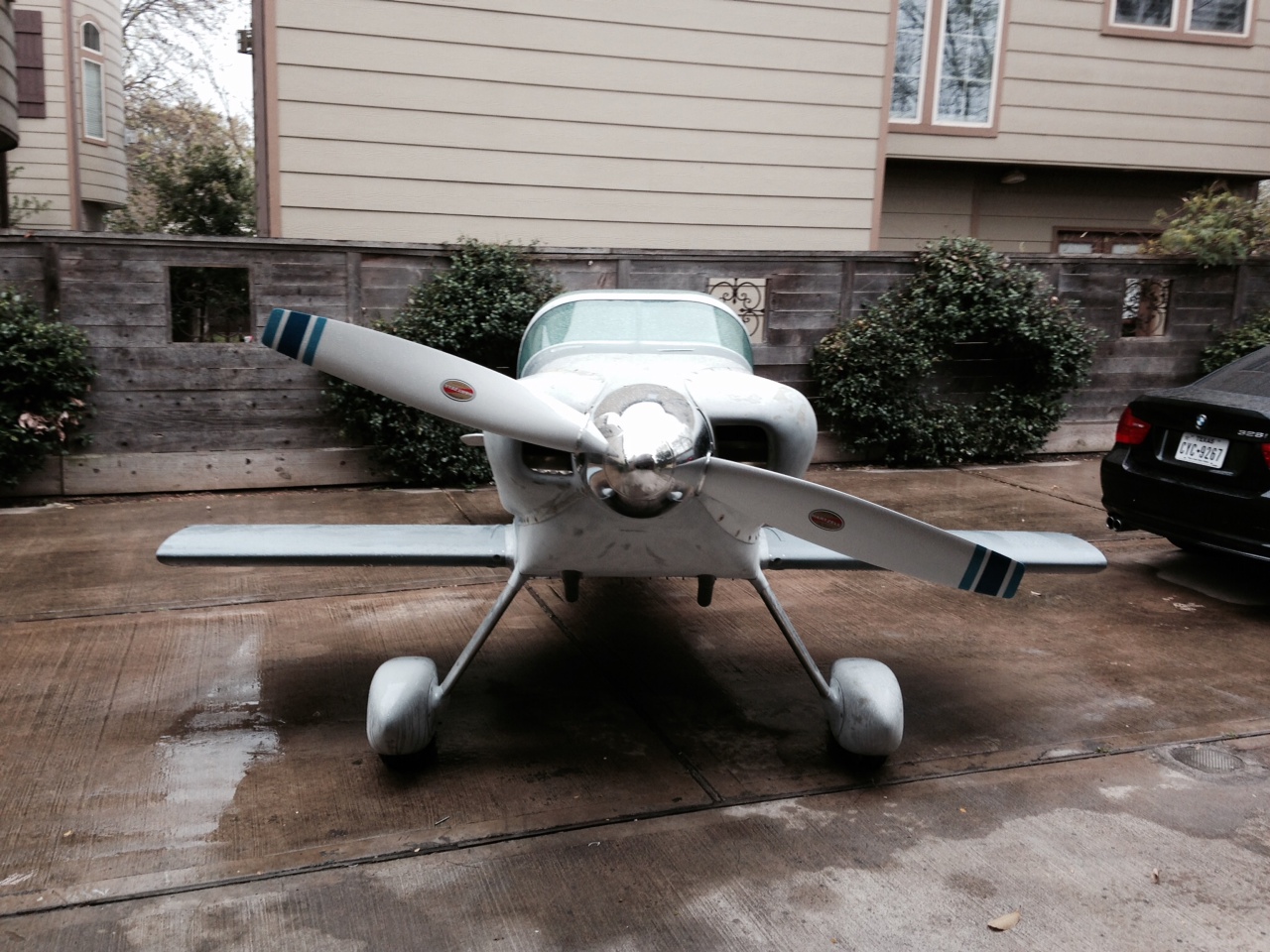

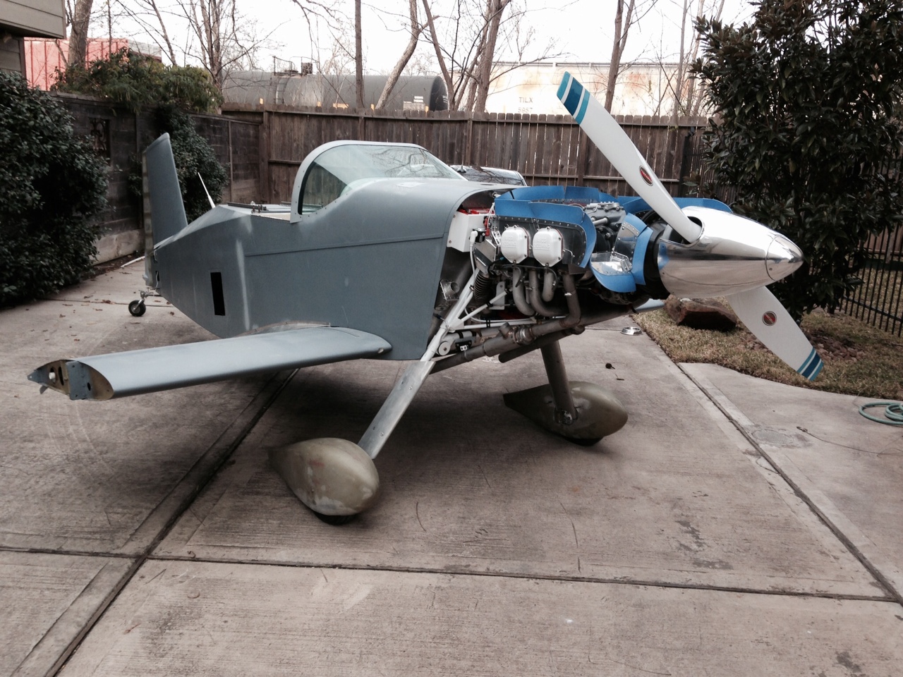

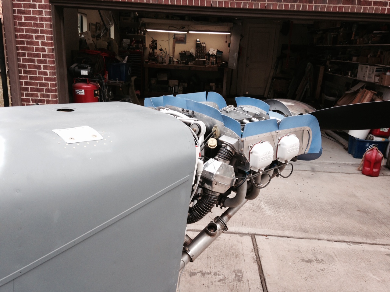

Made my last official airplane part the other day .. time to pull it all apart and start prepping for paint. Didn't quite make Sun n Fun but June looks promising.

PostPosted: Mon Mar 17, 2014 2:15 pm
Bravo!
Now you can come up to Ontario and help me finish mine!!
