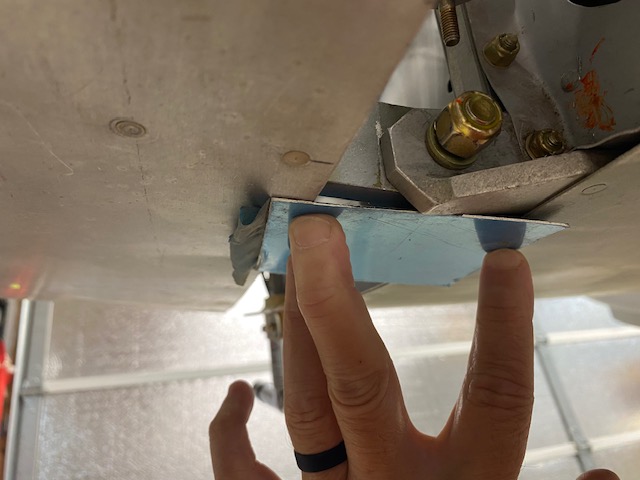

So the wing attachment angles are protruding below the wing, and when I go to install the wing gap covers, it does not sit flush as you can see from the pic. Should I shave off the protruding portion of the wing attachment fitting, or finesse the wing gap cover to where it will dip down below the protruding attachment?
PostPosted: Sat Nov 01, 2025 10:42 pm
Roll a longitudinal "V" into the strip.
