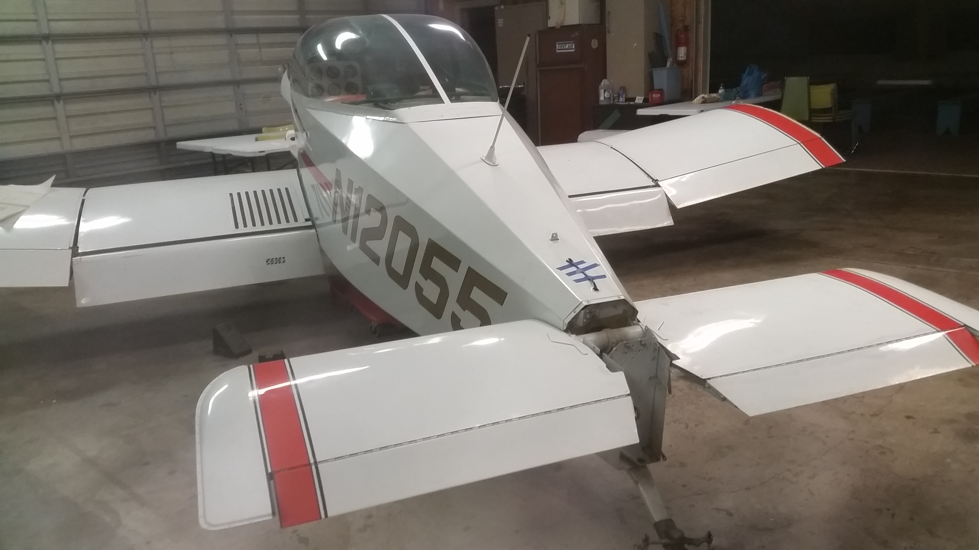

N12055 is coming along - the horizontal tail is back on and all the pivots have fresh lubriplate.
File comment: N12055's stabilator is back in place.

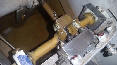

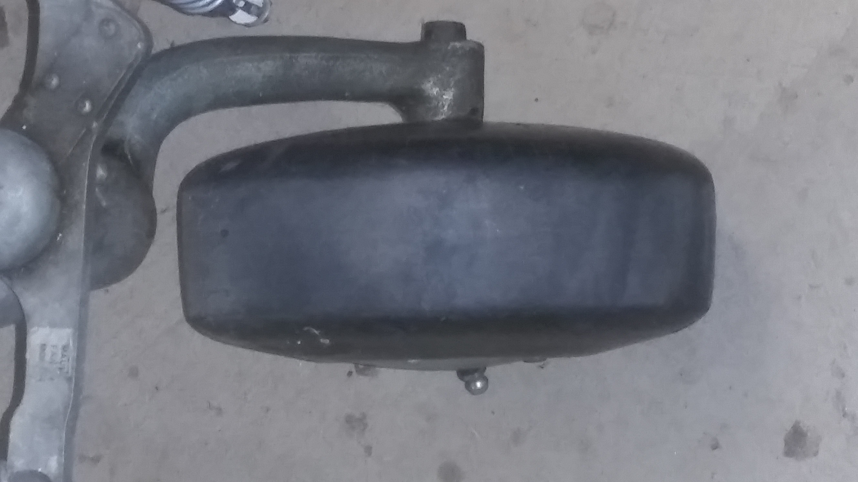

Hello all, I've been steadily working on N12055 and have a question. Does this tailwheel need replaced? See how it's narrower on one side?

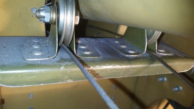

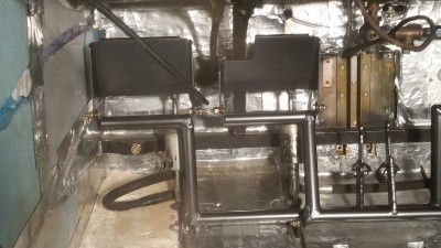

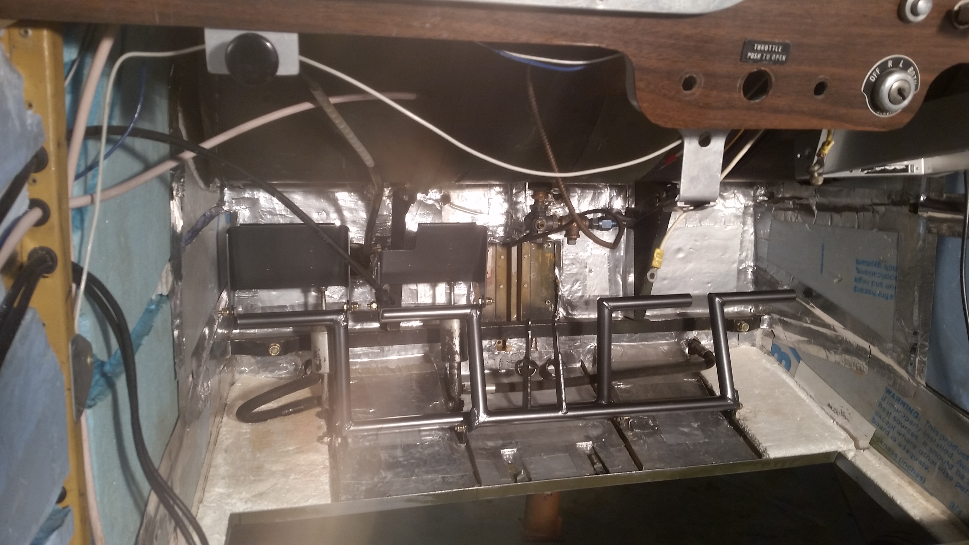

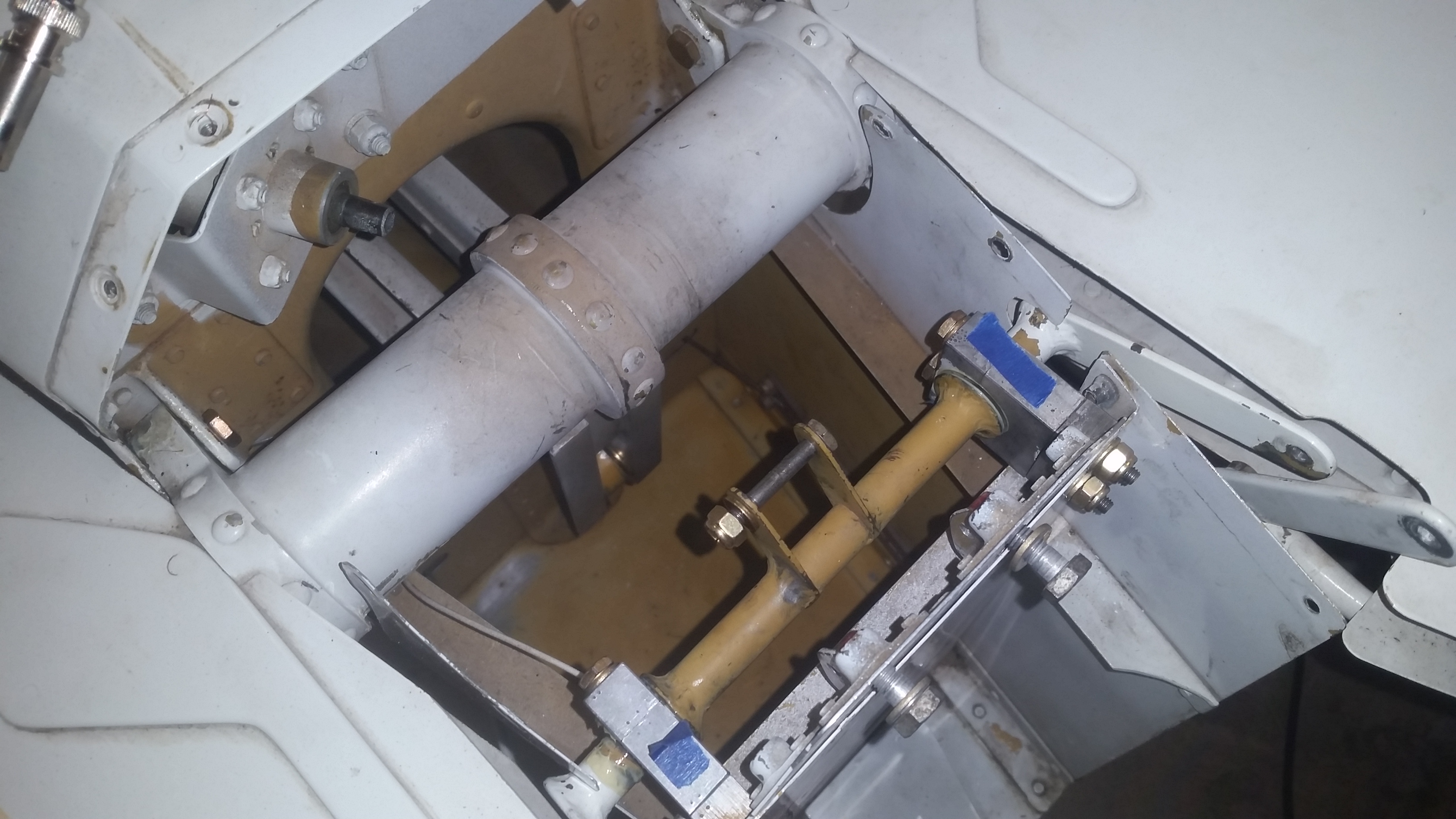

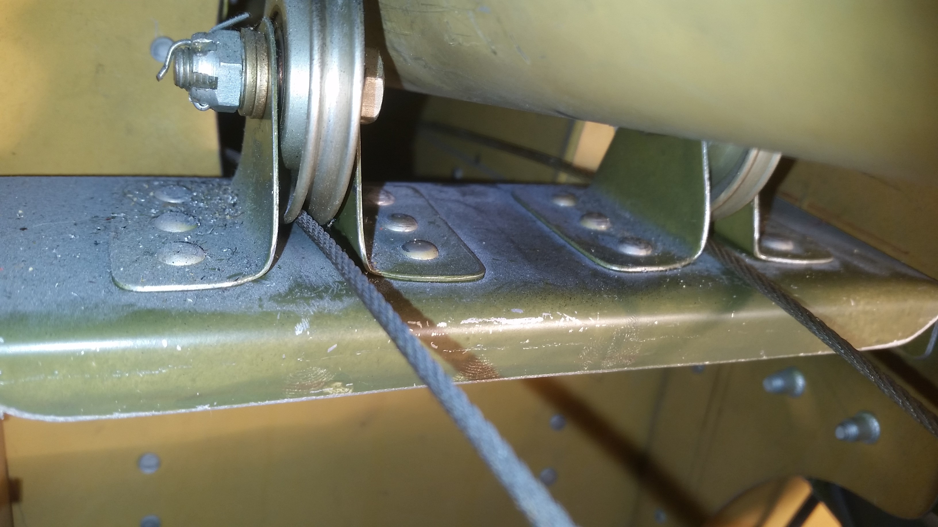

Here are some other pictures of putting the trim block back in now that the horizontal stabilizer is reinstalled. I have other pictures for the rudder pulleys inside the tunnel right behind the seats. Also, the newly painted rudder pedals are in.
File comment: What's up with this?

File comment: Pulleys behind the seats (dirt not cleaned up yet)
File comment: All lubed up. Note that I had to remove the right aluminum mounting to get the center bearing block (the silver block with the gears attached) in there (nut not on bolt yet)

File comment: Trial Fit
File comment: Close up of the notch to clear the fuel tank support
File comment: Rudder Pedals

I wouldn't worry about the tail wheel yet. Keep an eye on it. However, it shows uneven wear. That could very well mean that it is not bolted on vertical. Take a good look at that. I'd worry more about that than the condition of the wheel.
The trim block is non-standard. I've never seen one like that before. Not that it won't work. Just make sure it is secure. Also, once the nut is installed, make sure you can turn the jackscrew 5 1/2 turns stop to stop. Once everything is installed, get out the 521 drawing and align your trim system that way.
PostPosted: Mon Nov 06, 2017 6:07 am
Maule tailwheels do that. As Cubes said, keep an eye on it. The trim block looks like one I have. Ditto on 5 1/2 turns stop to stop and check travel per the drawing.

Regarding the tailwheel - I'm sure Bob is right, but you might want to check that the tailwheel assembly is exactly vertical, and perpendicular to the ground. The relatively wide rubber tire will wear and show it more easily than some narrower tires if it isn't. You can shim the wheel at the spring to get it just right if you want to. The misalignment, if any, is more than likely in the spring.
PostPosted: Wed Nov 29, 2017 8:04 pm
Thanks to Cubes, Bob, and John for the info on the tailwheel. I have looked at it a little and it appears vertical. I'll check it in more detail when I work my way back there.
