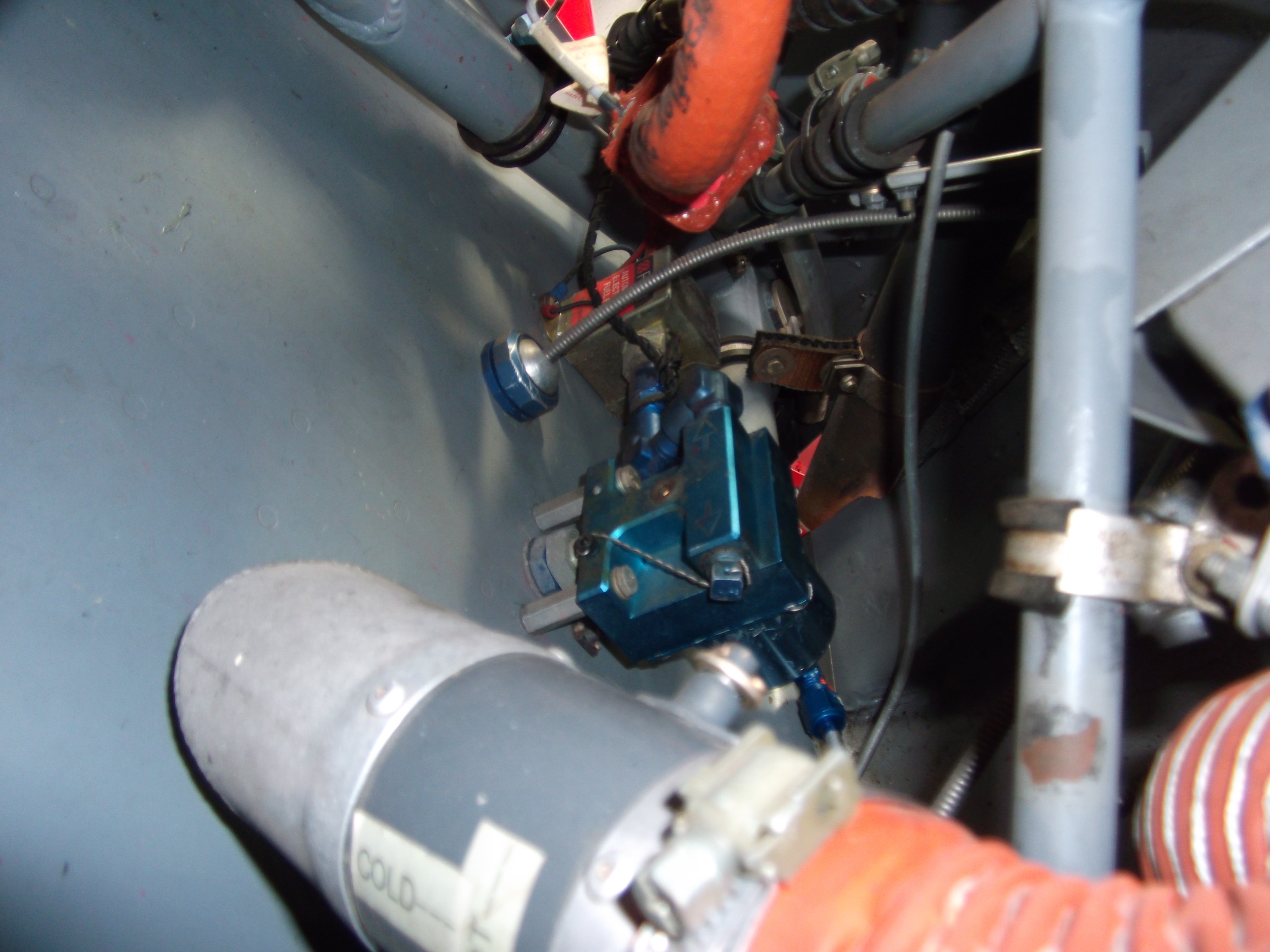

Mounted my usher to the firewall using (2) standoffs to give me room to remove the sediment bowl . It has been on for 10 years with no problems . Recommend you have a couple of sediment filters and Viton o-rings on hand . Cheap parts and there when you need them for annuals .

Hey Rich, if you get really bored during the COVID19 lock-in, I would love to see some photos of how you mounted your Usher gascolator. I've copied most everything else from you, why not my gascolator mount too.

Dude: Best I could do with the bottom cowl in place . One week earlier and I would have had a clear shot during the annual with the cowl off . Nothing fancy about the mounting...except it was installed during the build with the fuel tank not in place and a clear firewall for mounting . No problems with the unit after 10 years in place .

oh, that's perfect shot Rich, many thanks.
PostPosted: Sat Apr 04, 2020 5:50 pm
Go to my personal album and there are (2) additional pics showing the gascolator during the build process w/o the (2) standoffs which were added later .
