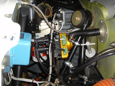

I went through a lot parts last year trying to find a filter adapter that would work on my T-18 (O-320-E2D). I initially thought I'd use the standard Lycoming adapter with the short K&N filter (1002 or 1009) which has worked for others. It didn't work for me. I didn't have enough room to install the filter with the adapter installed on the engine. The nipple in the adapter could have been cut down to provide a little more room. I decided to try the B&C adapter I purchased for the IO-540 on my Biplane. The B&C adapter works great on my Thorp with a 3/4" spacer. It clears the mount and cowling and uses a standard CH 48108-2 aircraft filter. The B&C and Casper filter adapters look very similar. It may work. Here's a couple photos of the B&C adapter installed on my plane.
Hope this helps,
Marshall

Which B&C Adapter did you use. I'm thinking the BC700-H is the one you're talking about, but I wanted to confirm that.
Also, where do I go to find information about Rich's remote oil filter setup?
Fly
 Post subject: Re: Oil Filter
PostPosted: Thu Jan 08, 2015 12:39 am
Yes, the BC700H is the adapter I installed. My adapter is from the first production run so it's annodized Gold rather than Clear like the new adapters. It won't clear the engine mount without the 3/4" spacer so don't forget to order one of those.

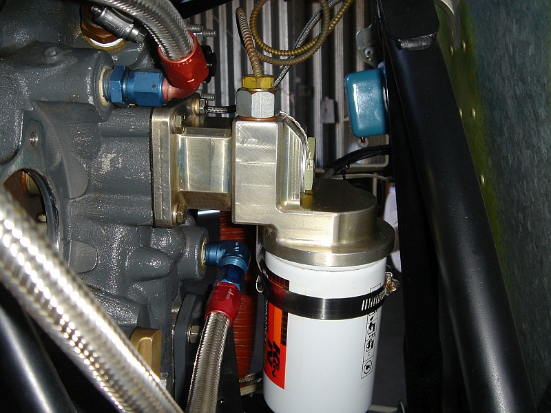

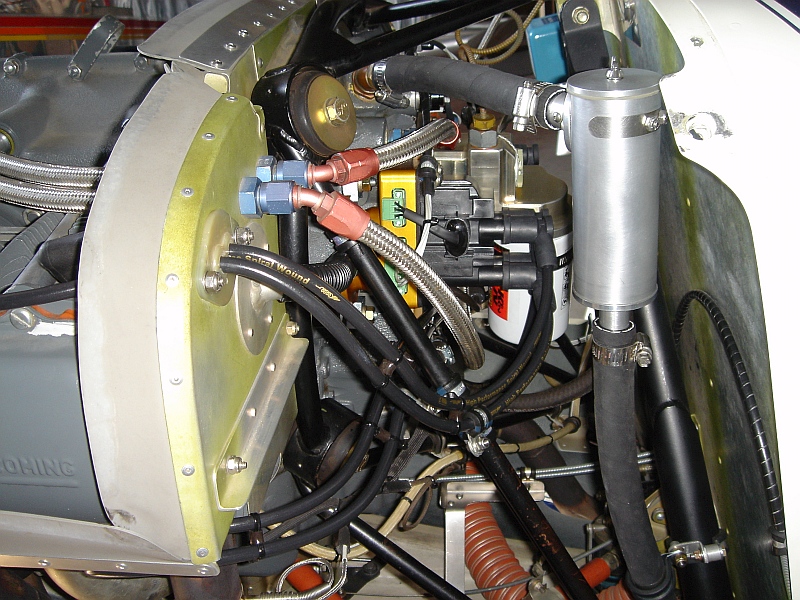

Or, you could build your own like I did, long before there were any available commercially.
BTW, I'm not using the P-Mags shown in these pictures any longer.

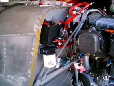

I bought my remote filter setup from Summit Racing. Rich walked me through with all the part numbers for all the items he used, but I am unable to locate that post in my searches. If you decide to go this route, I will be glad to locate all the part numbers that I used. Here is a picture of Rich's setup

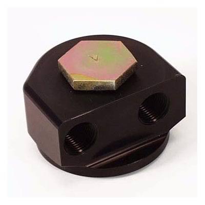

I put this on the back of the motor to route the oil from the motor to the remotely mounted filter. Its also from Summit.
http://www.summitracing.com/parts/ctr-22-595 I'm not sure if the link is the exact one you need, but its representative of the one I used. Its great because you tighten it with the gold bolt on top, and you can rotate the black housing to any angle that best suits your needs.

Do the bolt holes on this adapter from Summit match the mounting flange on the back of the engine where the oil screen assembly is, or does it mount somewhere else?
PostPosted: Thu Jan 08, 2015 4:53 pm
You will need to replace the screen/vernitherm with an oil filter adapter to make this work
