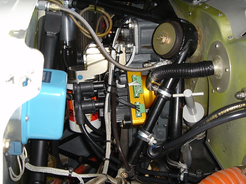

I went through a lot parts last year trying to find a filter adapter that would work on my T-18 (O-320-E2D). I initially thought I'd use the standard Lycoming adapter with the short K&N filter (1002 or 1009) which has worked for others. It didn't work for me. I didn't have enough room to install the filter with the adapter installed on the engine. The nipple in the adapter could have been cut down to provide a little more room. I decided to try the B&C adapter I purchased for the IO-540 on my Biplane. The B&C adapter works great on my Thorp with a 3/4" spacer. It clears the mount and cowling and uses a standard CH 48108-2 aircraft filter. The B&C and Casper filter adapters look very similar. It may work. Here's a couple photos of the B&C adapter installed on my plane.
Hope this helps,
Marshall

Which B&C Adapter did you use. I'm thinking the BC700-H is the one you're talking about, but I wanted to confirm that.

Yes, the BC700H is the adapter I installed. My adapter is from the first production run so it's annodized Gold rather than Clear like the new adapters. It won't clear the engine mount without the 3/4" spacer so don't forget to order one of those.

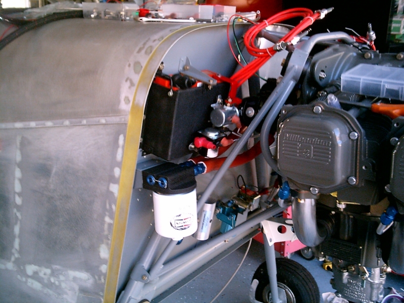

Or, you could build your own like I did, long before there were any available commercially.
BTW, I'm not using the P-Mags shown in these pictures any longer.

I bought my remote filter setup from Summit Racing. Rich walked me through with all the part numbers for all the items he used, but I am unable to locate that post in my searches. If you decide to go this route, I will be glad to locate all the part numbers that I used. Here is a picture of Rich's setup
