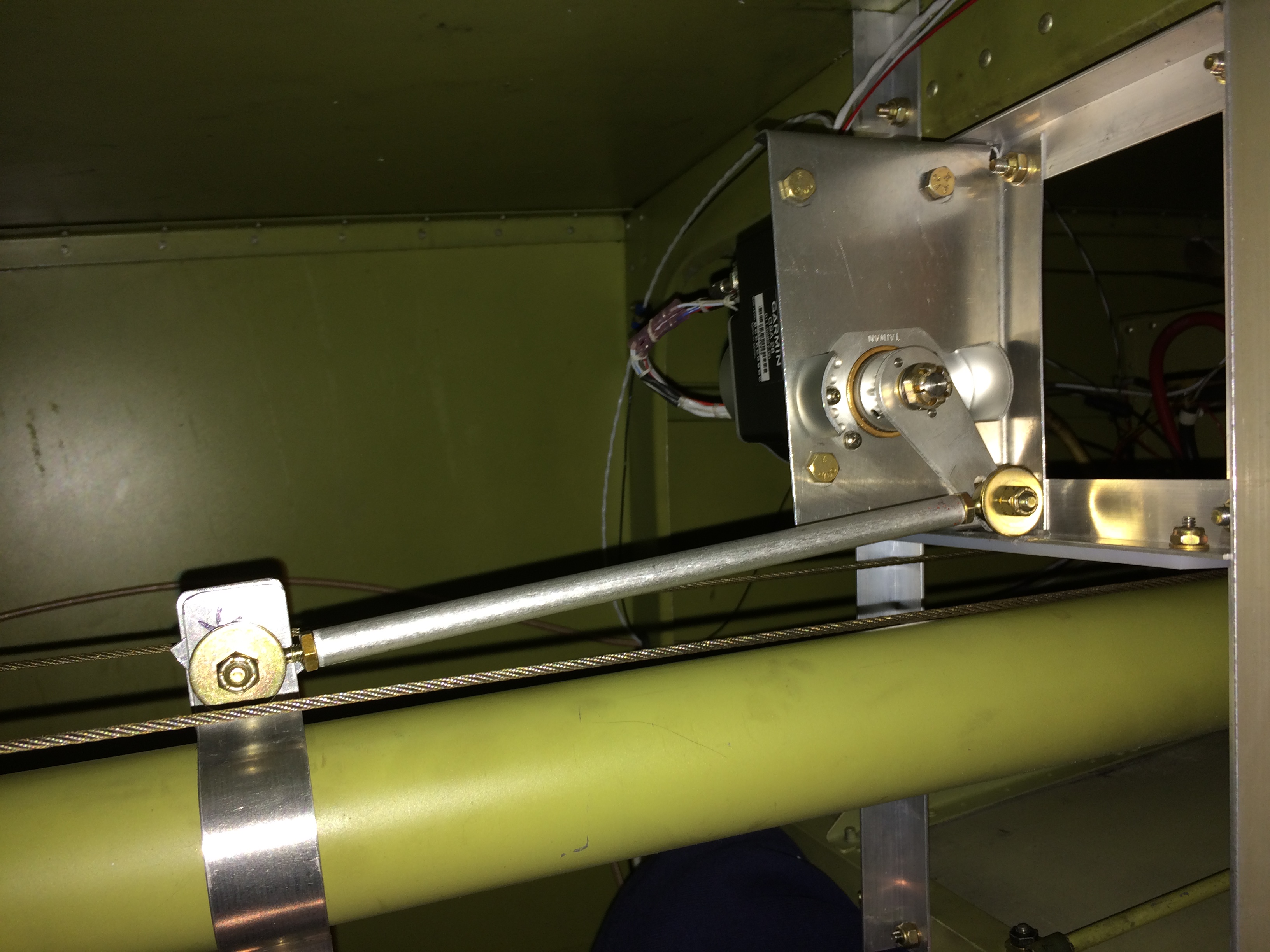

Has anyone else experienced a problem with installing a pitch servo for an autopilot on their T-18?
I have GRT brand servos, but they look about the same in geometry as most other popular servos. When I hooked it all up (I should have thought to try this beforehand) the throw of the elevator tube from stop to stop is much more than the throw of the servo arm. I spoke with a friend who had this problem on his Tailwind and he just made an extension on the servo arm to fix the problem. This was my first thought also, but it also increases stress on the shear bolt on the servo.
Is there another solution that I should be thinking of? Anyone who has installed an AP on their Thorp, I would love to see some pics to spur some thoughts.

PostPosted: Thu Jan 20, 2022 2:47 pm
Joined: Mon Jun 07, 2021 8:29 pm
Posts: 48
Location: Y51 - Viroqua, WI
I don't have great pics but I snapped a couple quick ones of my mount at least. Mine has a rod connecting the servo to the elevator tube also, but the travel isn't enough. **the rod is not connected in the photo. It is parallel with the elevator tube when connected**
I called GRT and they are going to send me a longer arm that bolts up to the servo, we will see if that's enough. Otherwise, I think I'm just going to have to make an extender out of some aluminum to get it to the right length.

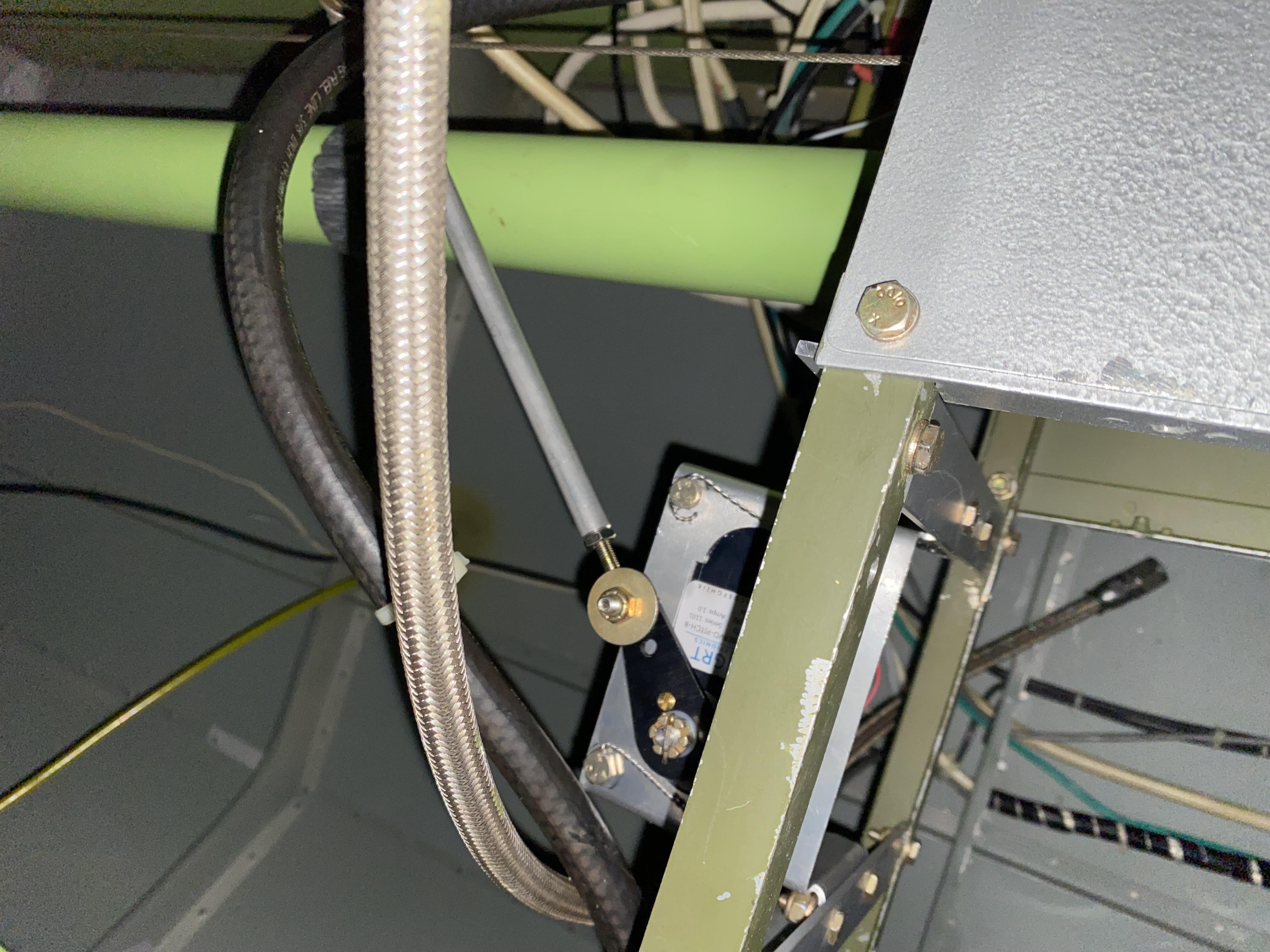

PostPosted: Thu Jan 20, 2022 9:35 pm
I took this pic for something else but it shows how I mounted my MGL avionics servo. That is a smoke oil pump beside it.
