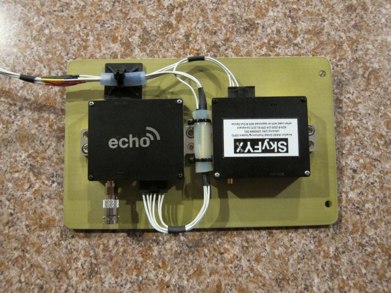

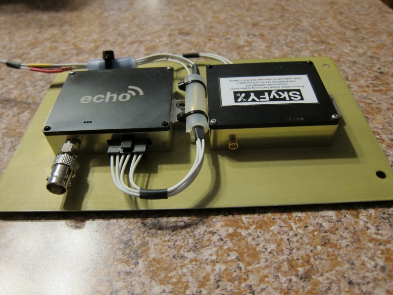

The uAvionix units are what I'm using on my new project. Amazingly compact, light & powerful for such tiny boxes. The ECHO UAT transceiver is dual freq. in and a full 20 watt transmitter (out). It has built-in wi-fi (the antenna is built into the box) to send weather & traffic data to my iPad & my iFly 740, as well as providing a link to an Apple or Android app for set-up, updates, etc. If you have a glass panel, it plays well with most of them I believe. It receives & processes data directly from your transponder transmission signal - no antenna cable clamp-on device needed. If you have a newer transponder with an RS232 output (like a Garmin GTX 327), you can wire it directly to that instead. These guys have been into the UAV/UAS market for awhile, where everything has to be as small, lightweight & powerful as possible. It seems like a very well-run company (they also build some of this equipment for Dynon). Since I didn't have a WAAS certified GPS source, I went with their SkyFX GPS unit which is in exactly the same size package as the ECHO. It comes with a small GPS antenna that I am mounting under the fiberglass glare shield. The ECHO comes with wiring harnesses & the UAT antenna. Those 2 antennas are all that is needed - the ECHO unit broadcasts & receives everything through that one UAT antenna. I bought the 2 units together for a $100 savings at $1399.

 Post subject: Re: ADSb
PostPosted: Tue Jun 13, 2017 11:07 pm
I like it ! Nice set up John . ;) Looks like I'll be busy next April during the annual . :P

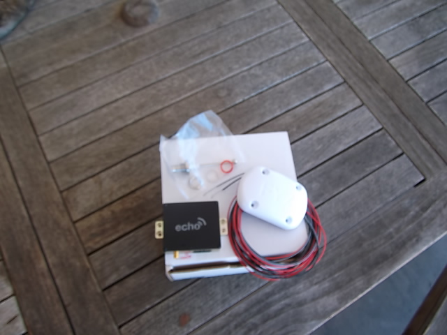

PostPosted: Mon Jul 03, 2017 5:27 pm
Went ahead and got the UAvionix ADS-B unit . Decided on the Echo UAT/SKYFYX-EXT unit . The SKYFYX part of the set up has the GPS receiver/antenna in one unit and only requires tapping into the Echo +/- power leads along with attaching the gray data wire to the Echo wire harness . Comes with attaching hardware . The 978 antenna needs to be mounted and you supply the coax from the antenna to the Echo unit . Attach the power/grd to the Echo unit via a 1 amp CB , program your GPS (iFLY in my case) to accept the data and UR in business . Incredibly light weight ! ??? I hate waiting until the last minute only to find this and other more expensive ADS-B units are on back order ! :o
