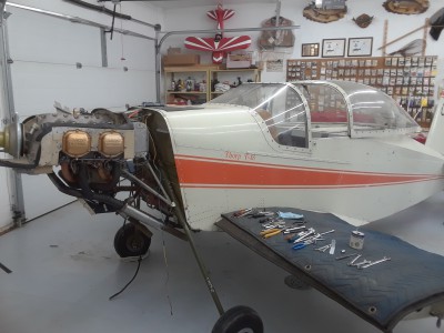

Came into possession of a ground looped T18 last summer, bought it with a partner from the original builder. Bert is getting to his mid eighty's and decided it was too much for him to fix up.
The plane was completed in 1983 and has about 1500 hrs on it so there is a fare bit of freshening up and up dates to be done. The ground loop damage was easy to fix, new gear and a few other parts from Cubes set that right. New wheels and brakes got rid of the original oversized ones and will allow for wheel pants to be added. The O290 has been rebuilt with O320 heads and we have been promised an extra 10 HP on the O290 Deluxe!
Some decisions on what to replace in the panel but the vacuum instruments and venture tube will be gone for sure.
Hope to see some T18s at Airventure this year and talk to you about your planes, ours won't be in the air by then so will be driving down.

Fixing up the baffles and installing new seals now.
When test fitting the cowling found the engine is slightly further right at the front now with the new landing gear installed. Checked the engine is square to the engine mount ring and can see no mounting errors so must be a small difference in the new Gear from the original. Added a few washers on the right side engine mounts to bring it back to original position and alignment with the cowling.

Getting close to finishing the project and putting the cowling back in place. Somehow the cowling is a bit off center to the engine now. Not really an option to change the cowling without totally rebuilding it. Any thoughts on having the engine not at the full 3 degrees.
Really a mystery why everything doesn't lineup the way it did before the new landing gear install and engine rebuild. The engine mount bolted right onto the new gear with hardly any problem.
Maybe the original builders memories of the spinner being perfectly centered are a bit off.

So, are you saying the engine is now centered on the plane and the cowling indicates it (the engine) should be more offset right? I wouldn’t worry about that. It may require some rudder trim to fly hands (and feet) off. How about vertically? Is it ok that way? Will the spinner backplate wear on the cowl at all? Confirm the crank flange does not touch anything.

Cowling indicates less offset needed. Had to add a few washers to the right side engine mounts to get clearance, have about 1 1/2 degrees right offset now. Vertical is good no interference and good clearance all around the spinner backplate.
Can live with a little added rudder if that's the only down side.
