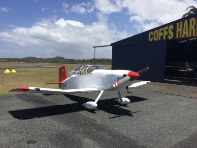

PostPosted: Fri May 17, 2019 6:18 am
Joined: Tue Jan 26, 2016 3:06 am
Posts: 3
Im running a 72FM8S9-1 (86) with rans 2 1/4 spacer on my T18 and I'm happy with performance.

PostPosted: Fri May 17, 2019 6:22 am
Posts: 1133
Thank you for letting me know! I really want a CS prop, but if I can find a used metal Sensenich FP prop at a reasonable price, I may do that. Beautiful airplane by the way.
