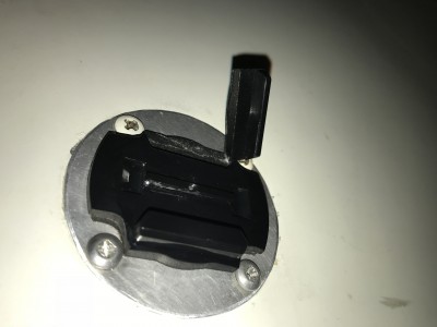

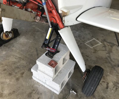

2. Jack. I found that I prefer to jack the plane where the A-frame attaches to the lower firewall. I felt that I didn't have a good, safe jack location down at the wheel. I found a scissor jack that came with an old Jeep with a V-notch at the lifting pad that fits the gear perfectly. I still use a couple layers of rubber padding so I don't mar or scratch the metal. The advantage for me is that it keeps the entire lower gear/axle/brake assembly unobstructed while working.
5. I put a G-meter in my plane with a hole punch. I think it's the way to go. Super-easy even if the panel is installed, and no shavings flying around.
6. Camera Mount. My belly mount broke on my first flight. It was one of the plastic mounts that had an adhesive pad. One of the two side flanges broke. Lost the camera, of course, but it was one of the cheapo units from CrazedPilot.com and not a GoPro. $99 I think.
File comment: Jacking method
File comment: Broken belly camera Mount
