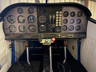

I'm a new Thorp guy, as of last summer. I was a Bonanza guy for many years. Man, nothing flies better than a Bonanza. Then I flew the Thorp! Now I'm a Thorp guy!

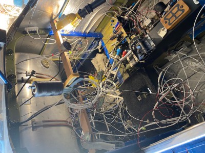

After just a few flights with this airplane, I began to investigate some issues- both electrical (intermittent or inop radios, etc) and mechanical (fuel leaks, et al.) So in late November, I began to repair and or replace things. I didn't plan on replacing the whole instrument panel. It's easy to get carried away...
There's a long list of what's new, changed, or repaired. And its still in the final stages, but I expect to fly this weekend. We'll see.
File comment: Old panel- built in 1978

I found a lot of great information on this website, and also the Van's site. I love it when people share their experiences...! Thank you!!
I'll report back after flying it...
Peter
