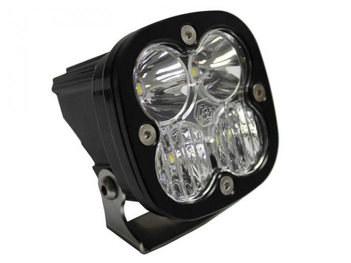

I am thinking about mounting my landing lights to the inlet ramps of my cowl baffles. I am thinking about installing them so that the face of the light will lay flush with the baffle inlet ramp during cruise flight. I will build a hinge so that I can rotate them from a flush position to a forward facing position so they will shine out onto the runway during landing. I hope that makes sense. Anyway, my question is about how much force would be required to rotate the light into the "up" or forward facing position, which of course would be into the wind. Could a simple push pull cable do the job? Could a Ray Allen servo arm actuator be strong enough? Here is a photo of my landing light. The frontal area of the light is about 6 square inches. I just don't know the formula to use to calculate the force on the face of the light. If I knew the force acting on the light at say 150mph, I could do some tests in the garage on the push/pull cables and servo actuator.

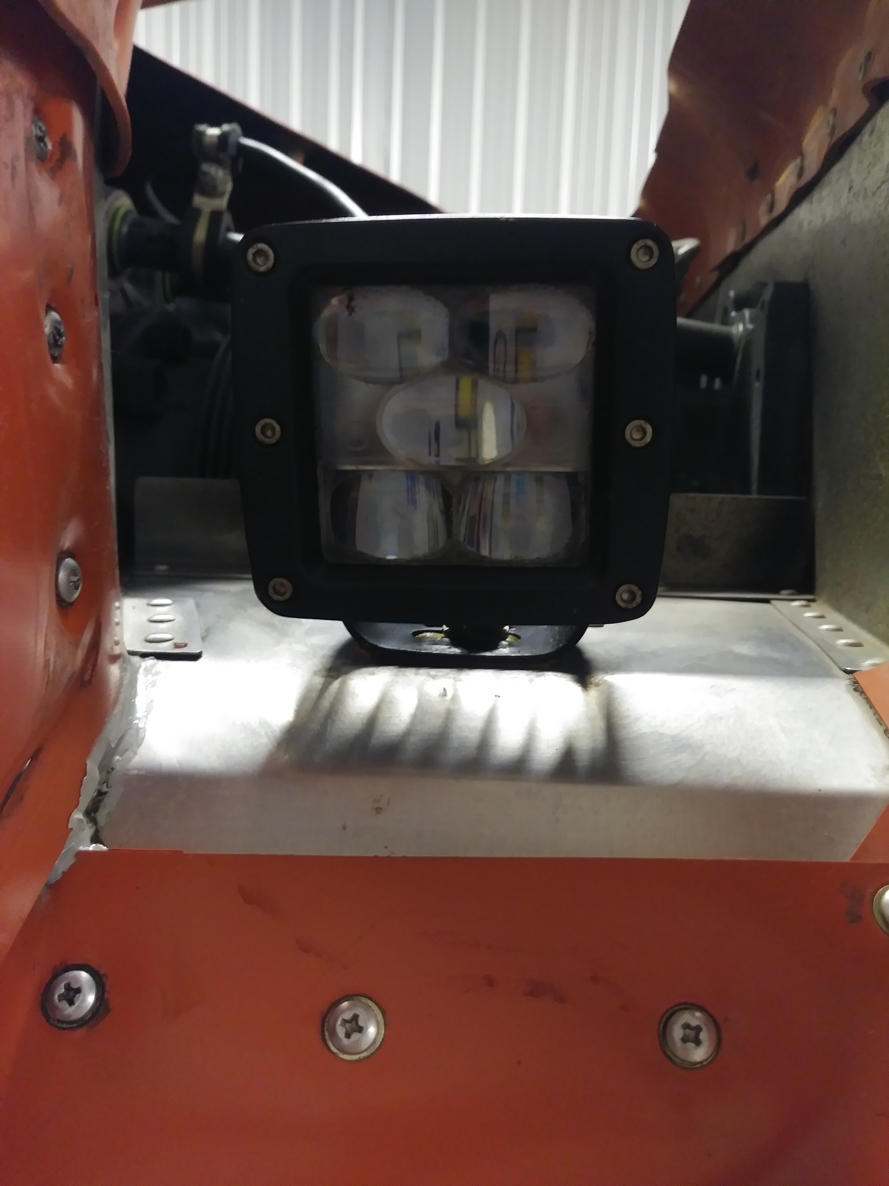

PostPosted: Sat May 18, 2019 6:37 pm
Here are a couple of pics of my installation.....and Naught from Naught = Naught means Rich is now a "Triple Naught" spy!!
