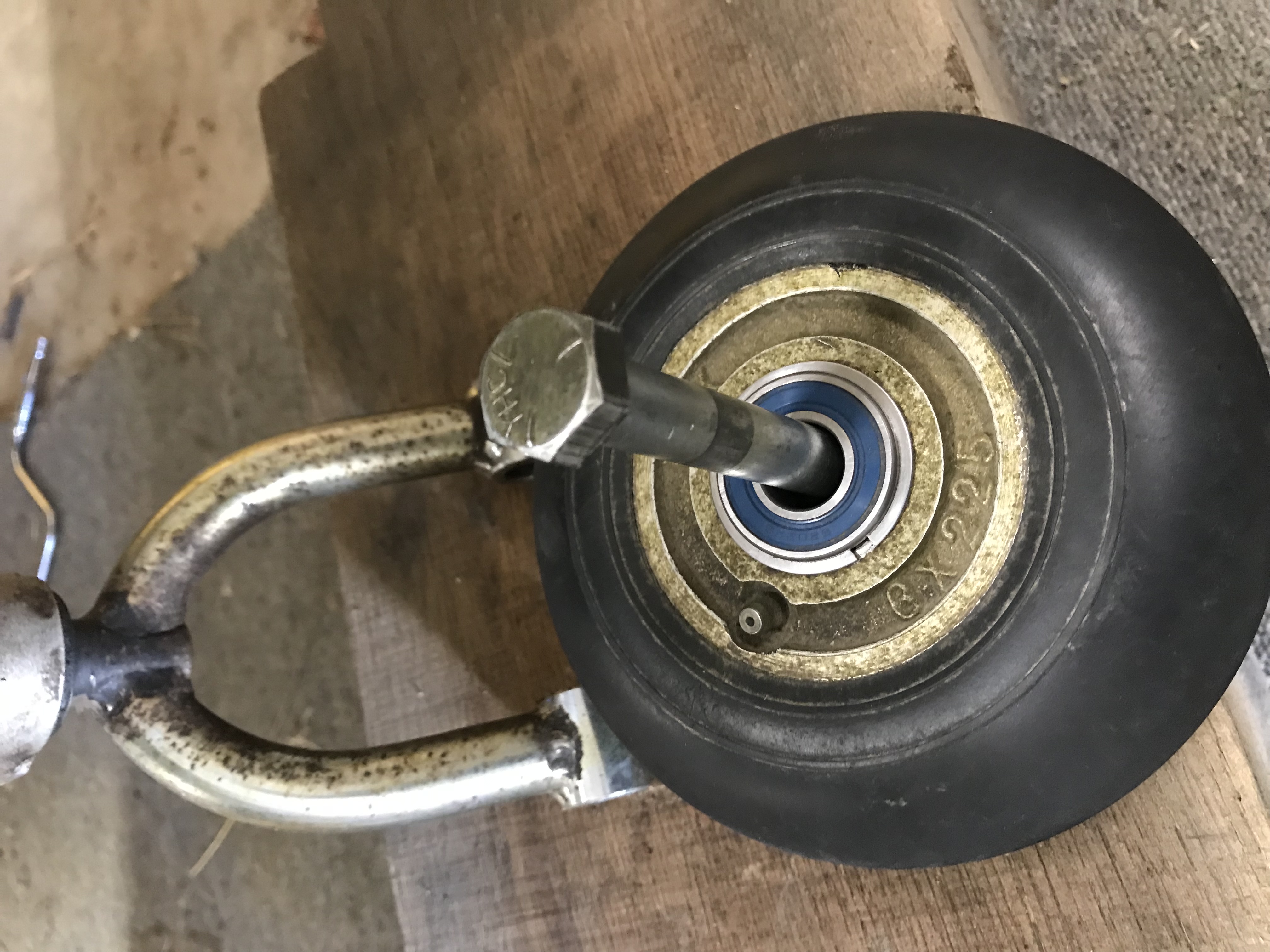

I hit a little snag with my Homebuilders tailwheel assembly today during the condition inspection. The bearings were bad so I elected to replace them with the advertised replacements that came with the airplane. Unfortunately, I didn’t catch the fact they are not the same inside diameter until after I had pressed them into the wheel. I checked my collection of emt and 4130 but I don’t have what I need to make a bushing. The only choices I see is to figure out the correct bearing (I don’t have a local bearing store and the numbers on the old bearing are not legible), order some steel to make a bushing or retrofit a cone bearing. Since I am on hold for parts anyway and I know others are using the same wheel, I thought I would ask and see what they had done to correct the issue.

I learned today that Aircraft Spruce does not currently stock replacement parts for the Homebuilders Heavy Duty Double Fork tailwheel assembly. No wheels, no bearings. The bearings they sell for Homebuilders line can be used in conjunction with a spacer but they are not a direct replacement. They seem to carry wheels for every other model.

If you search for 6138 on tha Aircraft Spruce site the wheel will come up but there is no link to follow. Just the option to add it to the cart (currently no stock). The good folks at Spruce were unaware there are 2 different axle sizes so they may decide to add replacement bearings specifically for the dual fork models or a spacer to use what they already offer. At a minimum I believe they will update the bearing description to inform people of the bearing size and/or intended use (single fork models).
R&K Industrial Wheels has almost no internet presence. Their own website doesn’t show this wheel in their product line. I don’t have convenient access to an industrial supply store so I have to rely on outfits like Grainger, Zoro, Amazon and the like. They have zero presence anywhere I have looked which makes me question how “common” R&K is. Could they just be regional?
Bearings are sold everywhere but you have to know the specs. I do not know what makes one flanged bearing “heavy duty” versus regular. I have yet to find any advertised as “heavy duty”. 120 pounds is the max load rating I have found and I believe that matches the stock bearings.
