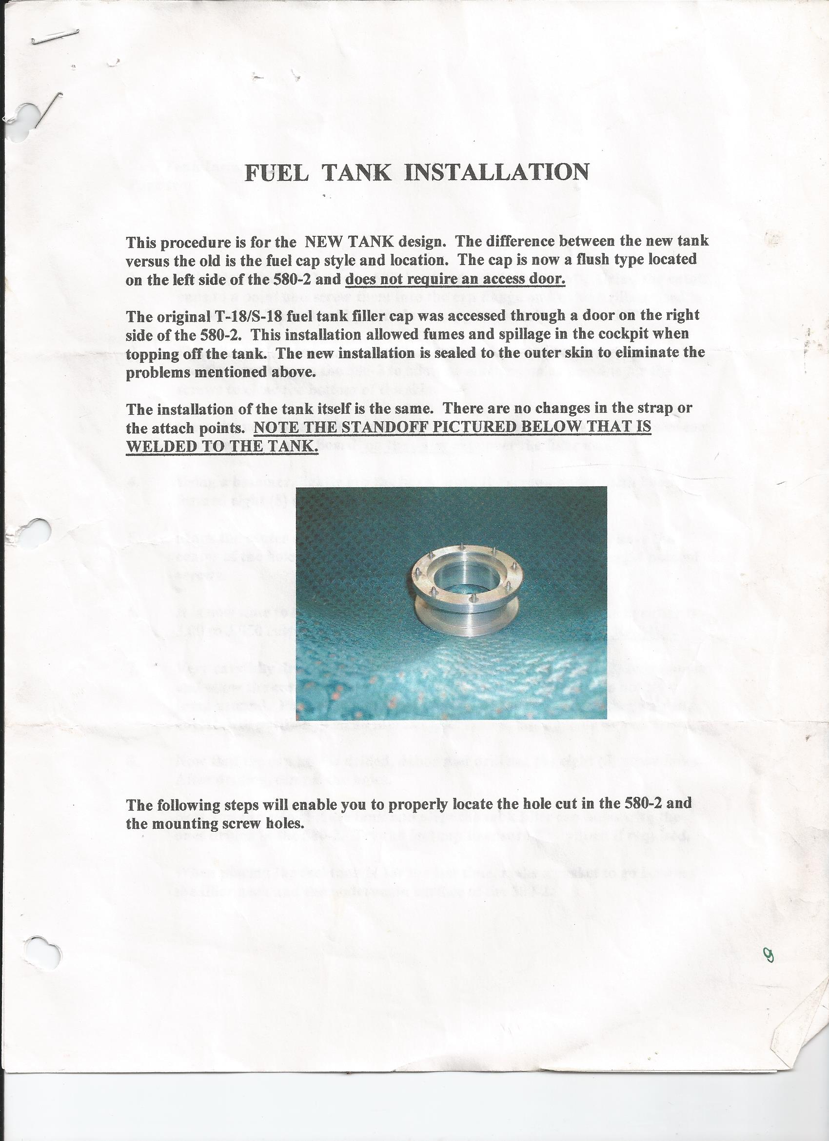

 Post subject: Re: Fuel cap question
PostPosted: Sun Apr 03, 2016 11:02 am
My fuel tank came from Classic Sport Aircraft (CSA) and attached is a copy of part of the installation instructions and a pic of the "extension and flange" that is welded to the top of the tank . It was a VERY tight fit and the hole location for the CS attachment screws came from the modified machine screws ( ground down to a point) . The tank was placed in the cradle and the "screws" left a small dimple for hole location . A gasket was placed between the flange and the bottom of the skin . I am very happy with this set up . No fumes and a final visual check on the cap prior to take off . ;)

Thanks, that clears it up. Is anyone still making this sort of "extension and flange" component?

Yes, those are very nice, they are standard Newton caps from England used on sports and race cars and motorcycles and there are even more sizes and styles at http://www.newton-equipment.com. Still, I don't see any way to put the flush cap in the fuselage decking without using a custom part like the one Classic Sport Aircraft (CSA) used to make except putting a separate flange in the decking and a filler neck on the tank and bridging between the two with fuel hose. That would work but would require much more space between the tank and decking than the custom solution. If Cubes does not decide to offer the part, I suppose it would be possible to weld a bolt circle on an existing cap flange to fake it, but you'd need someone comfortable with that king of aluminum welding.
