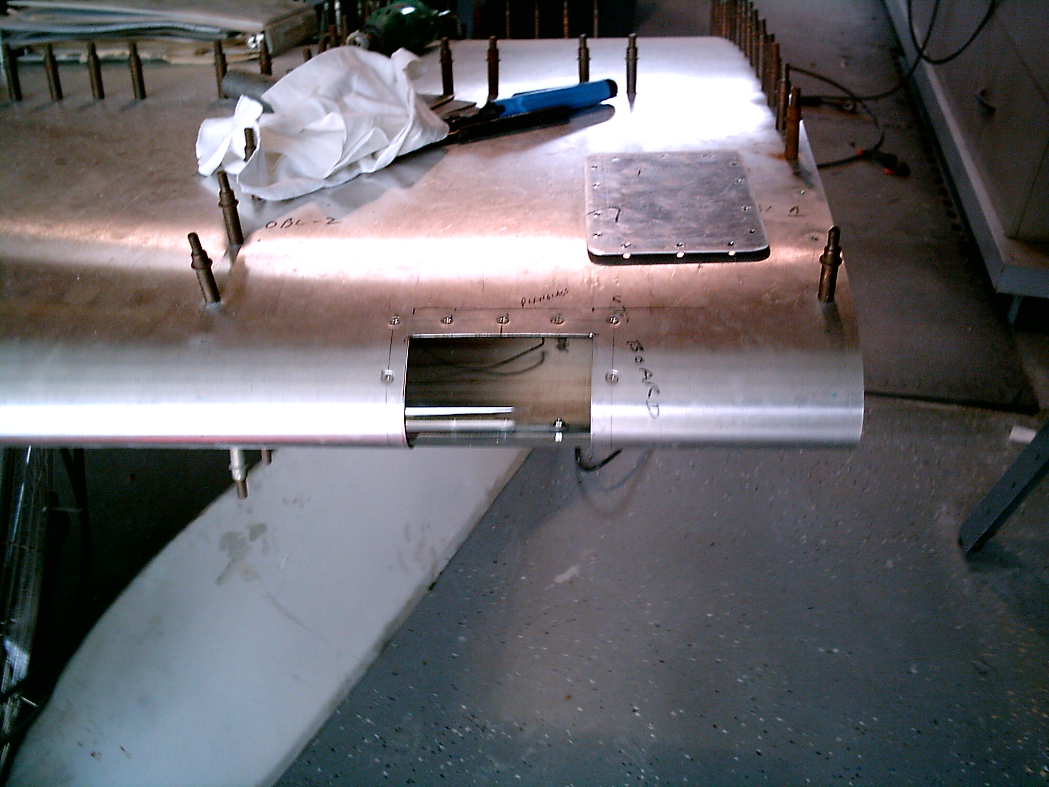

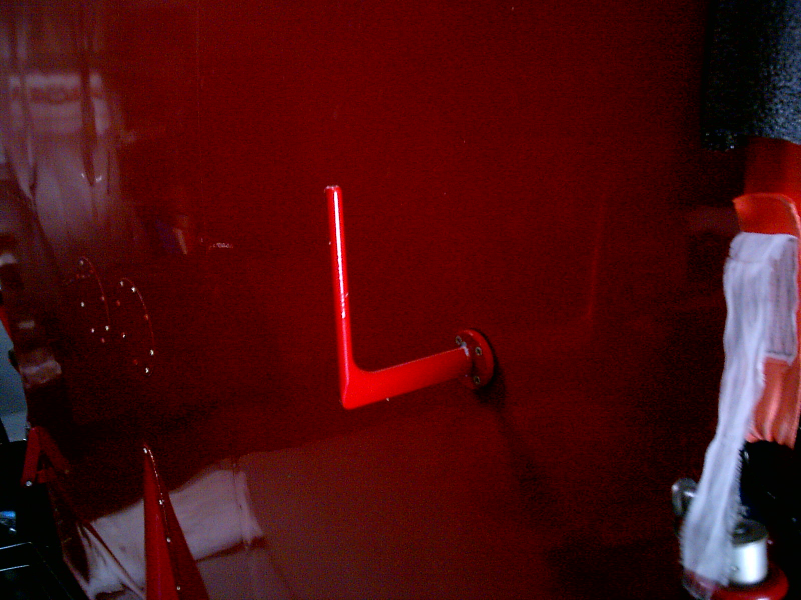

I used the "L" shaped tube from Vans . It came with the mounting flange and I think at the time it was around $10.00 ? I placed the tube in the same bay as the LED landing lite and installed an access cover on the last rib . I did improve on the appearance of the tube by installing some model aircraft streamline tubing over the pitot tube . Nothing magical about the pitot tube . Just a 1/4" piece of alum. tube with a 90 in it .
