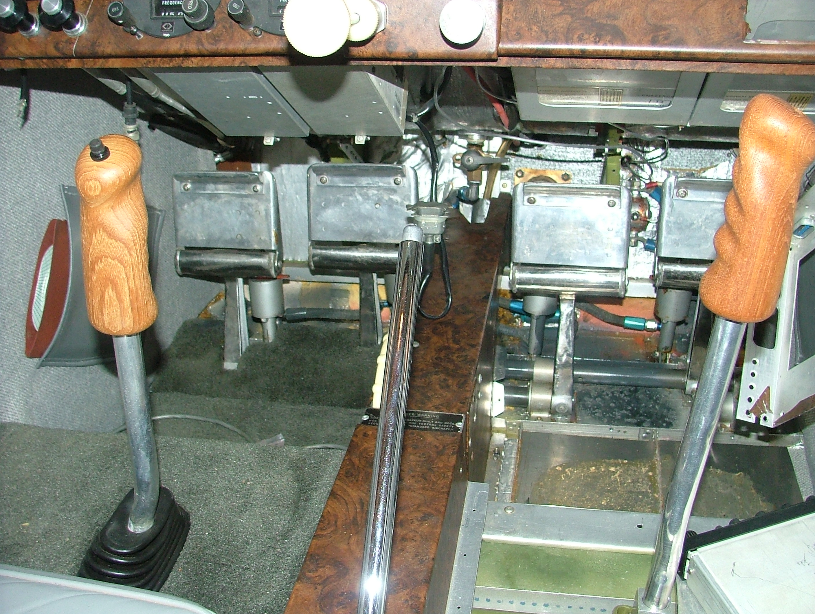

I was flying along the other day and readjusted my manual trim. After I took my hand off the trim wheel, I noticed that it continued to move by itself. It moved maybe a half an inch to one inch (along the circumference of the trim wheel). There is no slop or free play in the trim system, it just continues to move to another trim location after I set it where I want it. Its not a significant amount, but I fear it could become worse.
I have to admit, I don't know how to fix this. Can anyone describe what I should do? Below is a picture of my trim wheel.

PostPosted: Sun Jul 06, 2014 9:15 am
I would have to know more about how the system is built to make a guess. Is it possible to tighten the axial bolt on the trim wheel. If you have built the rear per plans, it should not do that.

PostPosted: Sun Jul 06, 2014 10:16 am
Sounds like the flex shaft in the back is "springing". This could be due to the trim screw needing lube. If you have never had the tail apart, now is the time to do it. You might be surprised at what you find back there.

PostPosted: Sun Jul 06, 2014 10:44 am
Joined: Fri Oct 23, 2009 12:28 pm
Posts: 36
Is the aircraft trim really changing with the movement of your trim wheel? Is your trim wheel securely fastened and just vibrating loose? Mine wobbles a bit and I can see the trim wheel possibly coming free from the manual trim system.
PostPosted: Sun Jul 06, 2014 11:52 am
Posts: 1170
I have taken the tail off in the past, and I didn't see anything out of the ordinary. I will take the tail off again before next flight and inspect/lube the jackscrew. I believe the trim is really changing with the movement of the trim wheel. There is no wobble, or looseness on the trim system.
Once any repairs are made, it may be hard do determine if I have fixed the issue without a test flight. Would you agree with that? I can not think of a way to test the trim without flight loads.

PostPosted: Sun Jul 06, 2014 6:32 pm
Posts: 1170
I went out to the plane this afternoon and took the tail off. All good back there I lubed the jackscrew for good measure. I then moved to the control wheel. I saw an inspection panel on the right side (pax side) of the trim wheel cover. that looked like a good place to start. I removed the cover and saw a nut with safety wire. I cut the safety wire and tightened the nut about a quarter turn. The trim wheel now rotates only when I move it and with a bit more friction than before. I guess after 34 years, the nut needed a quarter turn.
I appreciate all the quick responses. I will of course approach the next flight as a test flight.
