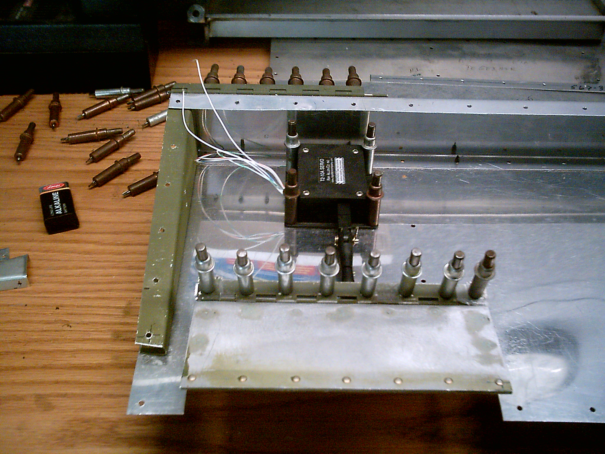

Terry,
Do you have any photos of your aileron trim tab actuator installation that you could share? I'm going to reskin my ailerons and thinking about a trim tab installation at that time.
Thanks,
 Post subject: Re: N218TH flying
PostPosted: Sun Jan 26, 2020 1:20 pm
I use a Ray Allen actuator buried in the aileron. The tab itself is about the size of a dollar bill , or in Rich's case, a one hundred dollar bill.
PostPosted: Sun Jan 26, 2020 2:44 pm
A hundred dollar bill doesn't buy what it use to so I glued together (2) $100.00 bills ! ;) I could only find (1) pic of the install . I put the tab on the outboard side of the left aileron . I also cut out the bottom of the aileron and mounted the servo to a cover plate to make removal repair possible . Also the linkage is buried inside the aileron , nothing exposed outside the skin . Almost 10 years of trouble free flying with the servo . :P
PostPosted: Mon Jan 27, 2020 6:20 am
Very similar to my setup. The importance of the left verses the right is you can see it to set it from the driver's seat.
