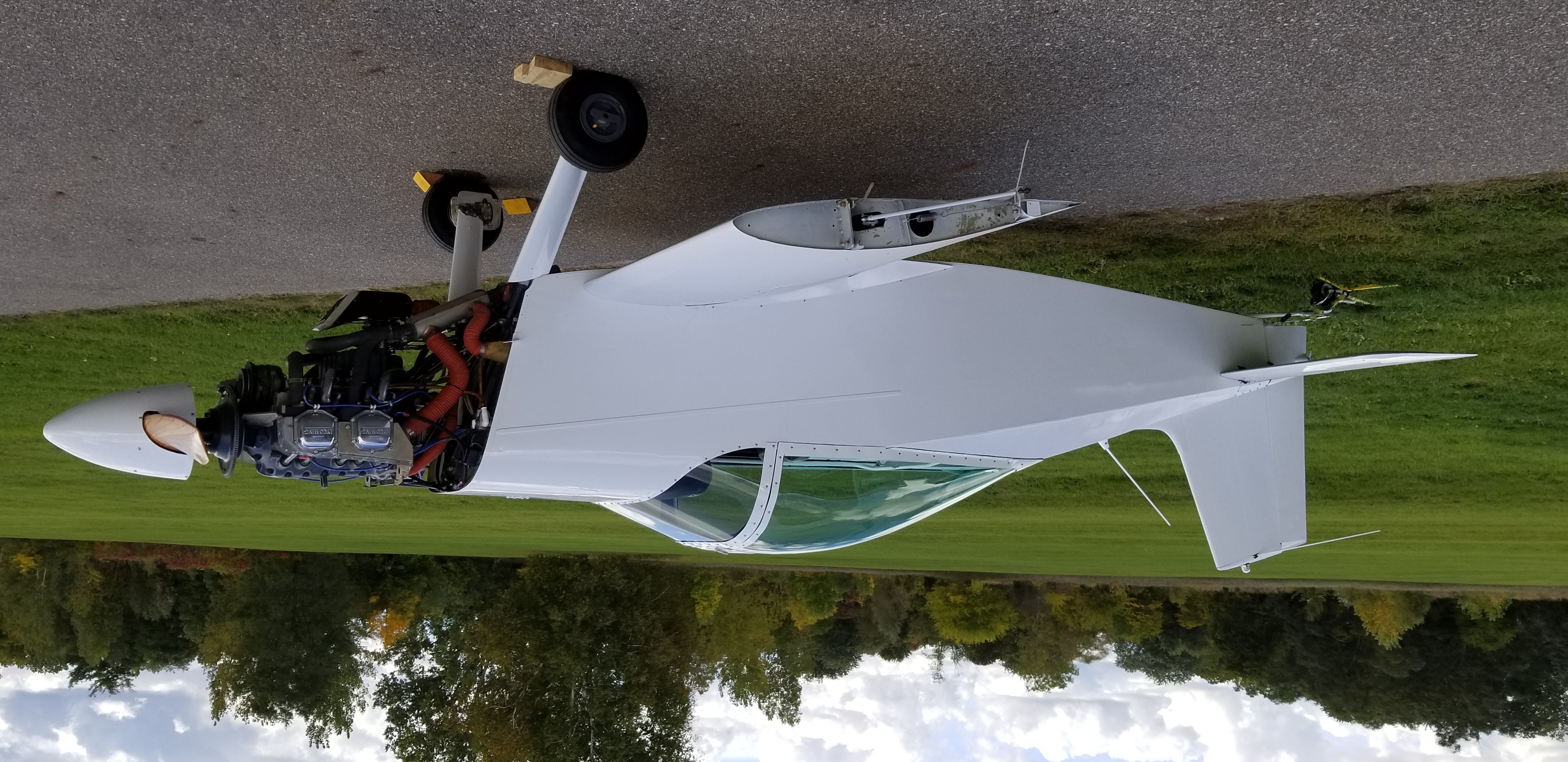

PostPosted: Thu Mar 04, 2021 2:12 pm
Thanks for the info Bob,
I am assuming you are referring to this correct? Just use a carpenter's level then?
Thank you!
PostPosted: Thu Mar 04, 2021 3:08 pm
Yes. Tail will be quite high when level.

PostPosted: Sat Mar 06, 2021 2:45 pm
Just so you are on the same page, WL42 is the 5/8” by 1/8” strip of aluminum that is riveted to the outside skin of your bird that runs from the firewall back to the cockpit area as Bob described a couple of inches below the canopy rail.
I use a digital level like you can buy at any local hardware store.
As Bob also said, the tail will be quite high. Because it is so high, you are much closer to it tipping on its nose. Please be careful and always have control of the tail.
