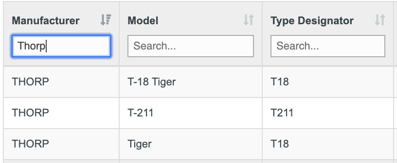

Just discovered this handy FAA website:
https://www.icao.int/publications/DOC86 ... earch.aspx
Type Thorp in Manufacturer. The choices are:
T-18

 Post subject: Re: ATC Flight Plan
PostPosted: Thu Apr 09, 2020 10:20 am
Yes ... but once again so that we're all clear .. the designator is "T18"
