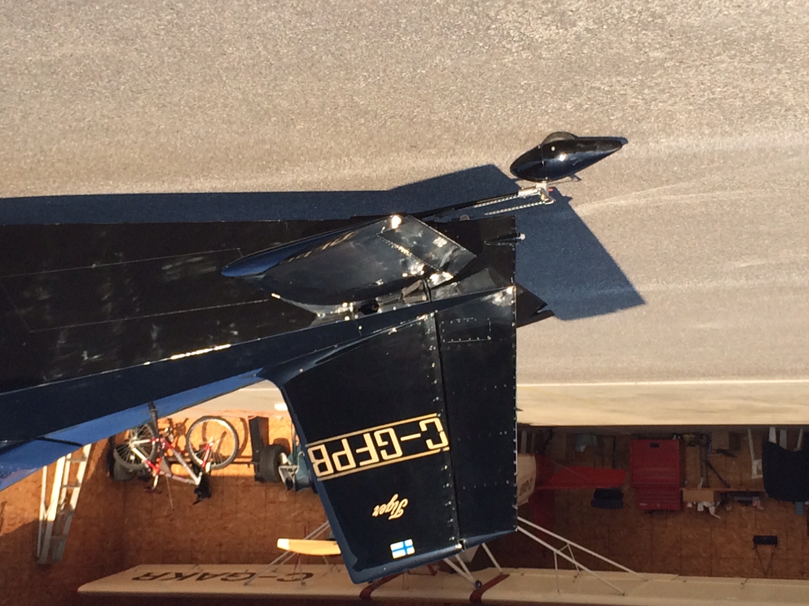

Jim, how about a pic of the VGs on the vert stab? I'm interested
PostPosted: Wed Apr 27, 2016 10:47 am
Here is a picture of the VG's. They are from a company in Australia.
I hope this posting of the picture works.
PostPosted: Wed Apr 27, 2016 10:48 am
Darn,
It might look right for the guys in Austalia or you can flip your screen to see the right orientation.
