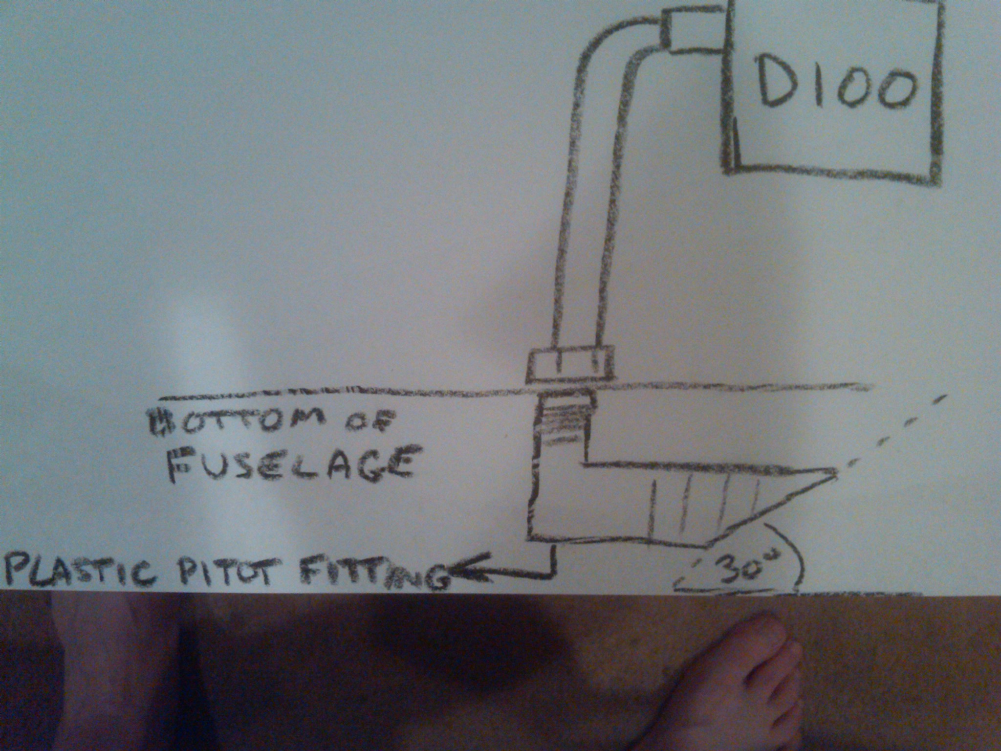

OK, I have to say that I already had a Dynon D100 installed in my panel, but I had never utilized the AOA portion of the display because I thought I had to have to dynon pitot/AOA boom, which costs about $500 for the heated version. I saw on VAF some guys were using the Dynon AOA display through a pop rivet on the wing. So I thought I would give it a go for myself.
So, I found a plastic 90* pitot/static fitting (with a barbed end) sitting around, and connected it to some 1/4' tubing I bought from home depot for $2.13 (for 20 feet of it!). I then put the barbed end of the pitot fitting on my grinder and shaved the barbed end to where it had an angle of about 30 degrees. I had an existing hole cut in the underside of my fuse where an old stall horn blade lived, but I removed. I slipped the barbed pitot fitting through this hole, and secured it so it wouldn't move while flying. It worked perfectly on the first flight today (after one calibration run).

This is all there is to it......toes not included!. I had a plastic 90 degree pitot fitting that was barbed on one end and had threads on the other. I mounted under the fuse and connected the tubing to my D100. That simple and it works.

Good for you Ryan . Glad it fills that space on the EFIS . ;) Looks like you could use a little Fungi Nail on those toes ! :P You could sell that fitting for $50.00 ! ::)
