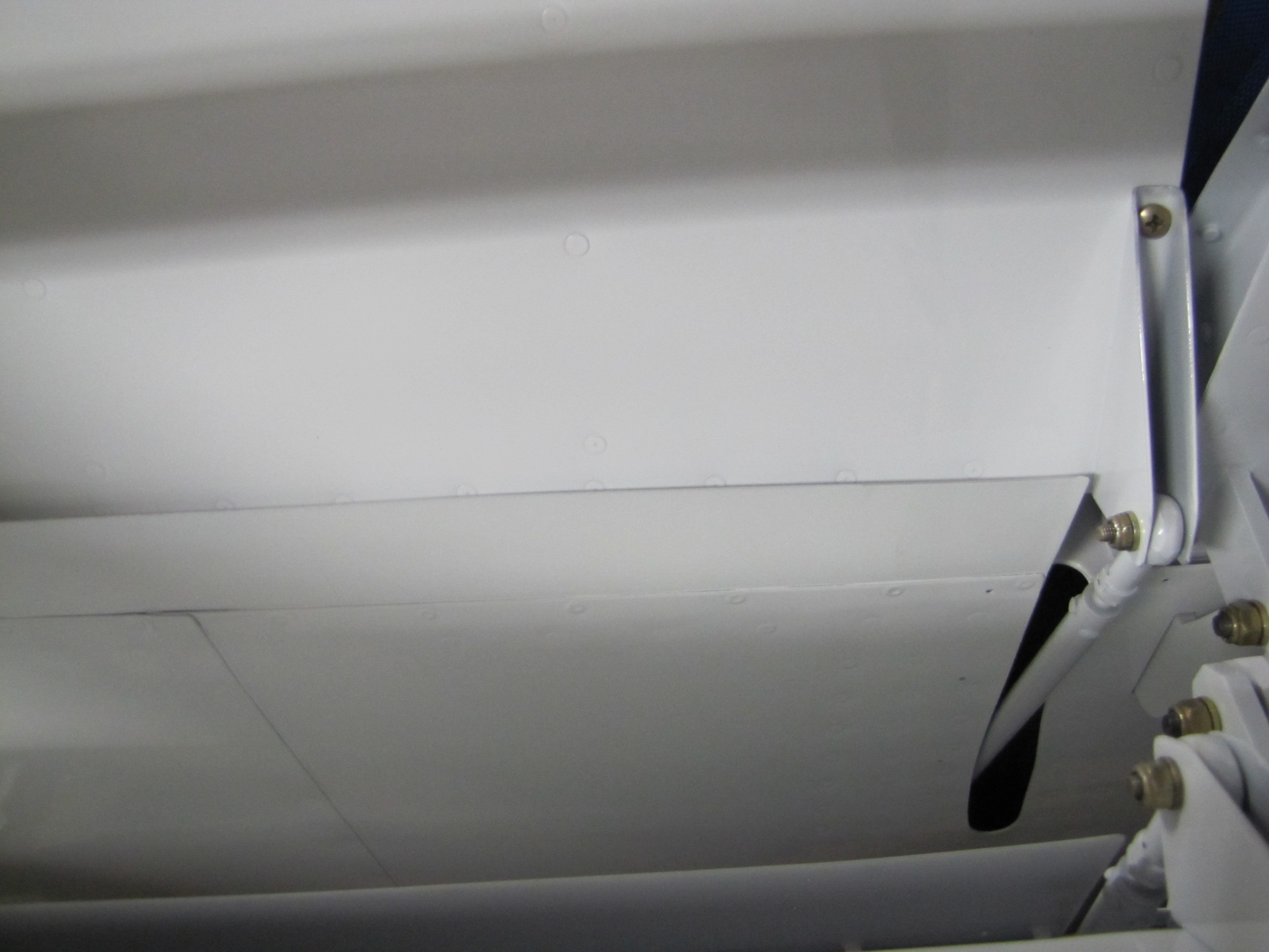

I was reading an old post (I believe its out of an old SA article?) that says "....The use of lower aileron gap covers adds about 3 mph ...."
I don't know what aileron gap covers are or what they look like on a Thorp. Can anyone post a picture of their aileron gap covers? I wouldn't mind having another 3 mph.
PostPosted: Tue Nov 05, 2013 1:50 pm
Not sure if this matches the article but it's what's installed on my aircraft.
Basicly it is a piece of aluminum that runs the full span of the aileron and is fastened under the bottom skin and protrudes about 2". It seals to the bottom of the aileron when in the neutral position.

PostPosted: Tue Nov 05, 2013 3:50 pm
I do not have gap seals. I taped my hinge line once and detected no difference in speed or roll rate.

PostPosted: Tue Nov 05, 2013 6:35 pm
Joined: Wed Dec 07, 2011 10:18 am
Posts: 22
Location: MN USA
I too taped my aileron gaps and noticed very little difference in airspeed. I did notice a difference in roll trim. Rate may have been slightly higher. While I was at it I also completely taped the flap gaps top and bottom. There might have been a ever so slight change in speed between the two, but not really worth losing use of flaps. I should note that speed checks were basically indicated airspeed at same altitude before and after the taping process. Landing without flaps not really a big deal, but certainly makes the process easier and with a steeper angle and lower speed.

A little off subject, but I made brake caliper covers for the Thorp after talking to a fellow Thorp driver that claimed it gave him 6 to 8 kts. I flew a course with and without the cuffs and using my imagination see 1 kt. The Thorp if built straight and rigged true will go about as fast as it will go as JT designed it with out any gap seals, etc. I flew over to GIF sunday morning and indicated 184 mph at 24/24 at 2000 asl.
