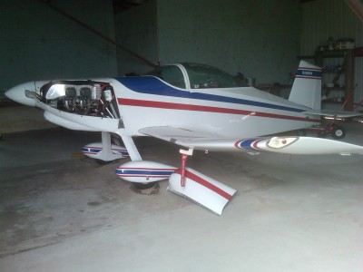

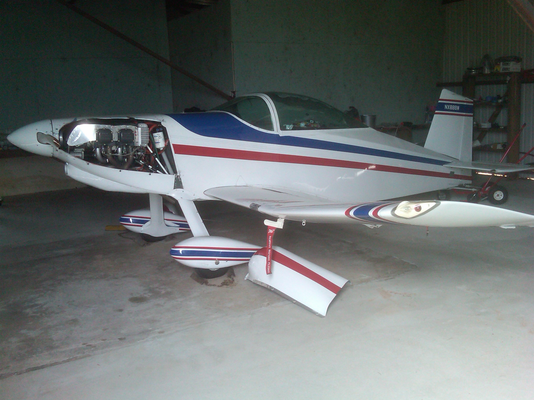

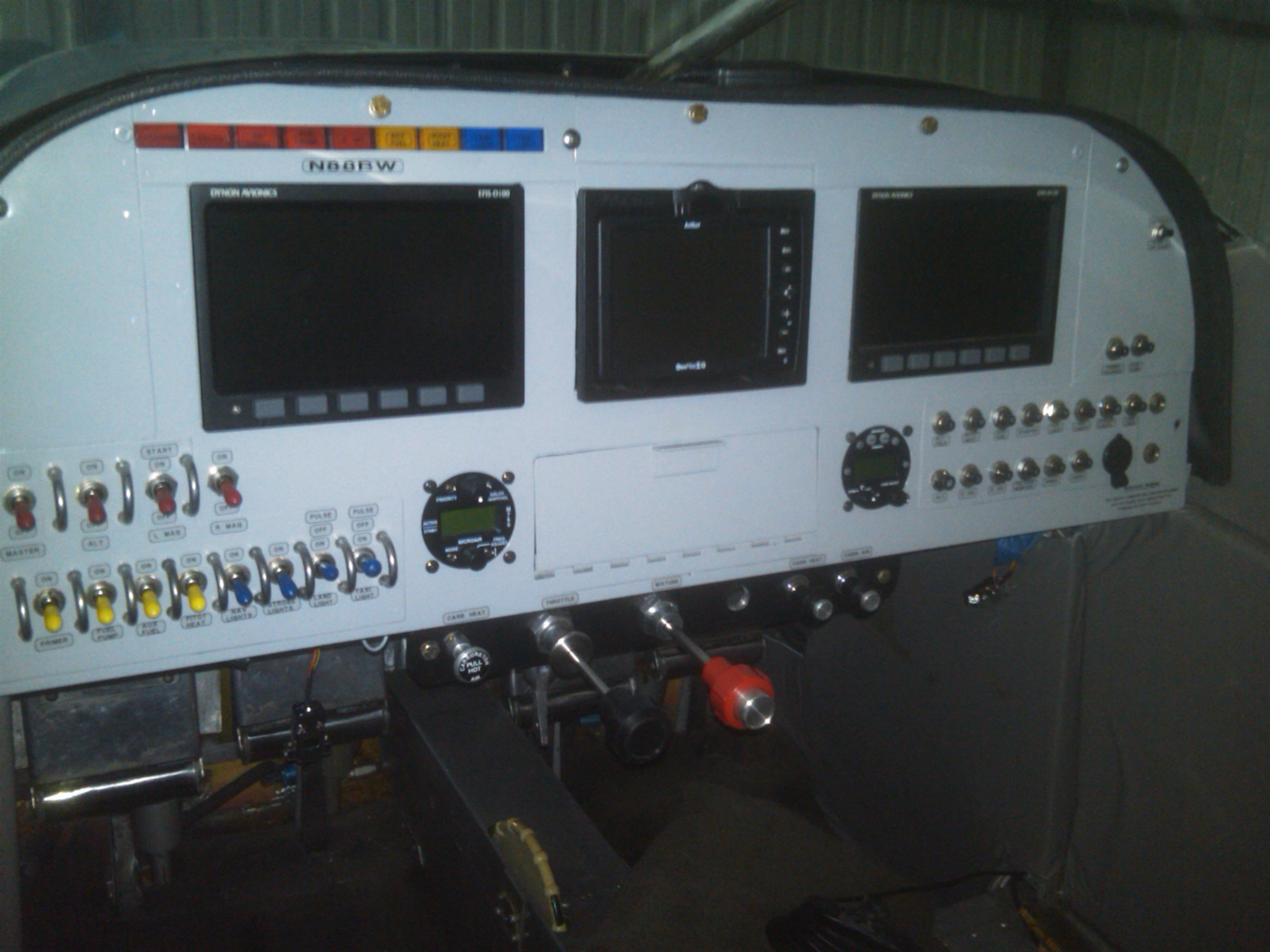

glad to hear that Bill. I am tired of working on my plane for a while. I'm ready to fly more. Heres a couple of pics of new engine (2 year old paint) and a new (2nd one I've done) panel.
