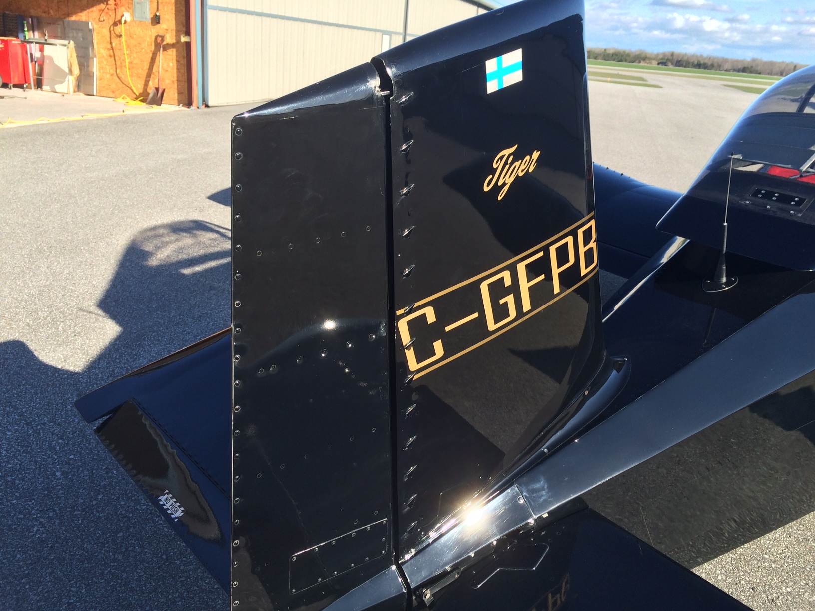

Thanks Jim, it looks like 12 or 13 just ahead of rudder leading edge n if it made a nice difference for u I'll give it a try l know u also have an 0-290 as do I , and I saw your operating hand book n it's right on across the board with my performance.

I have an IO-320-D1A with C/S prop in my plane. The VG's are made by a company called Stolspeed.
http://stolspeed.com
I also have them on the outboard wing sections. It really tamed the stall and it mushes in the stall much like a Stinson now. I didn't notice and drop in speed.

Jim, guess I mixed u up with someone else but that is a nice combo wish I had it. Next time your out at the hanger maybe u could take take a couple of close up of your install, I have some availability for VGs
And would like to try and get a little more authority, right now I limit my crosswind component to 15 knots.

Here are better pictures of the VG's.

Thanks Jim, also your ship looks great. I'm going to try the VG on my tail.

You can buy a bag of Vortex generators on eBay for $60. they're listed under Vortex generators experimental aircraft or I've made them before out of a plastic suspended ceiling 'T' from building supply store. $5
