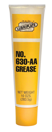

sorry, actually found the lubriplate (630-AA) and dry graphite at O'Reilley's Auto Parts. http://www.oreillyauto.com/site/c/detai ... &ppt=C0139

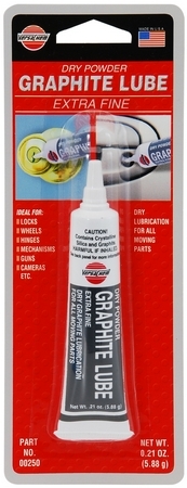

My local Fastenal has the spray dry graphite, but they only sell it by the case, for $112!. So here is the Dry Graphite I found:
http://www.oreillyauto.com/site/c/searc ... y+graphite

Grainger has the graphite in a spray can . Not sure what I paid for it $8.00 ? I believe the plans Lubriplate is in the Silver and Black can that has been around as long as I can remember . I use it . The small can will last you a lifetime ! It comes in two grades . High temp and "regular" . 130-AA and 630-AA . You can use any Aviation grade grease . During my annual I spray PB Blaster onto my pivot points . It displaces water and provides a film on the metal surfaces . 8)

I am not too keen on the dry graphite with aluminum. Look what pencil lead (graphite) does to aluminum - I have seen it used too many times on outboards & the ensuing corrosion -
