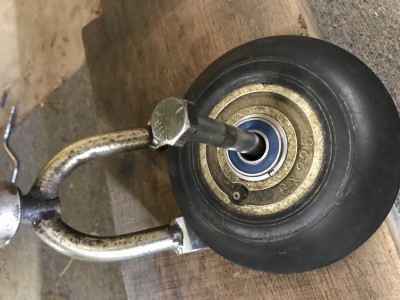

I hit a little snag with my Homebuilders tailwheel assembly today during the condition inspection. The bearings were bad so I elected to replace them with the advertised replacements that came with the airplane. Unfortunately, I didn’t catch the fact they are not the same inside diameter until after I had pressed them into the wheel. I checked my collection of emt and 4130 but I don’t have what I need to make a bushing. The only choices I see is to figure out the correct bearing (I don’t have a local bearing store and the numbers on the old bearing are not legible), order some steel to make a bushing or retrofit a cone bearing. Since I am on hold for parts anyway and I know others are using the same wheel, I thought I would ask and see what they had done to correct the issue.

I went to town this morning to see if NAPA could help and ended up buying a steel nipple at the hardware store to make a spacer. I reamed it to fit the 1/2” bolt and turned it down to fit inside the bearing. When this set fails I favor converting it to cone bearings. The same bearings, races and seals found in a Scott or Alaska Bushwheel would fit. The wheel would need a slight modification to ensure wheel stayed centered on the races. Once converted the zerk fitting would actually serve a purpose and it is likely the bearings would outlast the wheel... maybe several wheels.

I got bushings from the bearing store that go from 5/8 to 1/2. Also made spacer out of tubing to keep the bushings from working in.

I have the Aviation Products, double fork system and I switched from the cast iron wheel to a Matco wheel which is much lighter and has very good quality sealed ball bearings.
PostPosted: Mon Dec 10, 2018 11:27 am
Guys,
I forgot to mention that i have the solid 6" Matco wheel. I tried the pneumatic one and the tire is not very robust.I haven't been able to find anything that fits and is more durable. The part number for the 6" solid tire is: WHLP406-WD. It comes with the bushings to adapt the 5/8" bearing ID to the 1/2" axle bolt.

I learned today that Aircraft Spruce does not currently stock replacement parts for the Homebuilders Heavy Duty Double Fork tailwheel assembly. No wheels, no bearings. The bearings they sell for Homebuilders line can be used in conjunction with a spacer but they are not a direct replacement. They seem to carry wheels for every other model.

If you search for 6138 on tha Aircraft Spruce site the wheel will come up but there is no link to follow. Just the option to add it to the cart (currently no stock). The good folks at Spruce were unaware there are 2 different axle sizes so they may decide to add replacement bearings specifically for the dual fork models or a spacer to use what they already offer. At a minimum I believe they will update the bearing description to inform people of the bearing size and/or intended use (single fork models).
